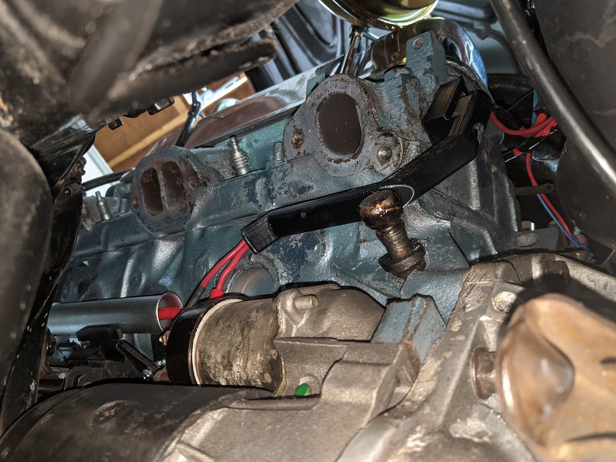

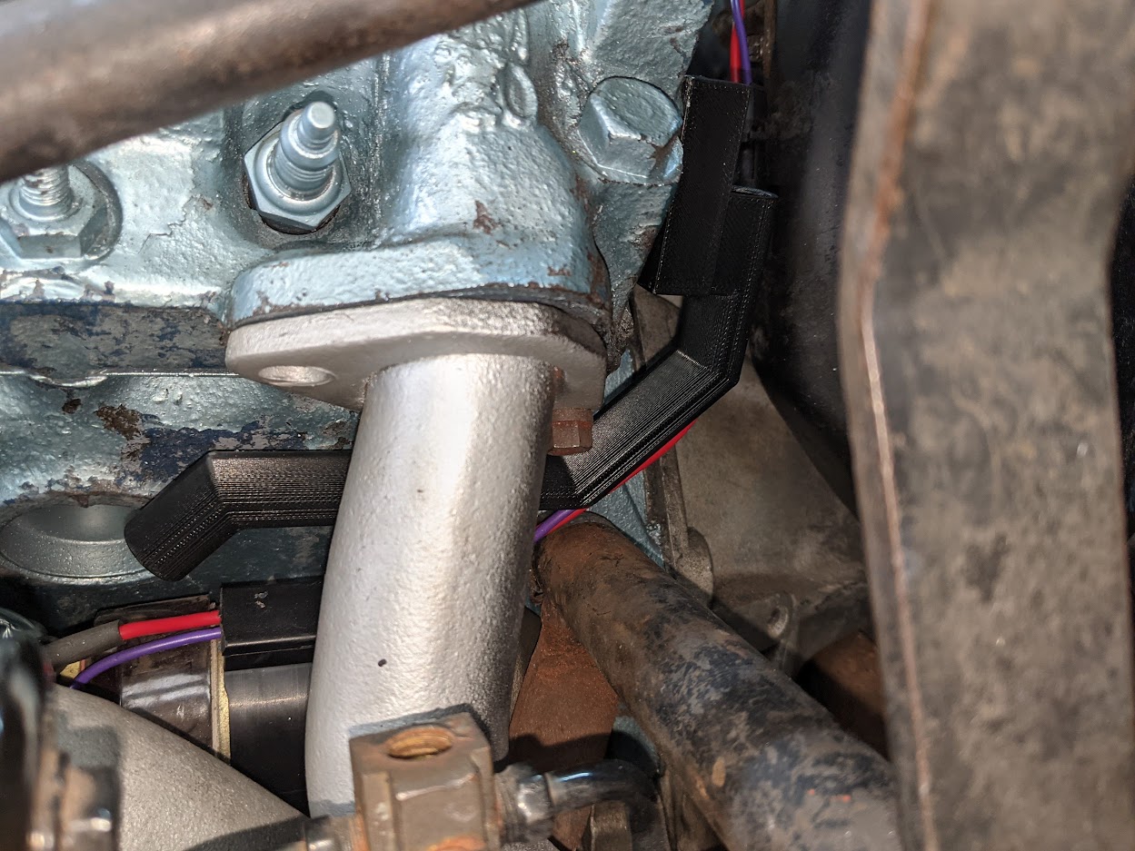

That's a great illustration.
When I put my '66 together, I didn't like the way the factory put the positive battery cable routing up between the exhaust manifold tubes to the inner fender- so I was planning to fabricate a routing tube to do just what that '67 HO tube does.
Then I discovered the factory '67 Tube- and just bought that.
But I didn't like or want to route the starter wires through that same tube- then up & around the front of the motor- so I modeled a custom tube, and 3D-printed it to route those wires up the back of the block.
BTW- that tube is printed in Ultem for any of you folks wondering if a polymer will hold up to the temps.
