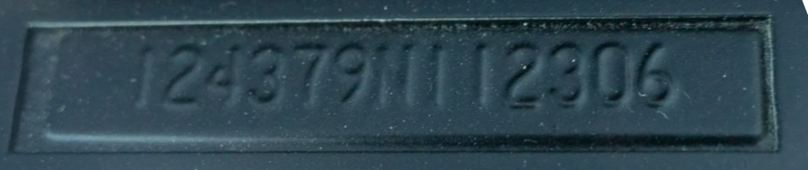

I doubt the state made a perfect fitting VIN tag for a 69 Camaro.
Dash panel has been replaced. Cowl rivets are wrong. Wonder what the hidden VINs say. Buyer beware.
I wonder where the VIN tag came from.. kinda scary
My thoughts exactly, no State issued ID / Vin tag ever looked like an original tag. Bill

The IA issued vin for my '38 street rod is a sticker...
