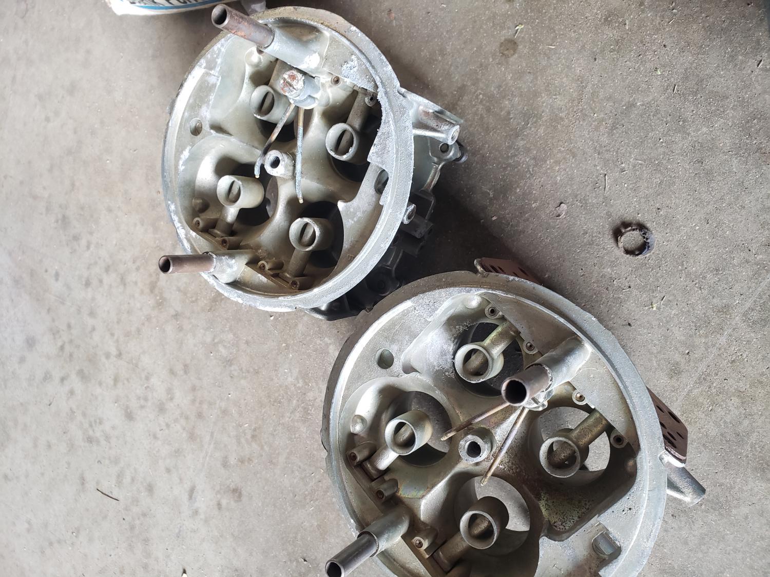

I found these 2 carb bodies with the secondary squirters.
