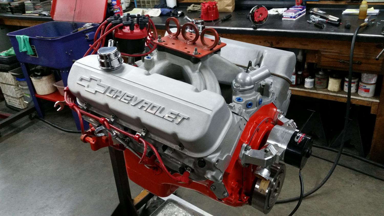

I installed the heads and an intake on the mockup block. It sure looked like the Weiand intake I had would work. I later found out it didn't quite clear the flat hood, but that's another story.
Here's another look. I plumbed the mechanical pump (shown here), but that too has changed.
Using a mockup allowed me to check for valve cover to wiper motor clearance. I also used the mockup to figure out which throttle cable to use. Since the Nova was originally a six, it had a cable instead of a lever (that's the six banger cable shown here). Although I do have a complete lever style mechanical throttle assembly it made more sense to use a cable. IIRC, a Chevelle cable worked.

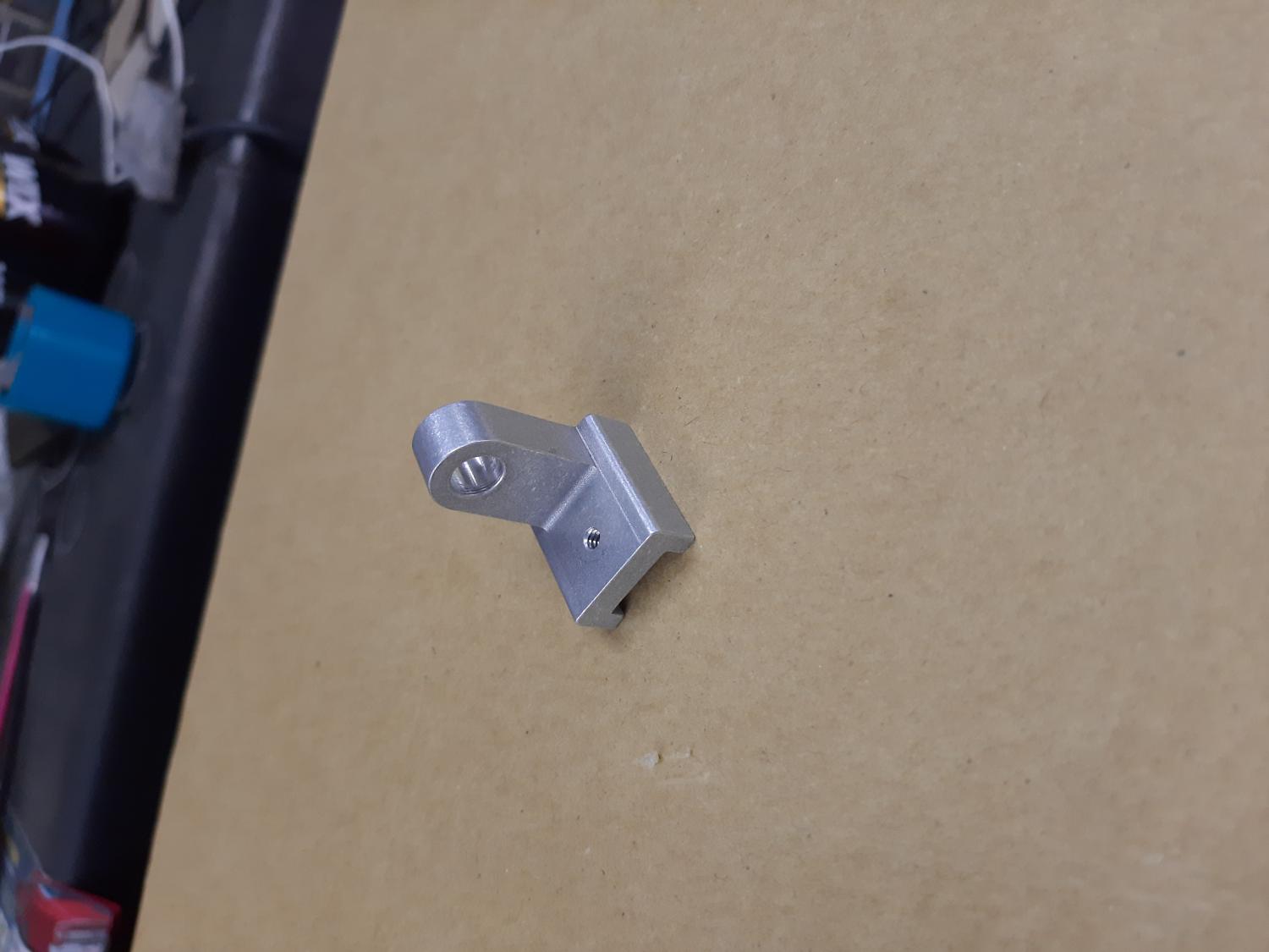

This is the oil filler cap I'm using on the cast valve cover. It's a knurled screw-in job sealed with an o-ring. The valve covers are actually for a marine application.
I don't use a PCV on the engine. Instead, I use two large K&N breathers. These circle track style "socks" are used to soak up any oil that happens to get by the billet baffles in the valve covers:
