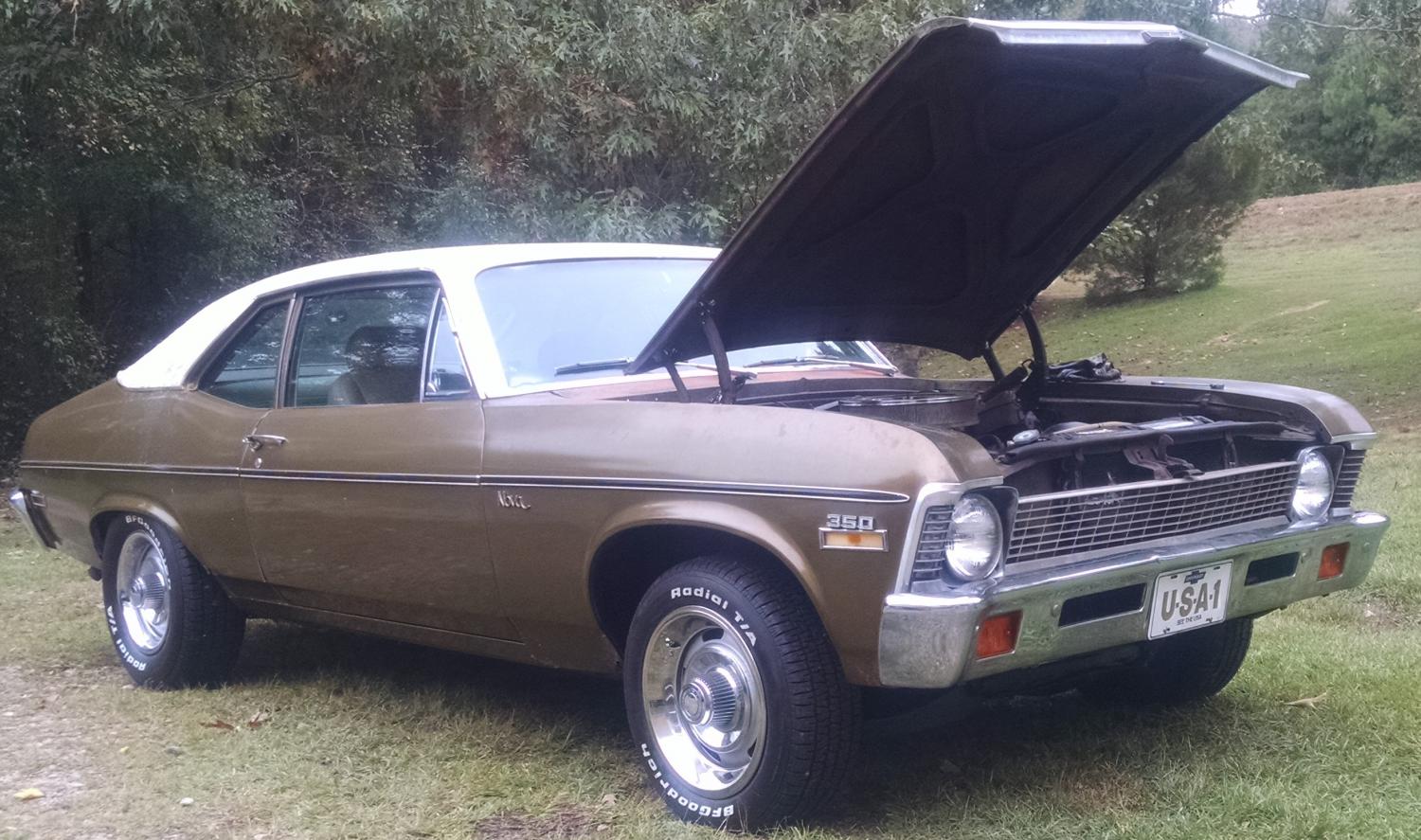

I have to start somewhere with the build, so I decided to start at the beginning. I searched for the cleanest 1969 to 1972 Nova I could find. In fact, my evening, after-work "hobby" was searching all sorts of place for the right car. I eventually found the right car in Ohio, but it took me a year or so. A fellow from American Honda found the car and purchased it from the quintessential little old lady owner. When he bought it, the car had just over 12,000 original on the clock. When I bought it, it had just over 13,000 miles. In between, he stripped the car, put it on a rotisserie and detailed it. The exterior paint is now roughly 70% original: The rockers, front fender tops and hood have been lacquer blended. You'll note he lowered the car (cut coils, leaf spring spacers). Here are some photos of how when I first bought it:
And by the way, like some "restored" cars I've worked with in the past, it didn't drive or stop well...but the bones were outstanding

After driving the Nova for a bit and discovering it had some issues (brakes weren't stellar and the acceleration wasn't exactly awe-inspiring...L-O-L), I decided it was time to get started. This is a photo of it in my old garage on the west coast:
