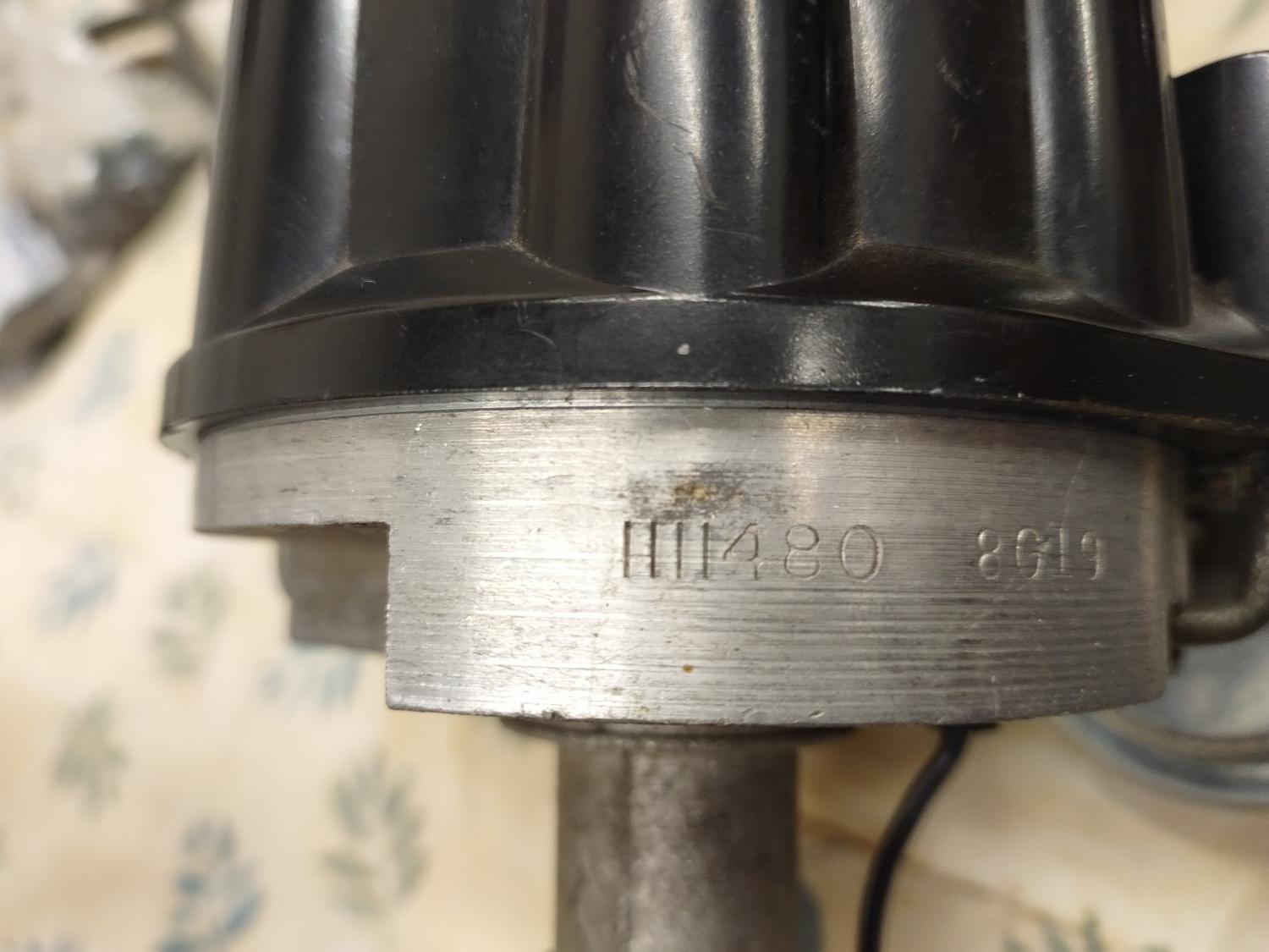

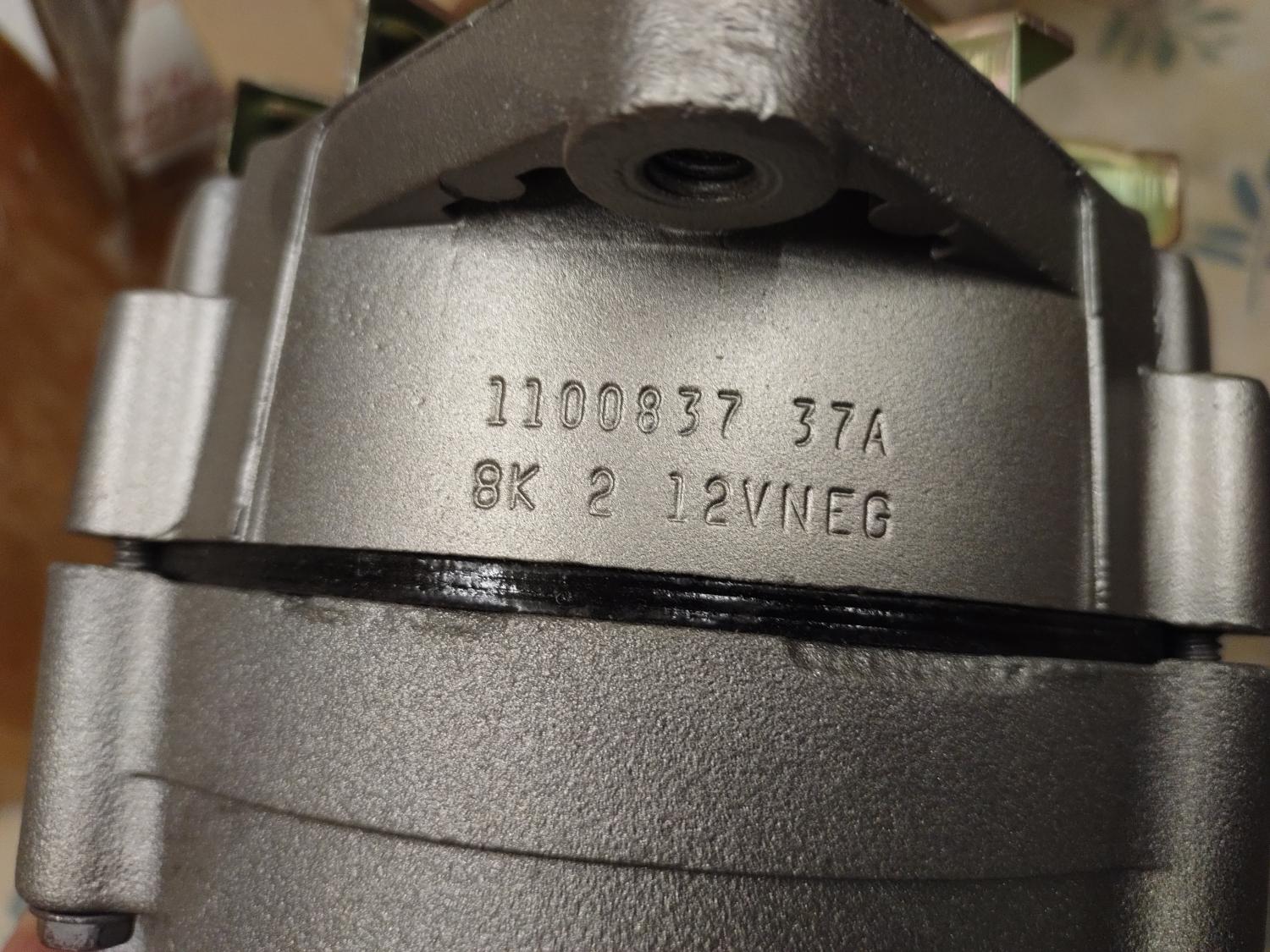

I got both of these parts when I purchased a project car a few years ago. Can the experts please tell me if they are factory original or restamps. It wouldn't surprise me if they are restamps due the previous owners lack of knowledge and research when he purchased parts.

Chuck, the alternator a restamp and the distributor original (real)?
Thats what I was thinking.
Thanks!
You are correct.
