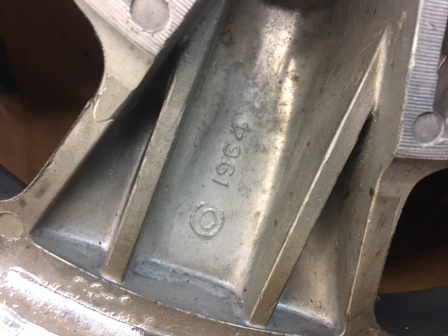

Is this the date code stamp on an old style Cragar SS wheel?

This pic is another set I have. You see the same “16”” as is in the first pic but the stamped five digits are all numerals.
In the first pic some of them are letters. I would assume the 31283 would mean March 12th 1983 but I don’t understand the one with letters in the group.

The #'s on the center cast portion are the original copyright date and later,manufacturing revision date.
The date the rims were actually made is stamped on the inside of the rim hoop. Best way to describe this would be the area an inner tube would touch.
Original Cragar date codes were stamped. Later ones (1980's early 1990's) I have seen NOS were in black ink and some were stamped. No ryme or reason. I believe Cragar has gone back to stamping.

Date codes are stamped, either by being punched or ink stamped into the hoop. The embossed numbers on the back of the spokes are copyright info. Depending on the year of the wheel, will determine where it was manufactured. Some say Mexico, some say USA, some say Firestone. Don’t be fooled into thinking you have a 1964 wheel due to the numbers that are embossed/cast on the backside of the spider/spokes…many do think that, but it isn’t so.
