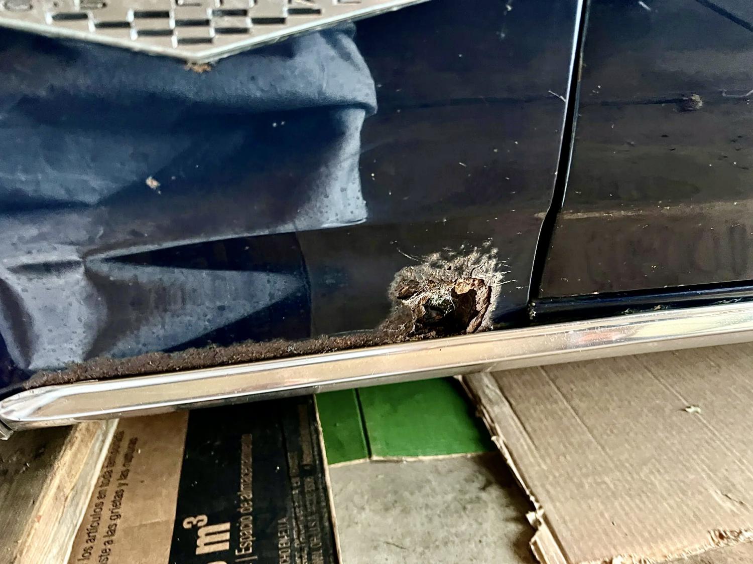

Without a doubt a very cool Survivor, but the seller is not completely forthright.
He has done a very nice job answering questions and providing photos.
At 90,000+ miles in the Midwest it shows what can happen to a car.
I lived my first 24 years in Springfield Illinois so I know.
I have several photos of this car in my files before the family parted with it that shows significant rust issues.

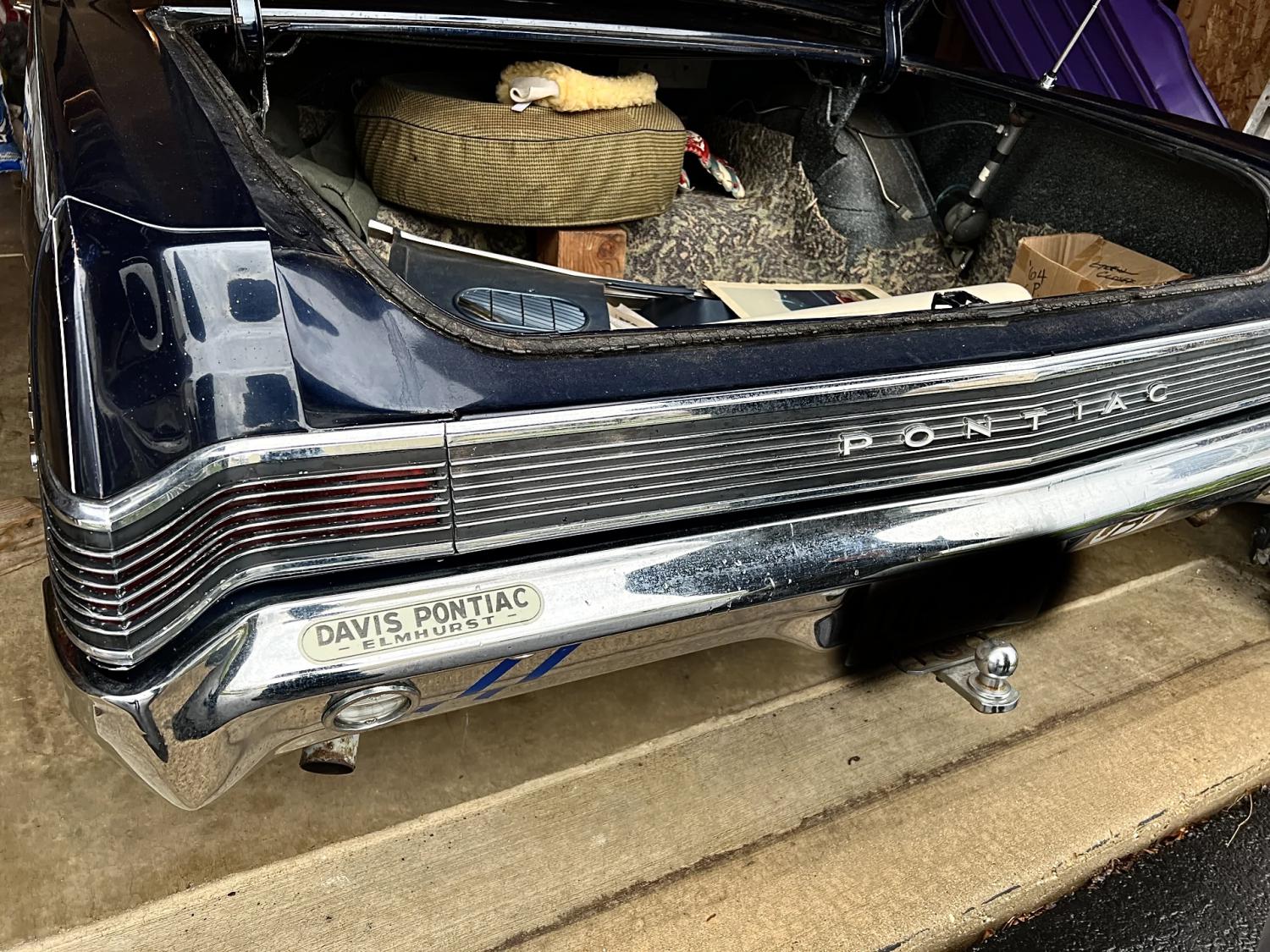

Obviously a patch panel was installed on the lower LH fender that the seller has not mentioned on BaT. The LH inside kick panel is in the trunk probably for inspection reasons.

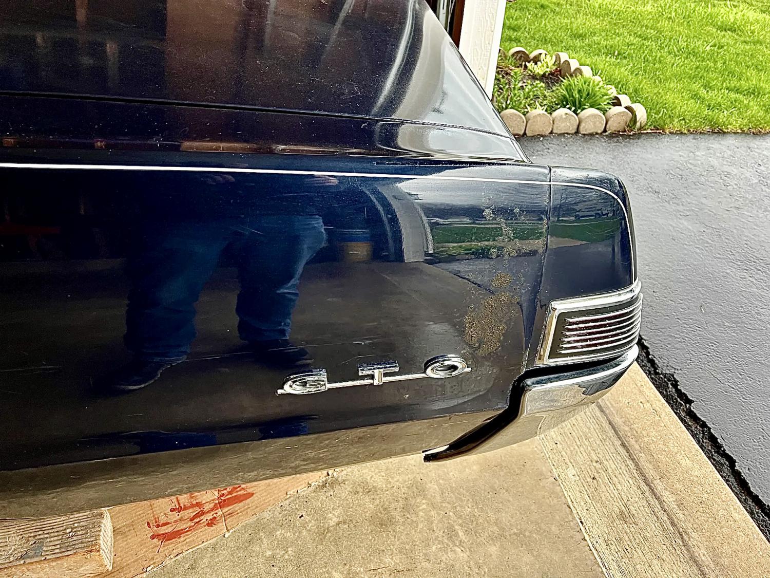

Plus that area at the upper rear LH quarter panel is very concerning. These areas lead me to believe there’s more rust.
I’d like to see the trunk floor in this car.
Besides the patch panel the trunk weatherstripping has been replaced along with outside mirror, shifter boot, etc.
Like I said, awesome ‘65 GTO, but ……

There is no way a car could have survived local conditions, in an unheated garage, and not have some rust.
In my opinion, those photos of the lower left fender show not only rust, but that prior rust was already repaired there. Looks like tiger hair and Bondo to me. Typical Chicago issues.
The auction photos are pretty suspicious. Photograph a dark car on an overcast day, and don't illuminate the common rust areas any buyer would want to see cleanly?
