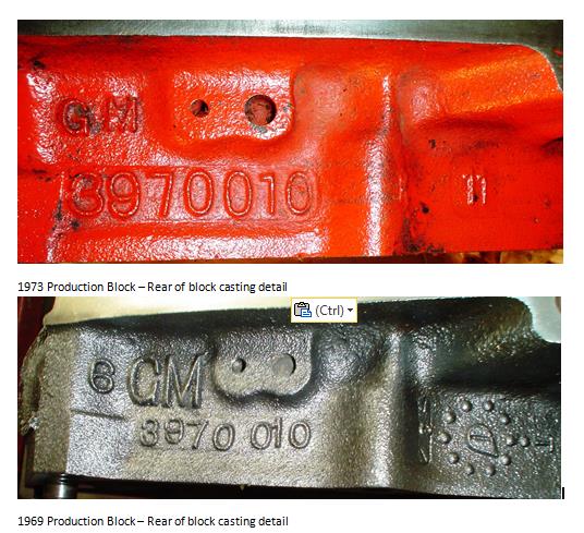

The evidence:
  #38

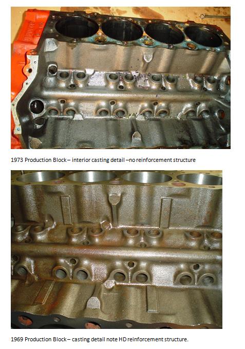

Old 12-05-2022, 02:03 PM
70 copo 70 copo is offline
Posts: 3,834
Thanks: 219
Look at the design. Casting is different.

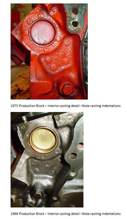

  #39
Old 12-05-2022, 02:06 PM
Posts: 3,834
Thanks: 219
More:

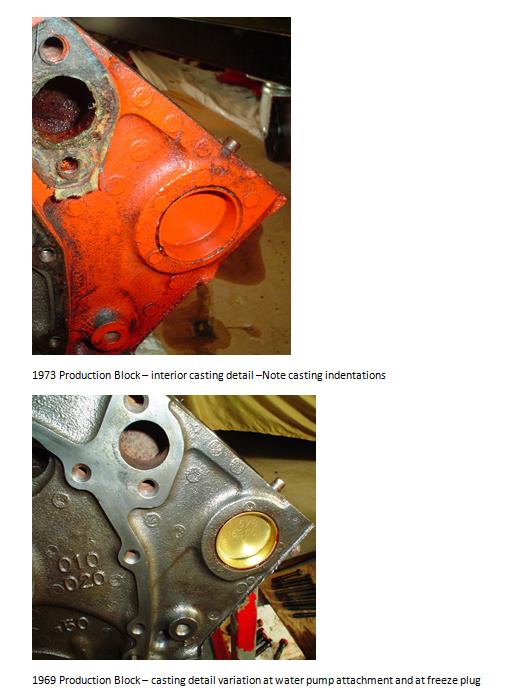

  #40
Old 12-05-2022, 02:10 PM
Posts: 3,834
Thanks: 219
Another:
