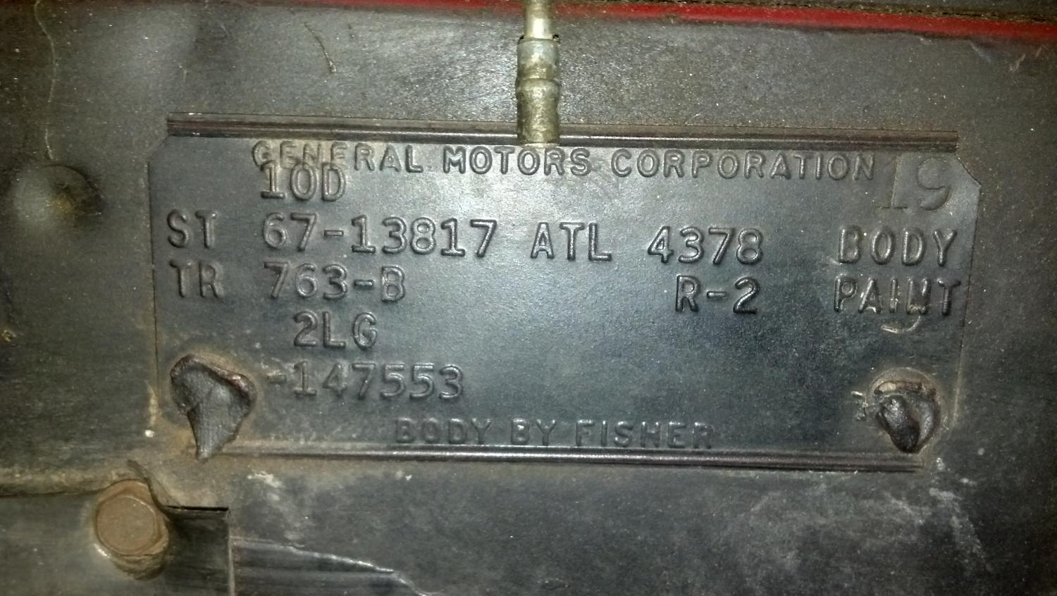

Restoration issues abound...no pix of stamps or TT?? W/S is a bad fake. I'd be shocked if it's a real L78.

Window sticker fake.
Build sheet fake.
Deck stamp fake.
And even if all that stuff "looked" anywhere close to correct, the car is WAY to early to be a factory built 1967 L78 Chevelle.

138177A118568
T0322EG
Someone will buy it without doing the basic research of verification
It’s unfortunate.
However, in this current market even a Faked Pretty Car will bring close to $70,000 to $75,000

It's even worse than that, Mike. Engine stamp is T0822EG. VIN sequence puts it as an October built car. Hence my use of all caps when I said "the car is WAY to early to be a factory built 1967 L78 Chevelle."
