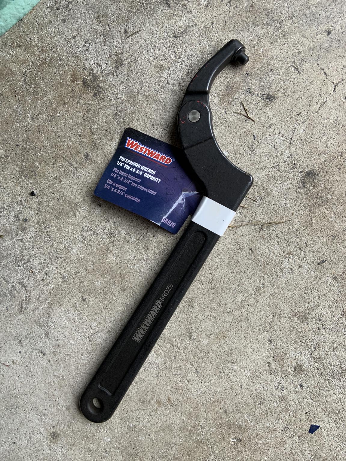

Here's the suspension details. The factory installed, fixed spring, Koni shocks were sent back to Koni in 1993 and they installed the adjustable spring perches for aftermarket Eibach springs.
I have been on the phone with Koni and Eibach this week trying to find the correct spanner wrench for adjusting the spring heights in case I ever want to mess with the settings. Back in the day I uses a 5/16" drill bit inserted into the adjuster hole in order to spin the spring perch. Not too easy with 500 lb rated springs. Neither company makes the wrenches so I had to search to find an old style round tip spanner for a 82mm perch. It should arrive tomorrow. All the modern perches now employ a square adjuster slot and use a flat, hook style wrench.

The spring perch wrench was delivered today. It's a hefty piece of iron, indeed. $50 worth. And it fits, too: an added bonus for sure.

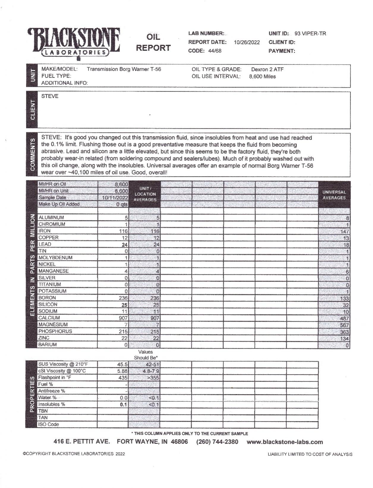

I got the transmission oil analysis back from Blackstone. Looks good for 27 year old Dexron (Torco Synthetic version that I filled it with around 1995). I guess I changed it just in time as it just hit the .1% insoluables level. :-)
Waiting on the rear differential and engine oil results next.

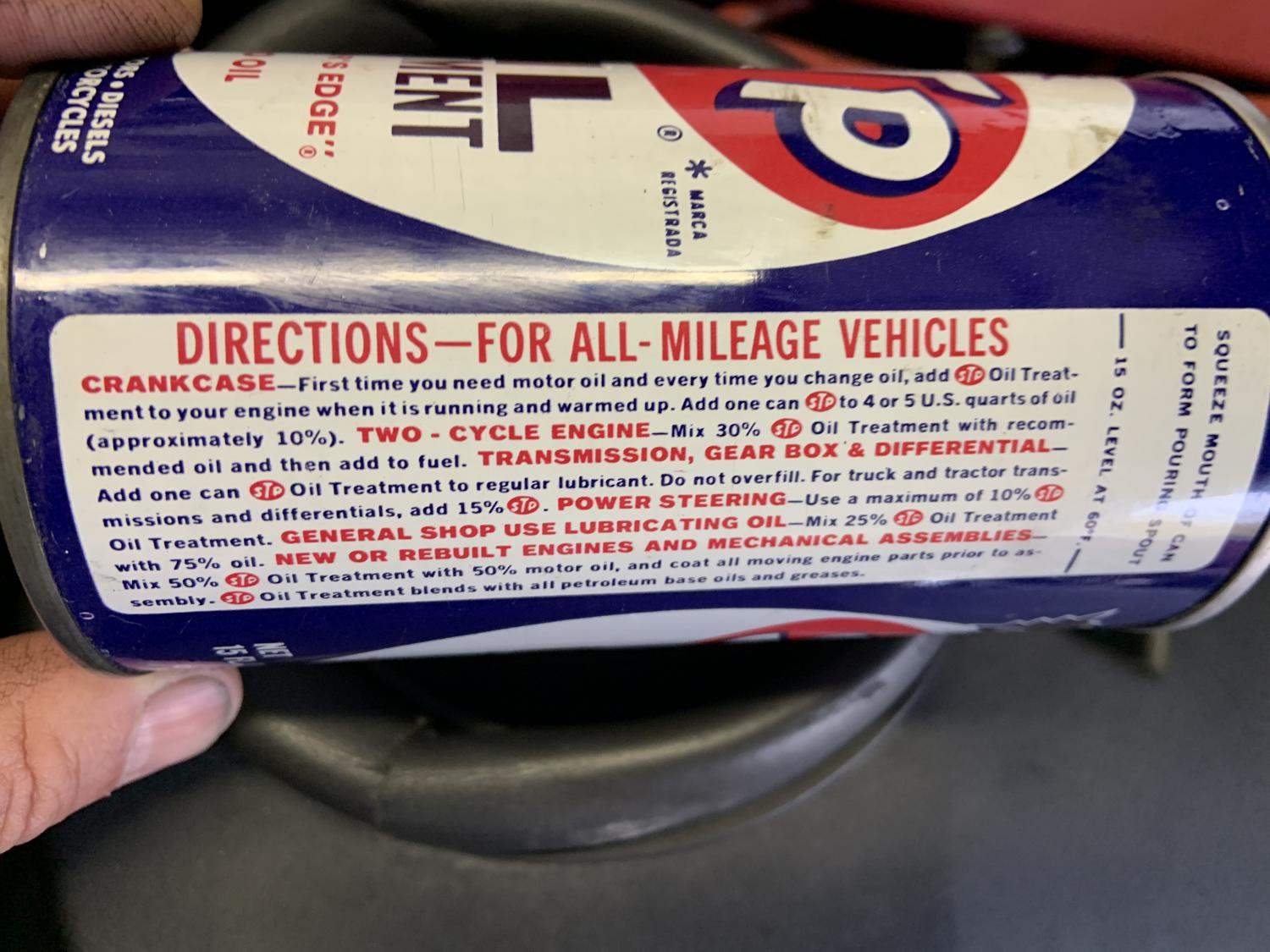

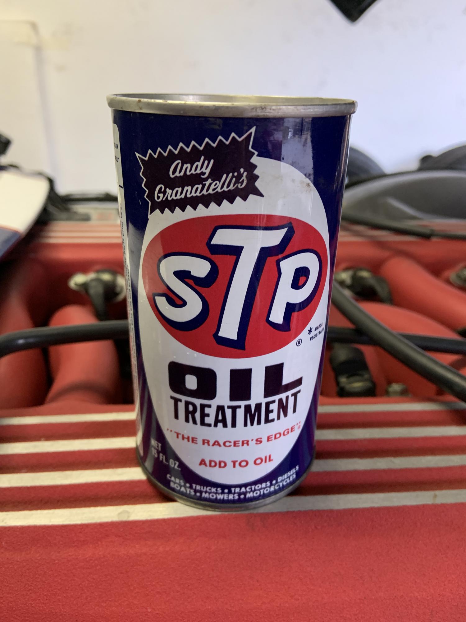

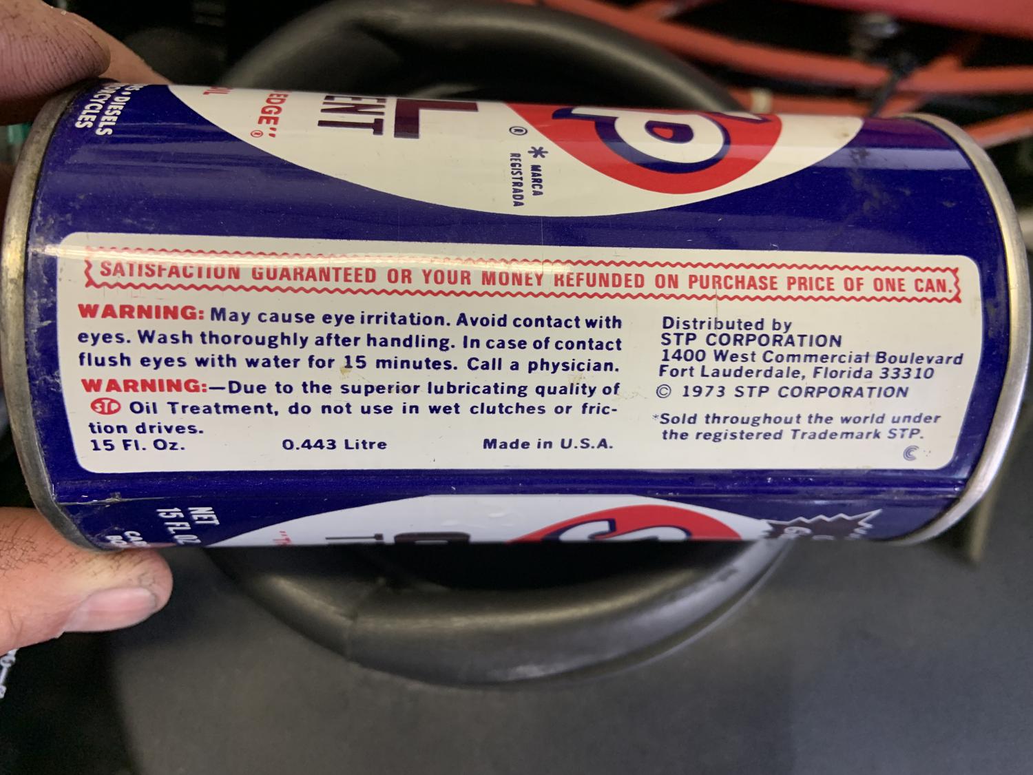

A good friend of mine has a vintage case of STP Oil Treatment from 1973 and he gave me one to throw in the Viper.
It's got the good old oil additive stuff in it from when we were kids!
It's got real sugar I tell ya. None of that fancy, schmancy high fructose corn syrup for my baby.

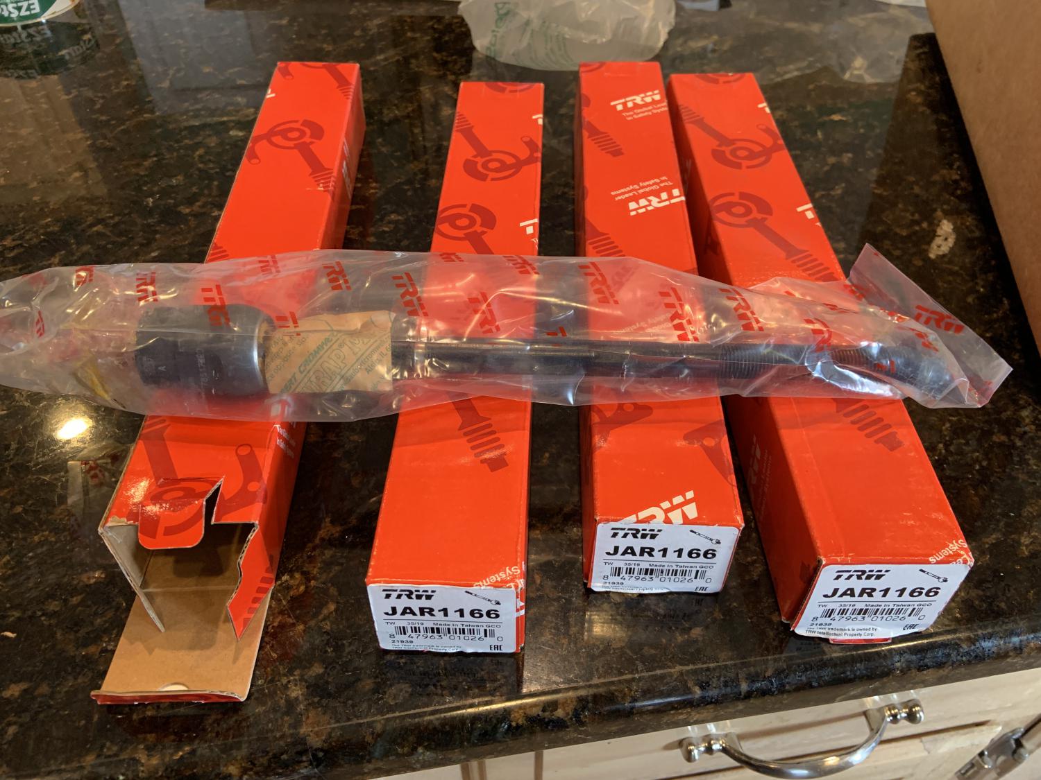

I've started hunting down extra spare parts for the car when they pop up cheap on rockauto. They actually have some dealer closeouts of the early Gen1 front and rear inner tie rods. TRW units for $11 each as wholesaler closouts. I got four of them. They still have some left. (BTW they're actually a Dodge Dakota truck part!)

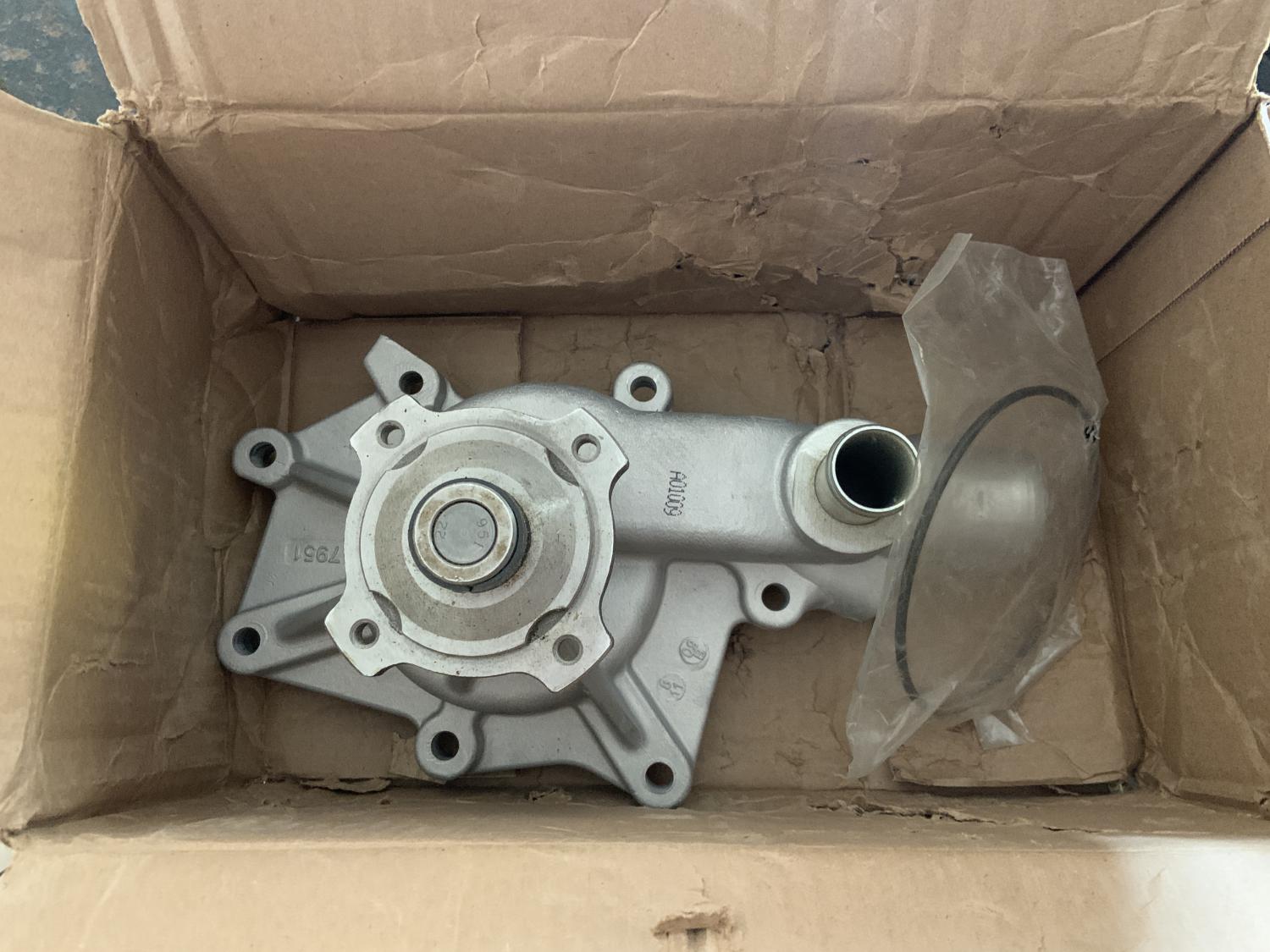

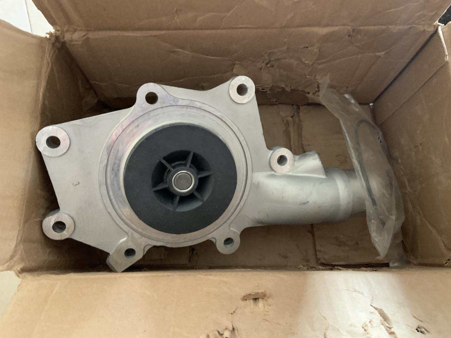

And a Early Gen1 1992-93 waterpump for $135. Original box was chewed up but the waterpump and O-ring were fine inside. This stuff is gold!
