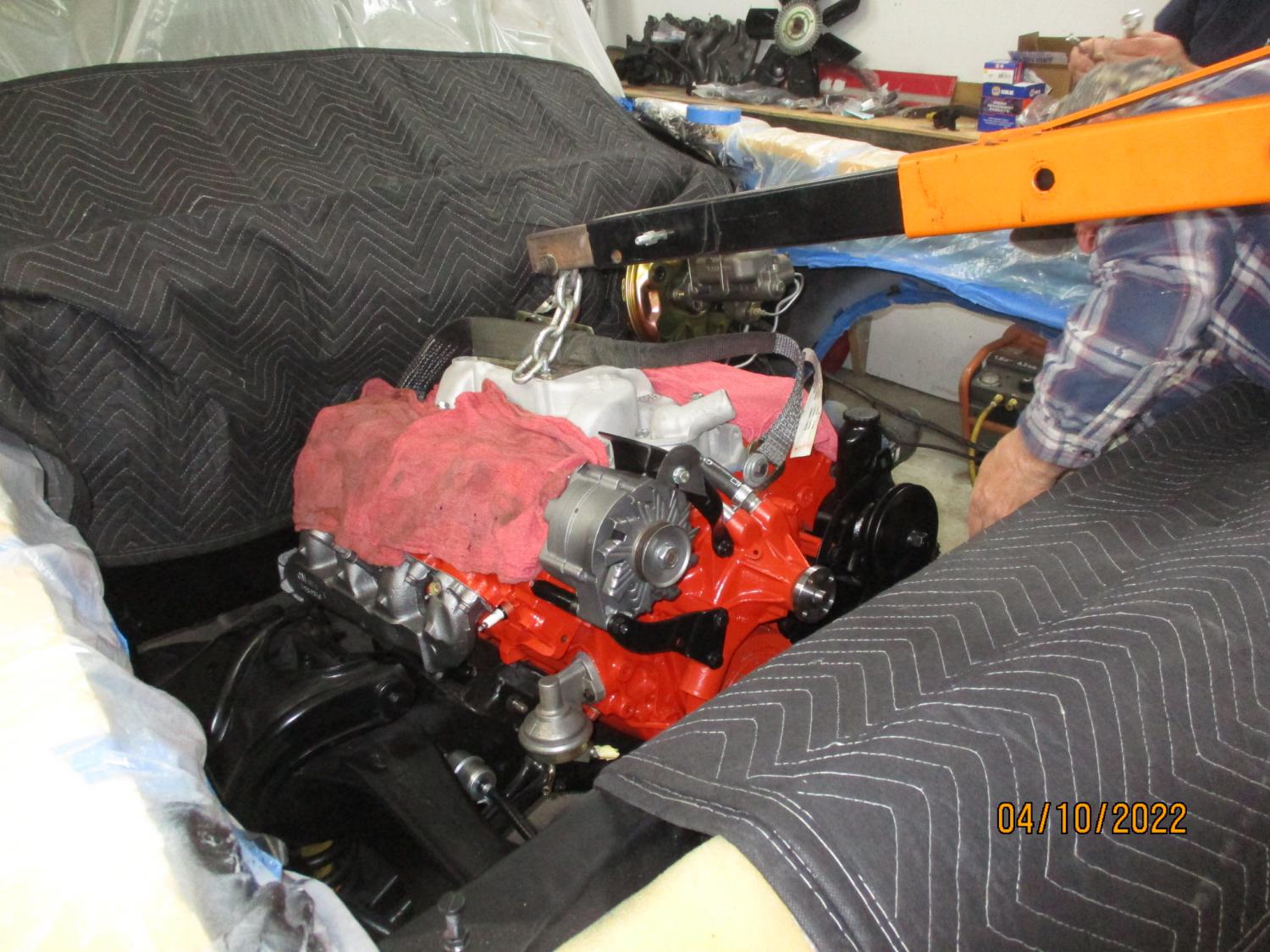

Old 04-11-2022, 12:27 AM
WILMASBOYL78's Avatar
Location: new york
Posts: 8,422
Thanked 2,305 Times in 612 Posts
Post Chevelle Update...
Engine and tranny went in today...we had the usual issues with bolts and odds and ends...some swearing...but it all happened. Still lots of detail work to do, install radiator, new inner fenders, trim out the engine bay, etc.
The boys did a good job.
