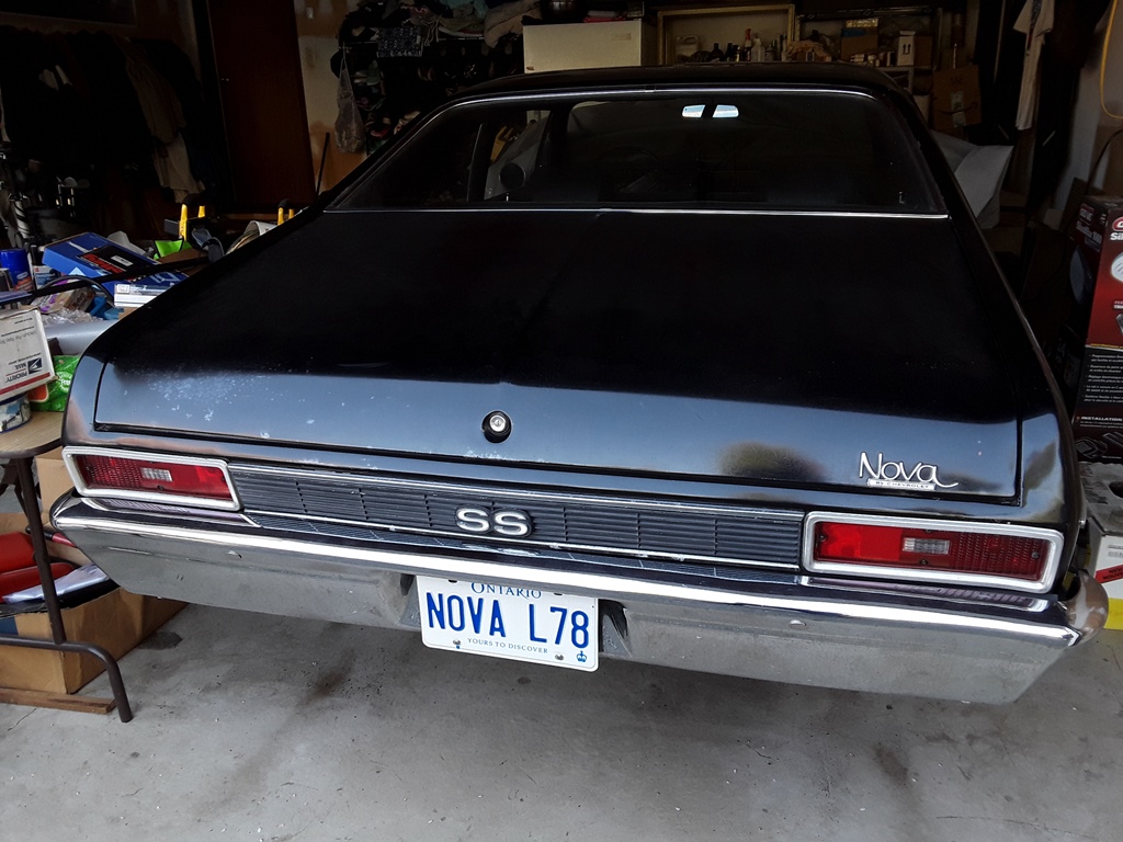

Looks like a very nice original Nova. You can also try a little heat from a torch to break those lines, but not too hot.

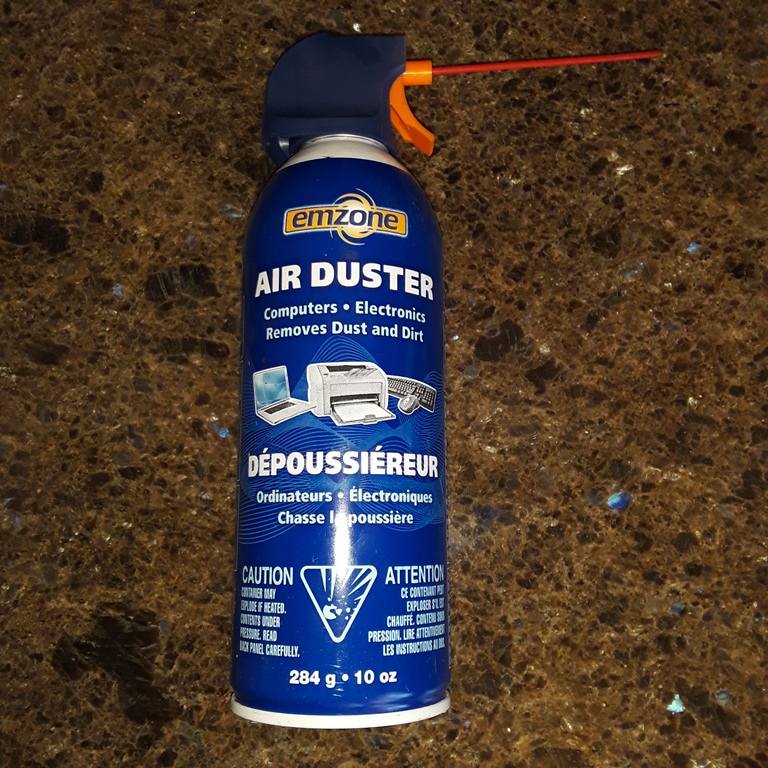

Originally Posted by frankk View Post
Don can you explain the freeze technique
I can't explain the chemistry of it, but here's how it works. You go to Staples or some other place that sells a aerosol spray air duster. It's really meant to blow dust and small particles out of computer components.
Shake it, turn it upside down (yes, upside down, not a mistake) direct the spray. It comes out very very cold and "boiling". Wear protective gloves of course.
