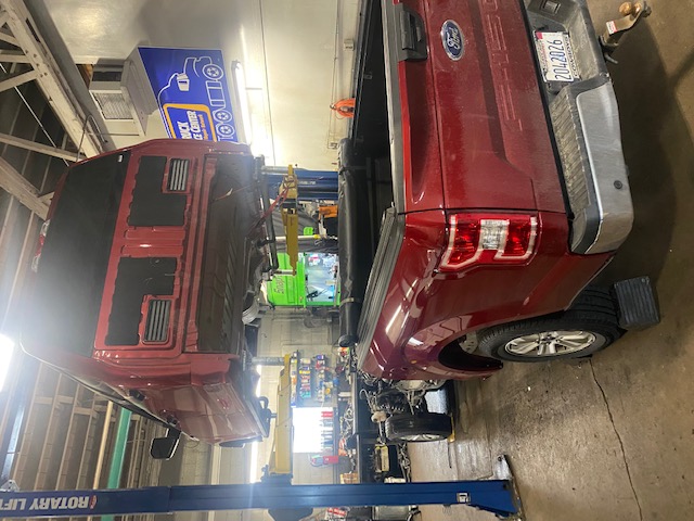

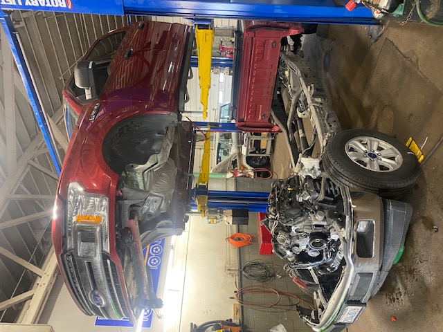

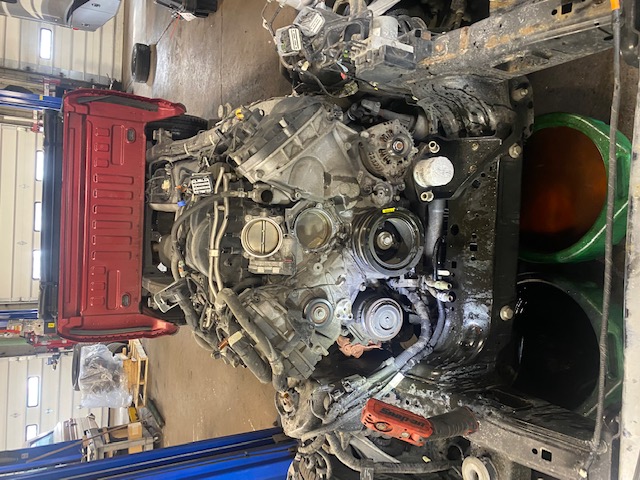

These were taken in my shop earlier this month of a 2018 Ford F-150 we did a timing chain and guide job on. It is a 5.0 V-8 with 124,000 miles.
We take cabs off of GM and Ford trucks all the time, Diesel or Gas, it beats leaning over fenders. It usually takes us about 2-2.5 hours to remove a Cab including recovering the A/C charge
