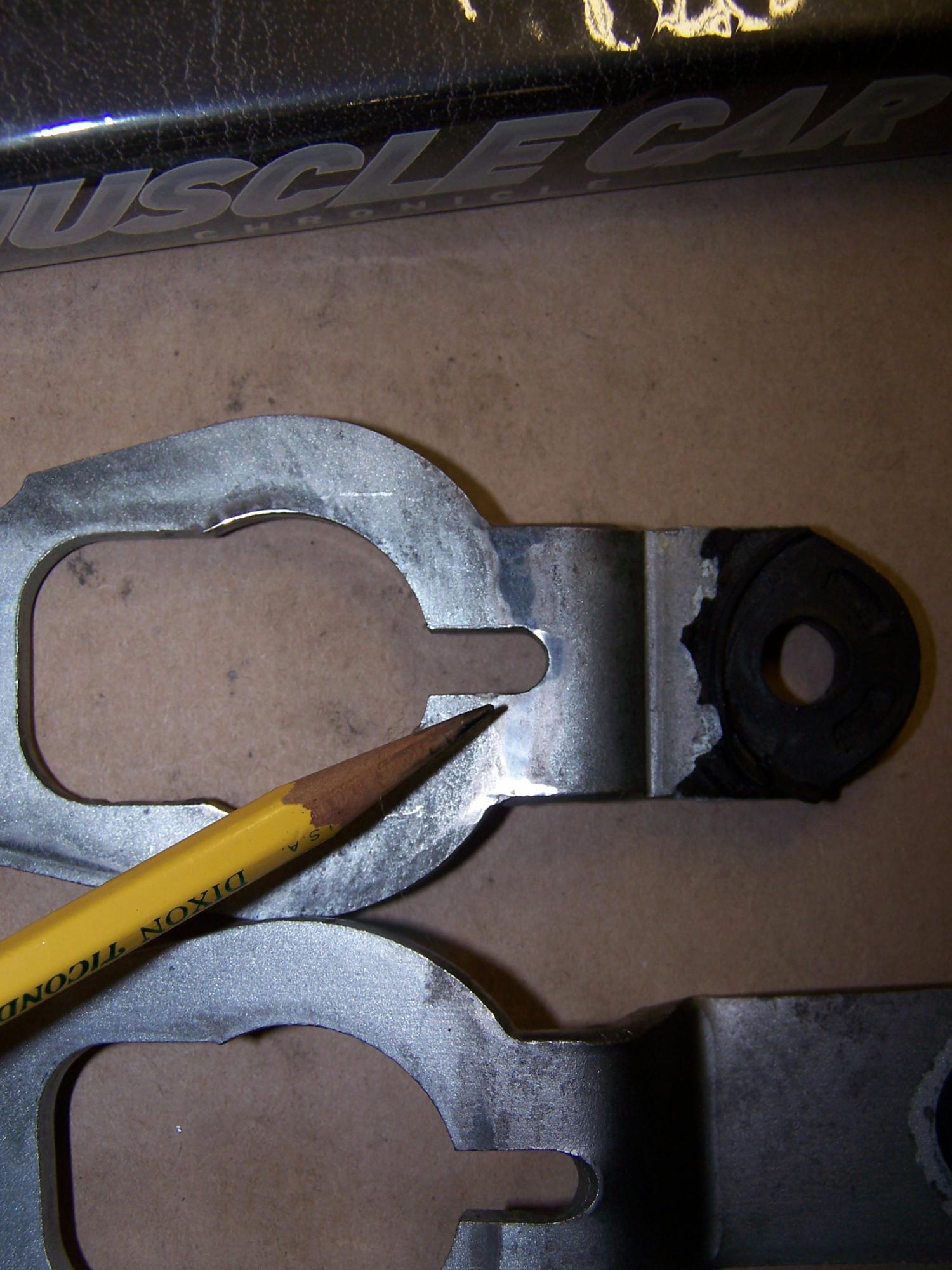

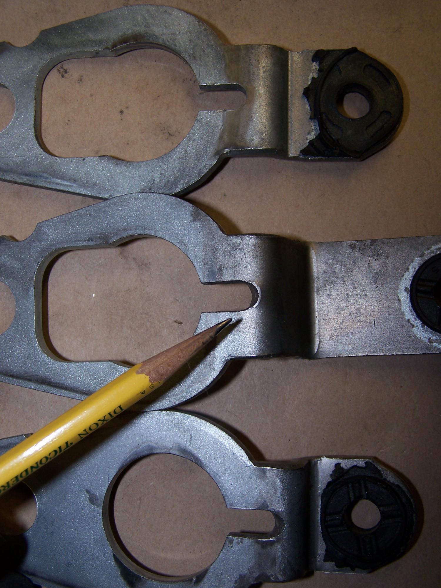

The rounded edge of the slot is "pulled" due to the part being formed/bent into the configuration AFTER the center was punched out.
