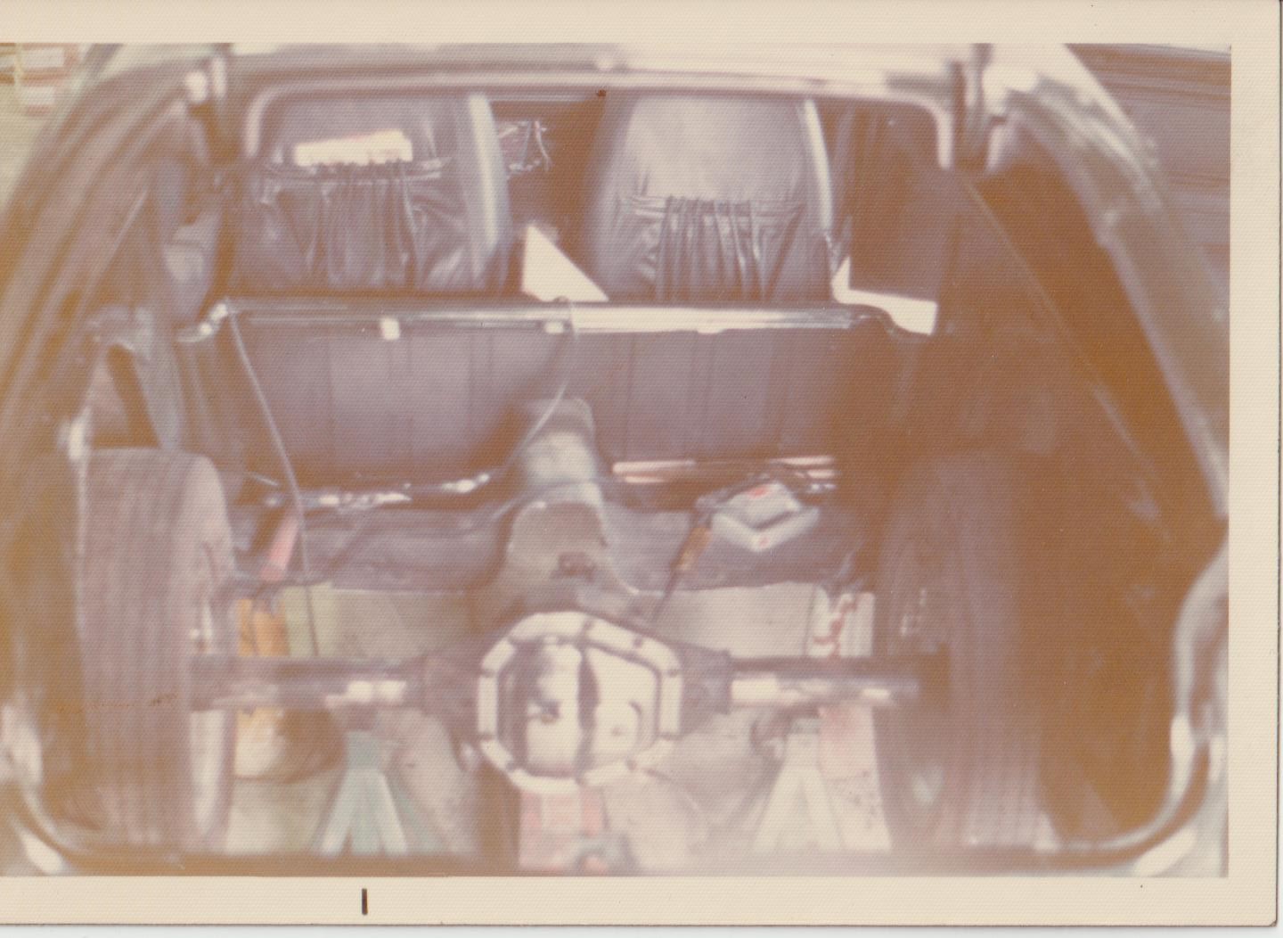

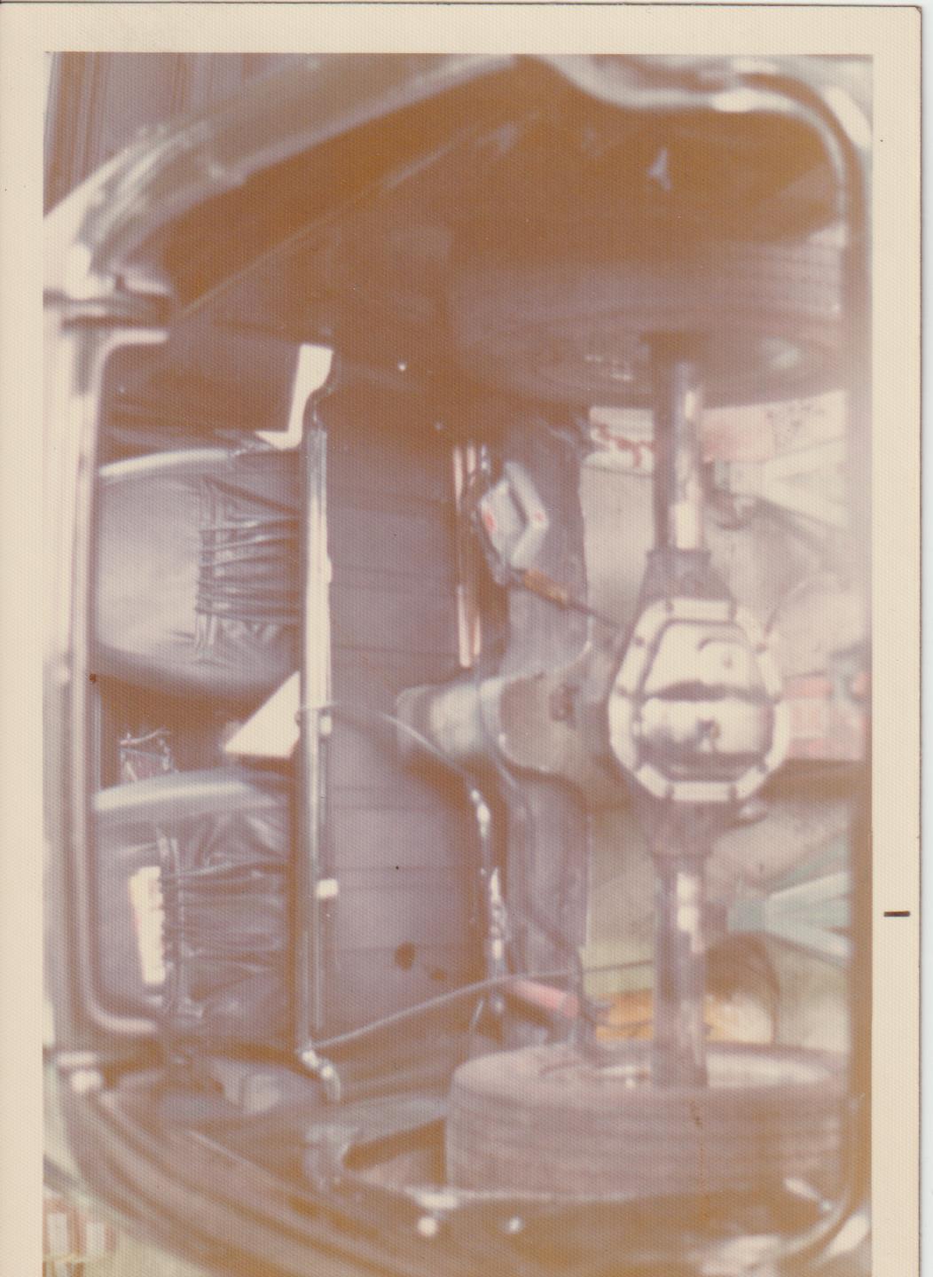

So I'm walking through the pits with a buddy one day. It was a big show weekend and the new Pro Stocks were there all lined up. I heard something coming behind us and I turned around and it was a blue Vega wagon. It was Jungle Jim Liberman in his Pro Stock Vega wagon. When he drove by I looked at the back and all I could see was tire. It looked amazing. I looked at my buddy and he said Forget it man. That car would cost a fortune to build. 6 weeks later I called him up and said I have to pick up some parts. Do you wanna come? 1 hour later we are pulling into the back lot of Belmont Chev Olds. Davey wanted to wait in the car but I told him I needed a hand. We checking were out all the new cars. There was a midnight green Vega Panel Wagon sitting all by itself at the end of the aisle with nothing else close to it. It was late November and we had our first snow fall. The color was very dark and it had tinted glass. The snow had covered the drivers side window and we were standing on the passenger side. It looked like the car had dark tinted glass. You could barely see inside the car. Kind of dark and mysterious. Davey came up and said what are you looking at? I nodded towards the Vega. He looked and stopped instantly. Are you f**king kidding me!!! Are you going to buy it? I said I already did. We checked the car out. It was a 73 Vega Panel Wagon. Dark Midnight Green with black interior and tinted glass. It had one cheap beige seat in it and not many options. Tinted glass, HD battery, front disc brakes and HD cooling. No carpet.
It was listed as a truck with a truck ownership. Most buyers would be using them as a parts delivery truck. It came with a 3 spd manual trans and a 4 cylinder aluminum block motor. It was $2352 out the door! After driving it a few months on the street it was time to get started.

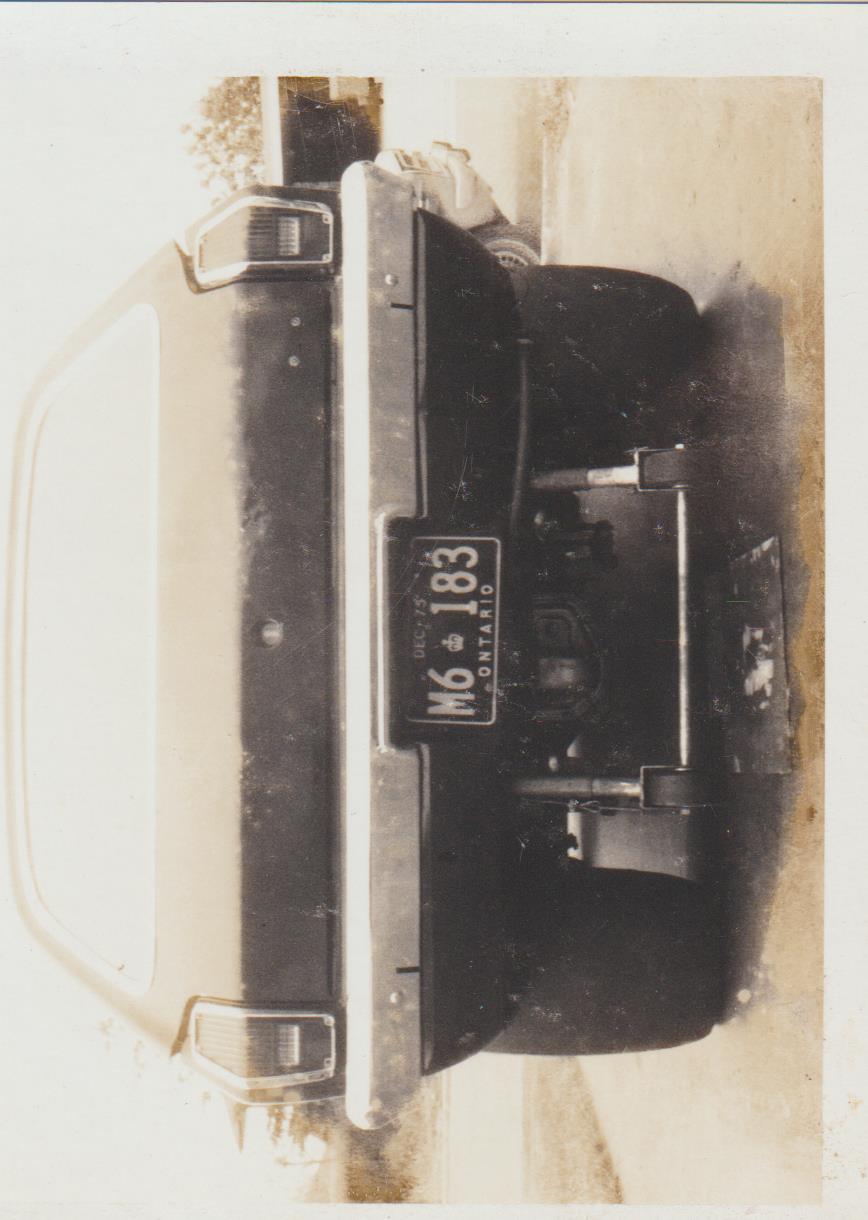

I called around looking for a chassis shop. Don't forget. This was 1972. There were not a lot of performance chassis shops around. After searching for a couple of weeks and getting ready to take it over the border I called Beatty & Woods. At first they didn't know anyone in Toronto that did that kind of work. Someone called me back the next day and gave me a number of a guy who worked on Hot Rods. His name was Dave Jackson and he was a good fabricator but he had never done a full back half or any job this big. It took a lot of talking and finally he decided to give it a try. He started on the car a couple of weeks later. On my third visit to his shop I met Wally Clark. He was a well know racer. He was a great guy and knew his shit. I figured if Wally was getting work done on his Vega here then I was in the right place.
I picked up a Dana 60 rear from the Courtesy Chev drag car that had crashed at Georgetown. We checked the rear end for straightness and one axle was bent. Luckily the rear came with a second set of Quarter Master axles so all was good. Dana axles are like baseball bats compared to a 12 bolt. The rear came with a 5:87 gear. Perfect for the street. lol. When I got the car all together I realized I could get a fairly wide tire in but the stock rear quarters could not take more then a 26" tall tire. Perfect. lol. I wanted to get the car all sorted out before I had the quarters opened up and the car painted. I remember sitting in Harvey 's behind the building and driving to the road. I could easily get the car into high gear before reaching the road. Talk about an eighth mile car. It didn't have much top end but not many could take me at a light.Emoji
Dave cut the floor from the back of the front seat to the rear bumper. The Dana fell right in as it was made for a Vega. Except for front end limiters the front end was all stock. I even kept the 4 bolt spindles and original coil springs.
I used the Hooker Swap Kit as there wasn't many available and it was well designed and came with 3 piece headers, motor mount plate and a trans crossmember.
At this point the car had a ladder bar suspension, mini tubs, 6 point cage, SBC, Muncie 4SPD and a Dana 60 with original paint. All tin work was steel. Even the stock hood and bumpers. I had picked up 2 bucket seats from a 1970 Celica, 3 gauges and a tach. This combo was Stage 1.

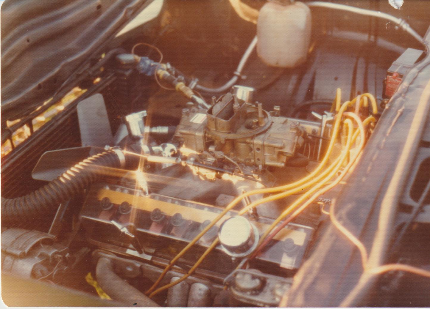

I got the 327 from the Chevelle on an engine stand and fixed a few leaks and painted it Chevy orange. It dropped in fairly easy with only a few mods. The headers were the most work but still went in fairly easy. This swap kit required you to cut a hole in the front wheel well for one of the header pipes to go through for more clearance. The inner stock wheel wells in a Vega are reinforced steel to help the unibody. I decided to keep the front end stock. The only mods I did were front end limiters and tow bar mounts. I also was running the original 4 bolt front spindles.

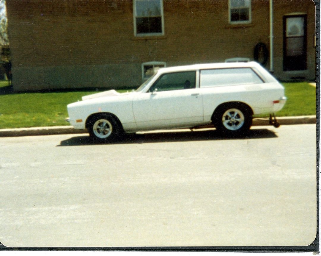

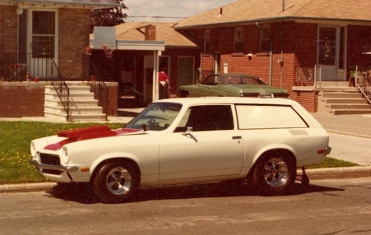

So it's 1975 and the car is finally all sorted out and running well. I took the car to John Rossiter to check all the angles as the car does not feel right when it leaves. Turns out the custom ladder bars and mounts are all wrong. So I order all new stuff from Allison. Bars, mounts and brackets. We also cut the rear quarters to accept a taller tire. Each outer wheel well is cutout as a rectangle. Then you section that piece right in the middle at the highest point of the stock wheel well opening. As far as I can remember they added a 6" section which allowed for a 14 X 32 tire.
After I had the quarters opened up I decided to paint the the car. I had a guy who would paint almost anything including a color change for $750 and that was a quality job not a quick splash. At first it was going to be all white. It looked good but it just needed something to make it pop. I decided on a red stripe and I was happy with the way it turned out. I also put a reasonable gear in the car. I think it was a 4:33 but I'm not sure. With a 28.5" tire the car drove great around town. I drove it to the track a couple of times but it really made me nervous thinking something would break and I would be stranded. No cell phones back then.

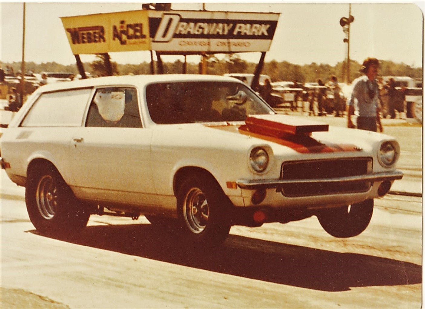

So paint, glass hood, gears, ladder bars,350 SBC, tunnel Ram, crash box and 11.50W slicks were all done in the winter of 75. The car was all back together and ready for the car show. Speed Sport was one of the largest car shows in Canada and I was in that show at least 10 times. If you look at the pics you will see the fork lift lifting my car to the upper level. A buddy of mine told me not to watch them lifting the car up. I thought he was joking. OMG!!! When the car got near the second floor that fork lift started swaying like there was a strong wind. I kid you not. I was actually shaking!!! The fork lift guy jokingly said don't worry. I have only lost 2 so far this year! Haha. I wasn't laughing.
You'll hear me say this a couple of times. There are certain times in your life when you get a "SPECIAL FEELING" that you might never feel again. We all know those special times. When I had to drive the car up on the platform for the fork lift was one of those times. The headers were open and I'm in enclosed building jammed with Hot Rodders. Everyone is setting up their display. First I turn on the the electric pumps. I have 2 660 Holleys on the tunnel ram. That means 4 fuel bowls to fill. The car starts easy if you know how to do it. And of course this is one of those times were it might not start. A few people are watching as I hit the starter for about 5 seconds and then hit the ignition switch. WAM! Just like I knew what I was doing. Everyone drops what they are doing and turns and looks. I creep the car towards the platform which has a ramp/lip about 5" high. A perfect place to stall. The motor is cold so I bring the revs up to about 1500 as I slip the clutch. I get it on the platform and that is done. Of course I am totally straight faced as if I know what I am doing. We set the display up and walk around checking out the rest of the cars.
That weekend I pickup The Toronto Sun Newspaper and there I am on the front page! Geez! How did that happen? The car is almost in the centre of the pic. When I get to the EX everyone I know and a few I don't know make a crack. So one friend says how did you pull that one off? I said what? YOUR CAR ON THE FRONT PAGE OF THE SUN! Oh. That. Those guys have been bugging me for years to do a feature on the car.LOL.
