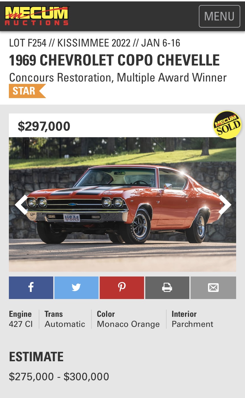

Is Roger D's car selling at this auction?
Sold....Hammer price $270K.

Website says $297,000?
Originally Posted by Bill Pritchard View Post
Hammer price $270K.

"Website says $297,000?"
$270K + 10 percent buyers fee, I suppose.
Yes, website prices include buyer premium....I was stating hammer price.

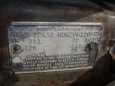

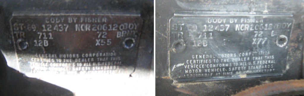

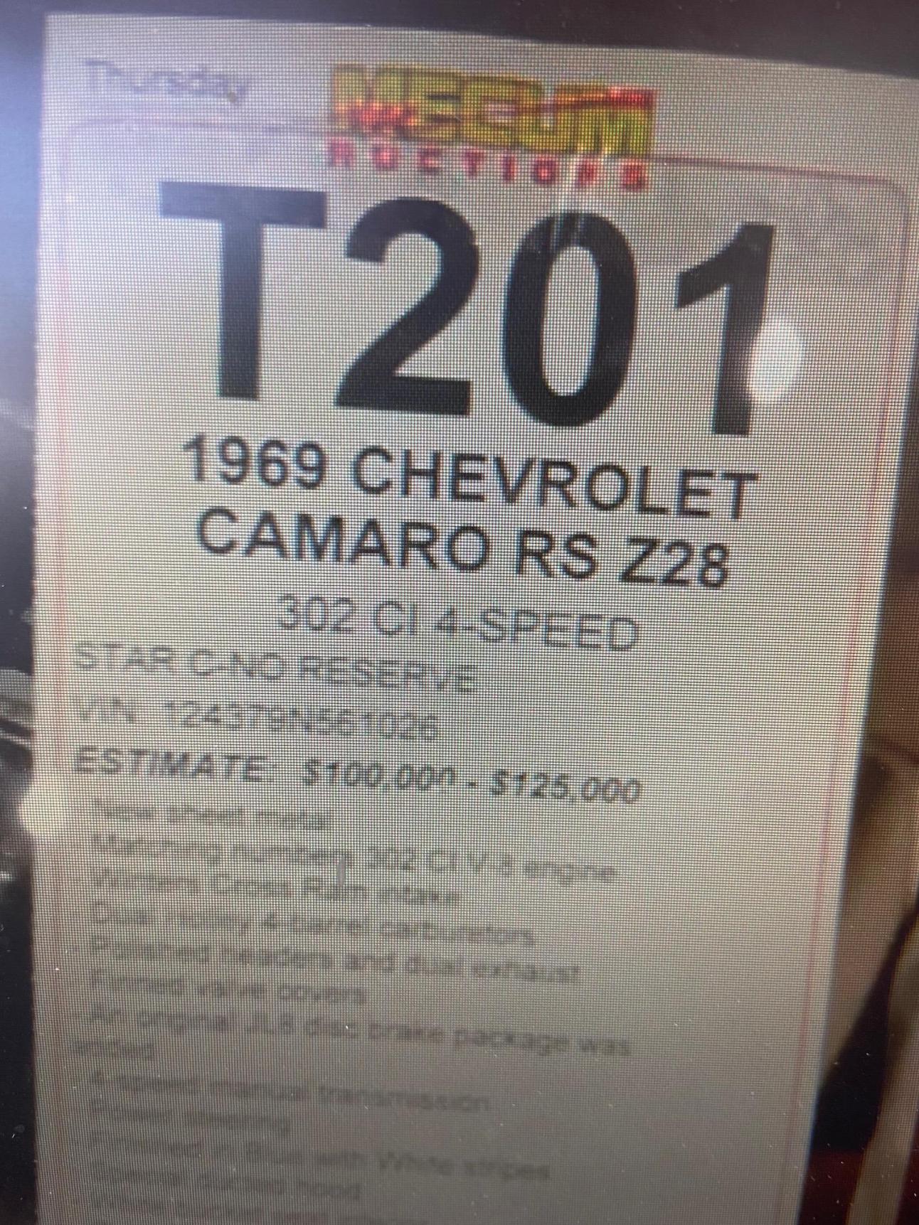

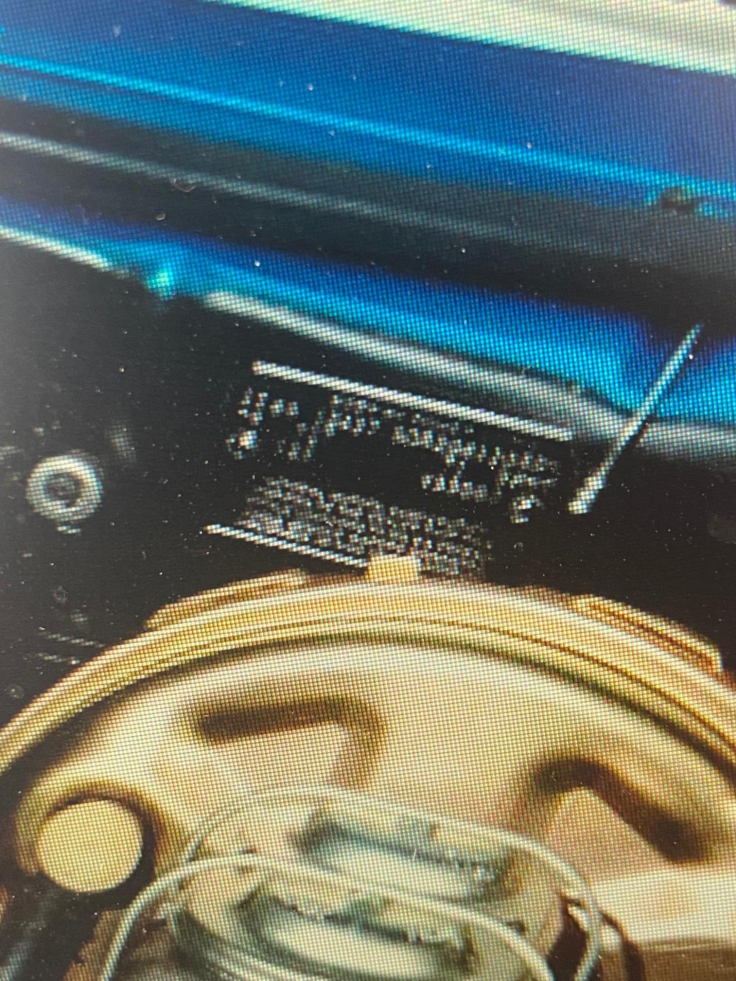

Originally Posted by Pusher_Man View Post
Hate to say it but check out the trim tag on T201. FAKE
How would you like to pay nearly 150k for a fake Z?
https://www.mecum.com/lots/FL0122-48...camaro-rs-z28/
The new owner of that car may or may not care but do a search on the VIN.
A few posts uncover alot of fraud on this car.
VIN 124379N561026
Around 2008 this car surfaced as a z28 for sale after it was sold on ebay as a X55 SS350.
Then someone decided to Flattened out the 55 and make it a 77 over it.
They didnt like that so they had a repop tag made up using the same body number 206120
Looks like the current auction cowl tag is another repop using NOR206120 but is X33D80. 12B. 71-B
So this car was a 72-B X55, then and is now a71-B X33D80 and sold for $148,500 plus premium. WTH??
VIN 124379N581026
Is the VIN 124379N581026 or 124379N561026? The sticker in the window appears to show the latter. I noticed the fake trim tag when I was looking at the pictures online. It's not the only Camaro in that collection with a fake tag.
