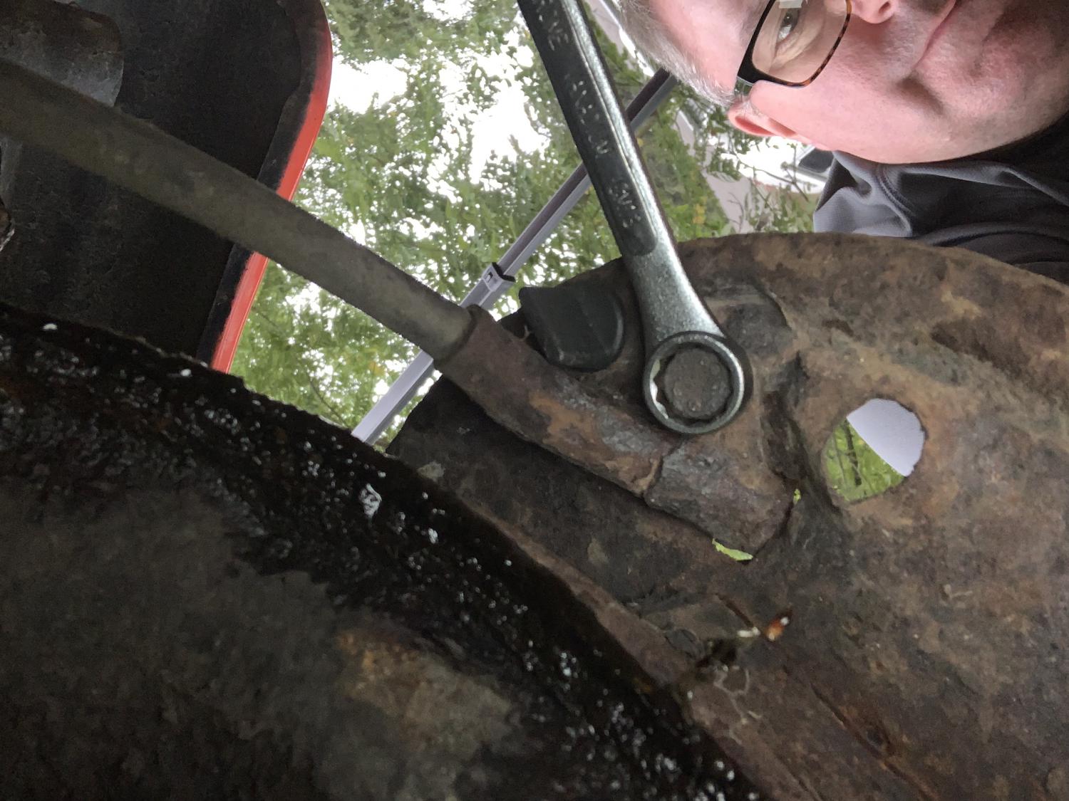

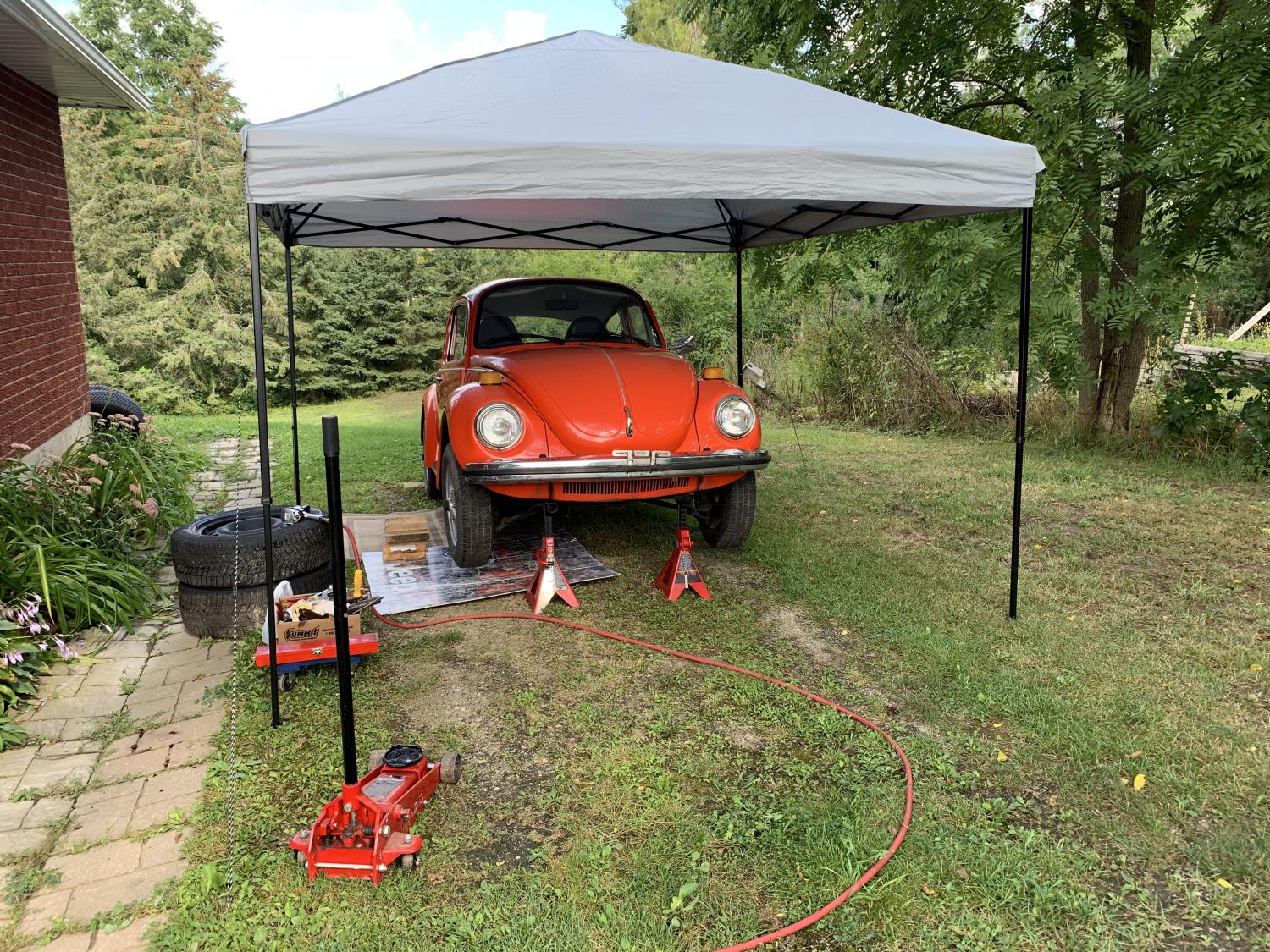

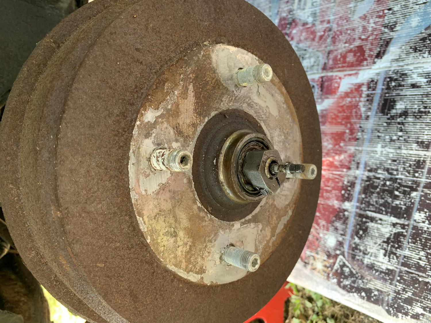

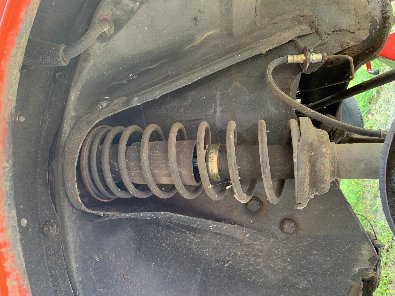

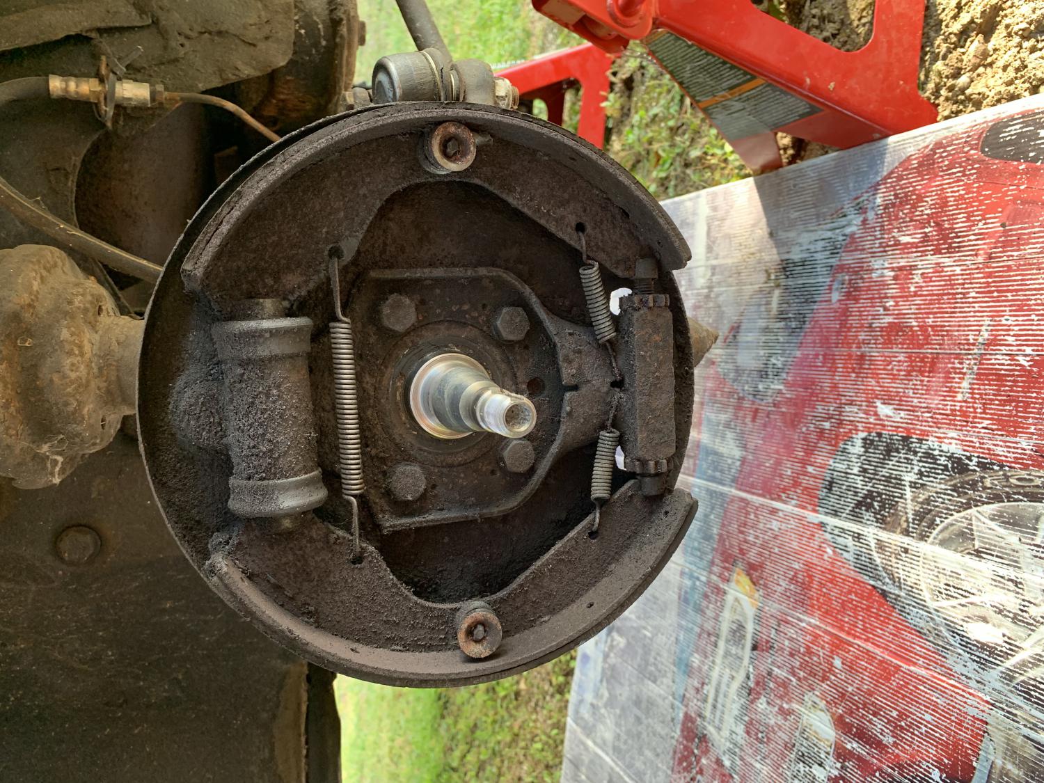

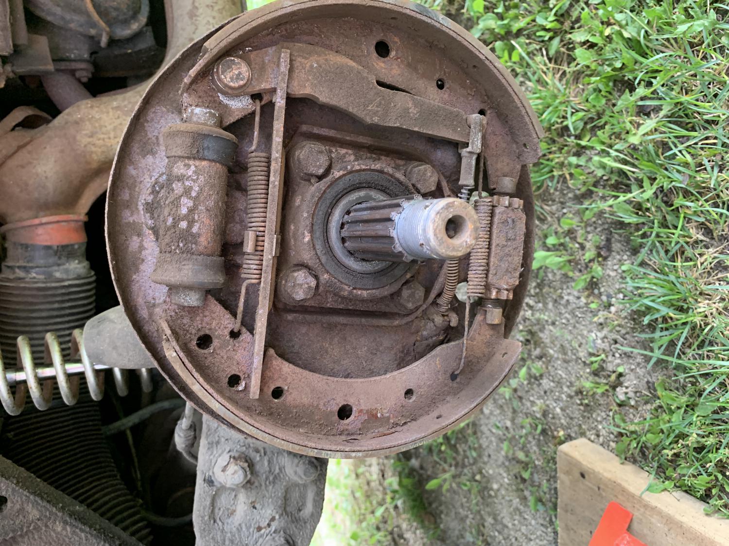

I spent the day disassembling and inspecting the brakes.
I plan to do a full brake job while I have it apart.
Flex lines, wheel cylinders, shoes, hardware kits, and turn the drums (as long as they have material left… they look very good)
What a fun day going all over the Beetle, I still can’t find any serious corrosion!!

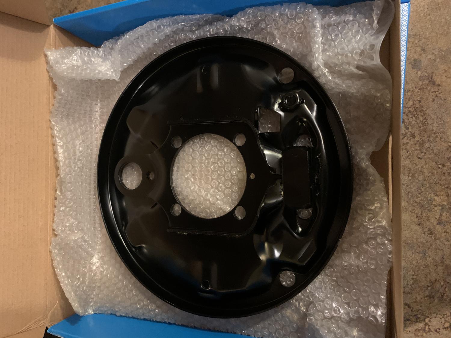

It took me a while but I finally found what In-line Tube/Fusick are to Oldsmobile for VW.
California Import Parts 1 CIP1 free shipping over $100.00 and they have a business in British Columbia so in Canadian Dollars!!!!
My final parts have now arrived.
I ordered new backing plates as the original rears were a little beyond sandblast and paint. (The area on one around the wheel cylinder was slightly soft)
Now I can assemble the brakes, and replace any brake lines needed.
I need to step on it to get the car on the road before snow!!!
