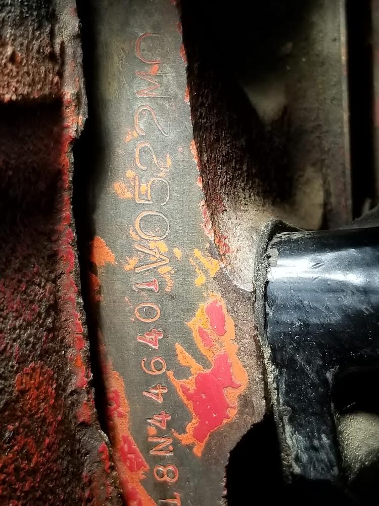

Does this car have any Legit stamps, or reason to think it is an original Z ? Even has the glove box sticker, (but I would assume they make that sticker by now)

Good looking car, real Z? To many red flags for me.
Such as? I am interested to learn what you see that is of concern.

I would point to the utter lack of plausible broach marks on the pad and the fact that all the character stamps look like they were done one at a time and not in a gang. JMO.
Yes, my thought exactly. Also non original trans, another set of numbers “missing” for comparison.

For comparison.

Thank you for the comparison. One of the more sloppy jobs I have seen lately. The last red Z on there was very similar in that it had nothing that pointed to being legit, yet most of the information presented was able to pass muster by viewers and the car still went for 100k. I assume this one will be very similar price wise. I know there a ton of fake 69Z cars out there, I wonder how many 68Z cars have been faked. Seems easier with them, and now that examples are selling at a higher rate will more of them come to market? time will tell
