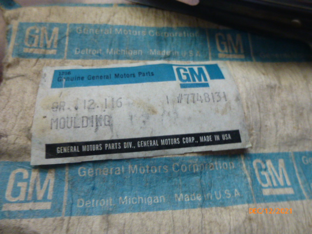

Can anybody with more resources than me help identify this molding? I have tried my GM books and Google with no results.

It is not listed in my '71 P & A Manual. By '68, p/ns were 7795xxx so it must be early '60s.

Look like this ?
https://bobsclassiccars.com/product/...-molding-trim/
Looks like the piece at the quarter window.

P & A lists those as 3941891 & 3941892.

Shows discontinued Nov 1990. All I have is Chevrolet catalogs. Maybe it's a different car line.....Joe

What of 2-Dr. Post cars or Canadian Beaumonts, different Part #'s?
~ Pete
That's what I'm thinking, or if the trim for 2 tone paint would be different than a vinyl roof ?? His piece certainly looks like it would be for some application like this.
