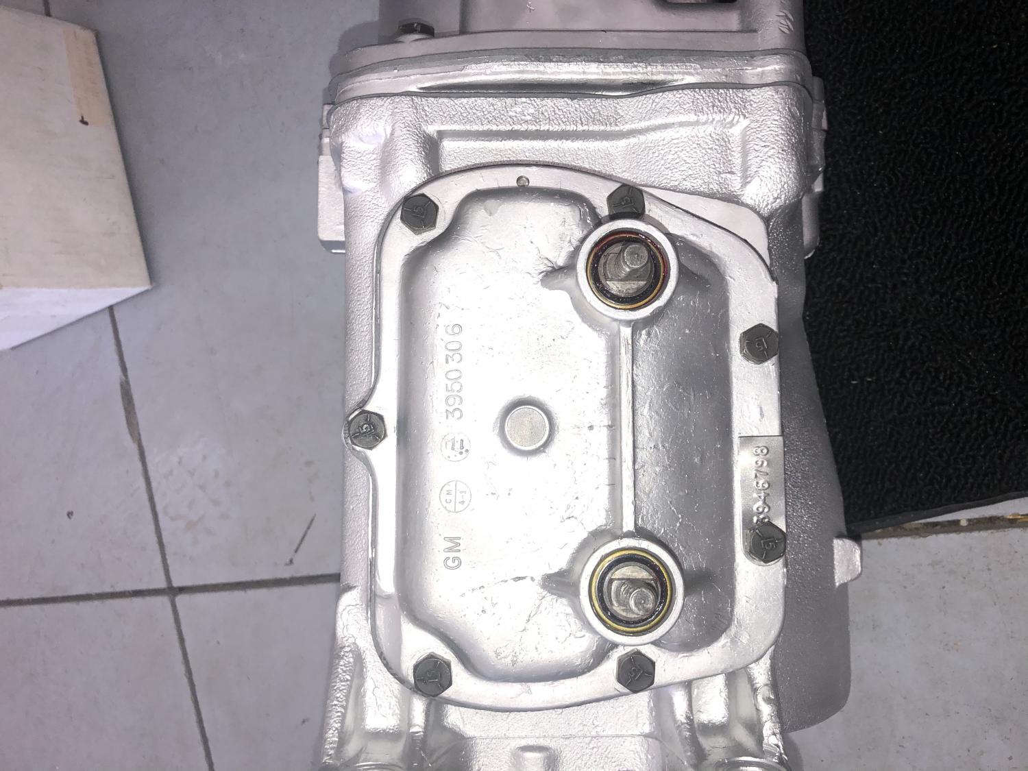

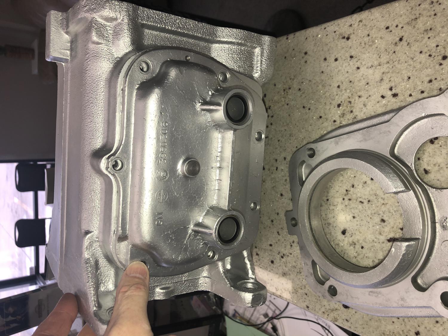

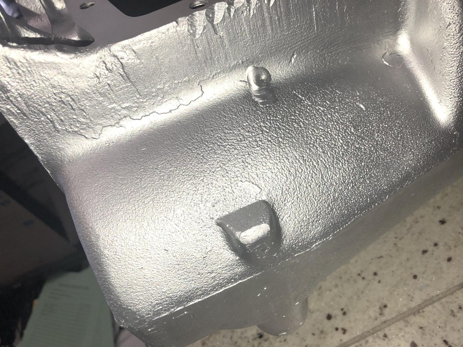

Originally Posted by napa68 View Post
Did you have the case and tailshaft in a vibrator?
This one I did tumble in ceramic solvent bath after soft glass bead and then steel shot tumbled. Usually I skip the solvent because the results are good but slight.

Originally Posted by Mr70 View Post
And Prince Albert in a can?
Nothing but compressed air sprayed on this trans.
