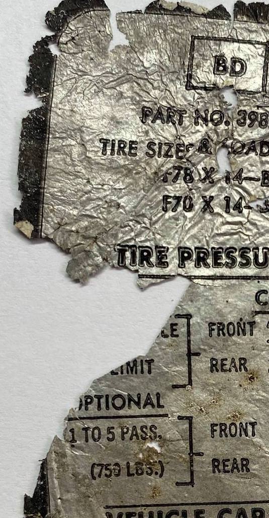

Something I worked on a few years back.

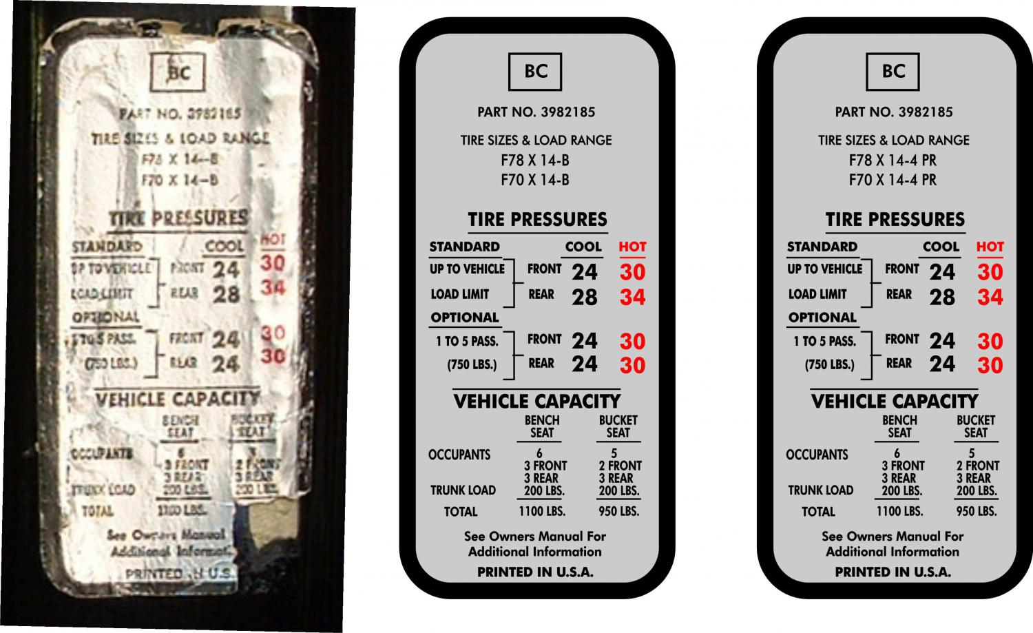

More.

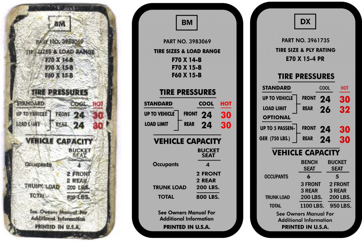

I was an Art Director in NYC advertising agencies for many many MANY years and have done a lot of print. I'm **just** old enough to have experience photo-setting type at the start of my career. As such, the dirth of quality decals out there has sent me on this path. Here is a coolant label I did compared to a surviving original. (on second look, that is not the final version as I fixed the size of the date.)
