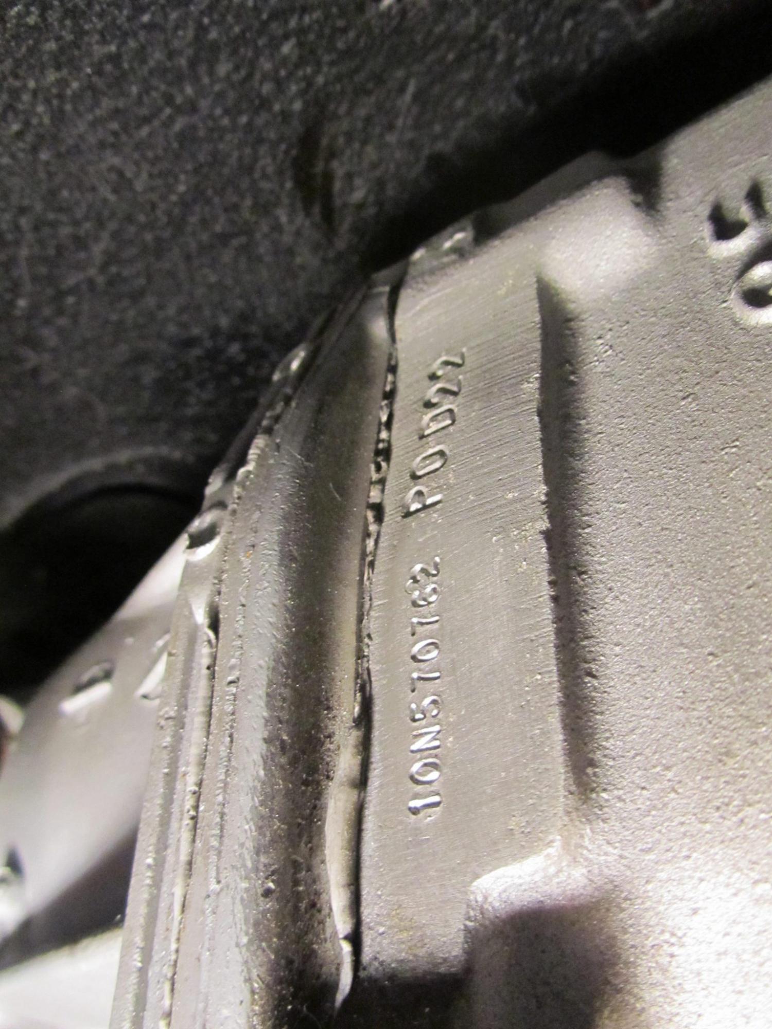

That transmission stamping looks like a restamp to me. The area where the numbers are stamped has been messed with.I also think an April dated trans is quite a bit too early for this 06B car
Heres the stamping in question:
