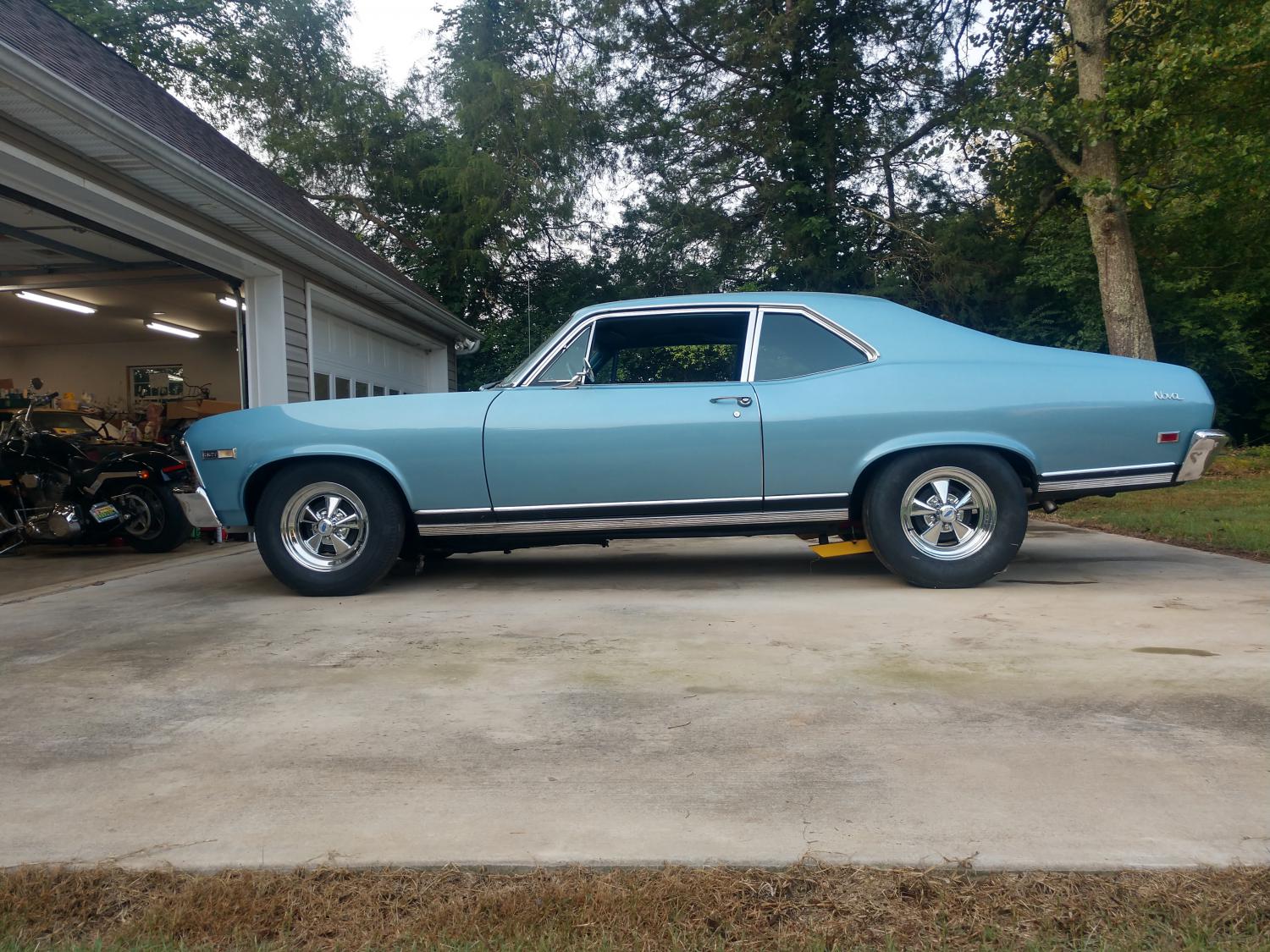

This isn't a great picture but I bought a set of new direct drill cragars for the Nova. 15x4 1/2 & 15x7. Only a handful of people would know the difference between these and a 50 yr old cragars other than the rust on the old ones. I have original round spoke on another car. I like these alot too though.

What size tires are you using? Are they pro trac? Thanks Earl

Come on Tommy…we need more pics! Looks awesome!

The front appear to be Firestone pie crusts from Coker and size looks like 6.40.15. The rears almost look like drag radials but I'd say those are M&H from the looks of them. Definitely not Pro Tracs.

The fronts are Coker 6.40-15. a Firestone deluxe champion. The rear are M&H J60-15. Here's a pic with the engine installed. It brought the front down where it should be.
