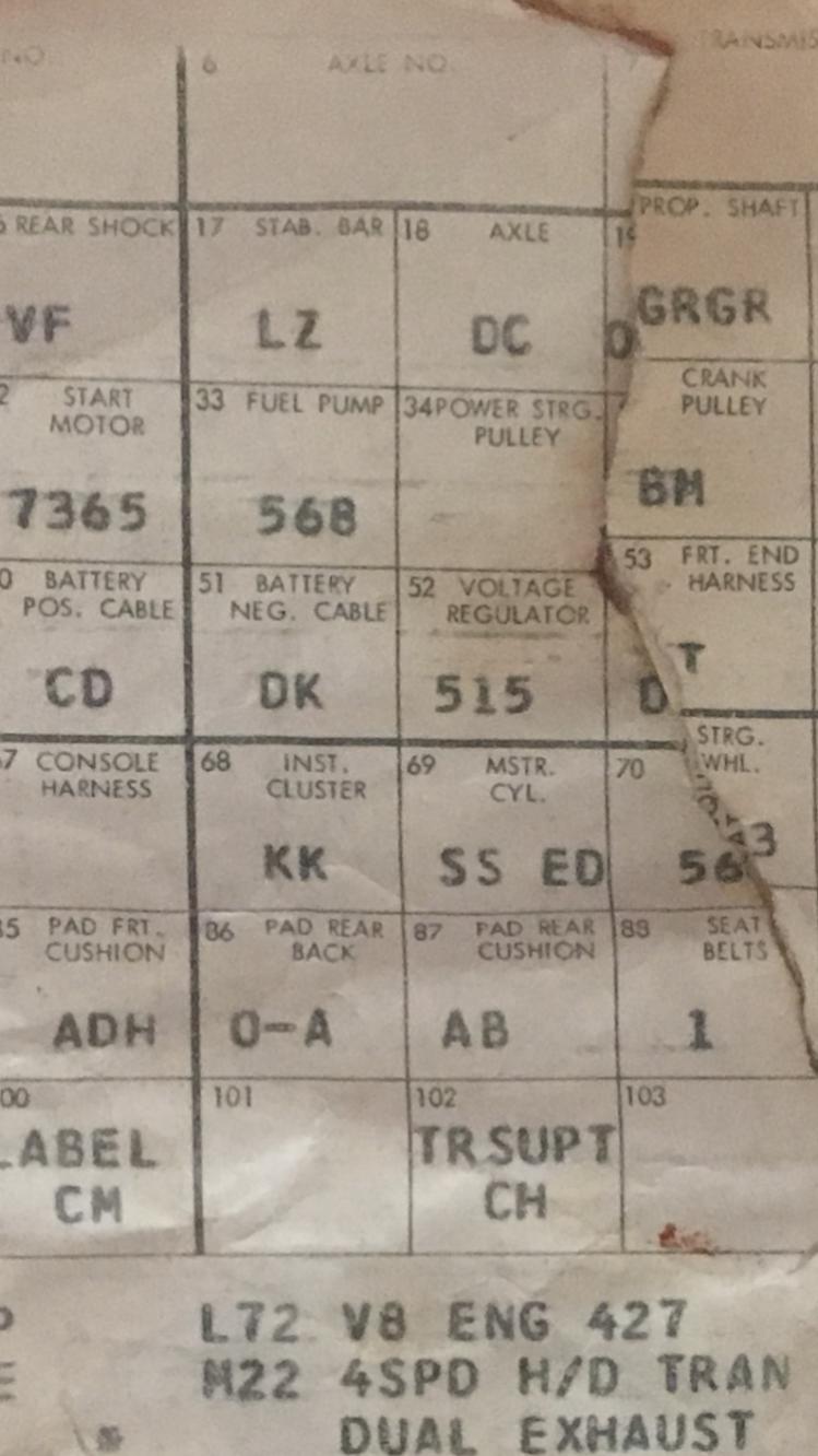

I need a AC Delco 40568 fuel pump for my 68 L72 Biscayne, NOS or a good core to rebuild. Thanks, Dave.

From my research the 68 uses a 40468 & the 40470 for the 396. There's no mention of the 427 in the information I sent PM. The 40568 was used on 1969.....Joe

Here’s a photo of my build sheet.
That's cool. Thanks for sharing. I love learning things....Joe

40568 was also used in 68 for the 396. Here is the 68 Camaro AIM.
