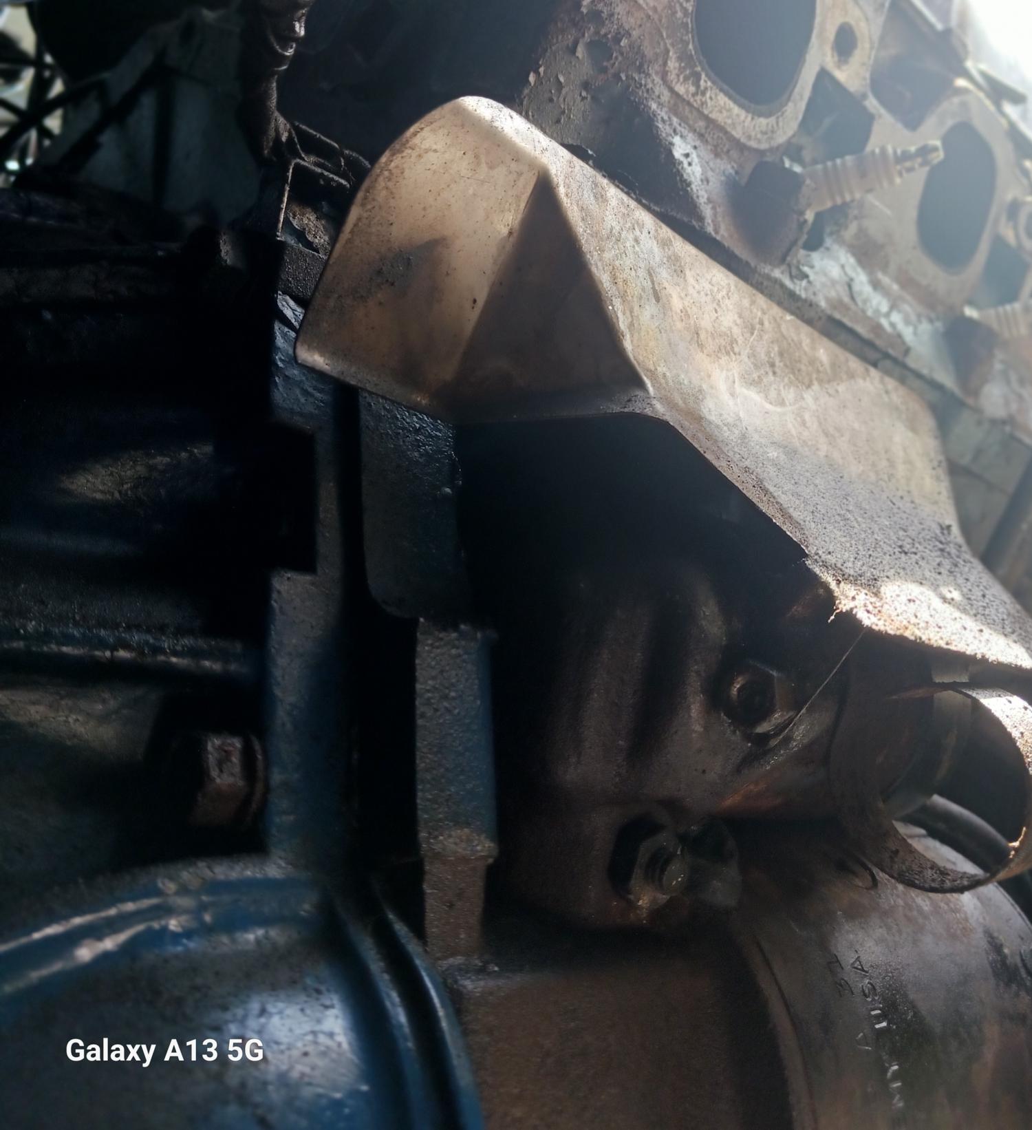

My 9 K 22 ...1108418 starter has Aluminum Nose Casting...
What application was this ????
Could this Sept Starter still have been used for late 69 Camaros ???
Thanks

Because it is a Rebuilt starter. 418 is cast iron as I have already explained this to you.
