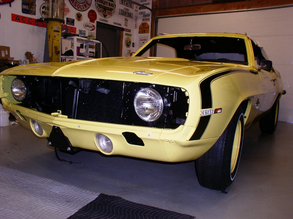

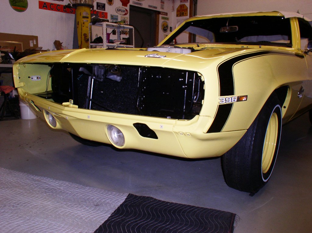

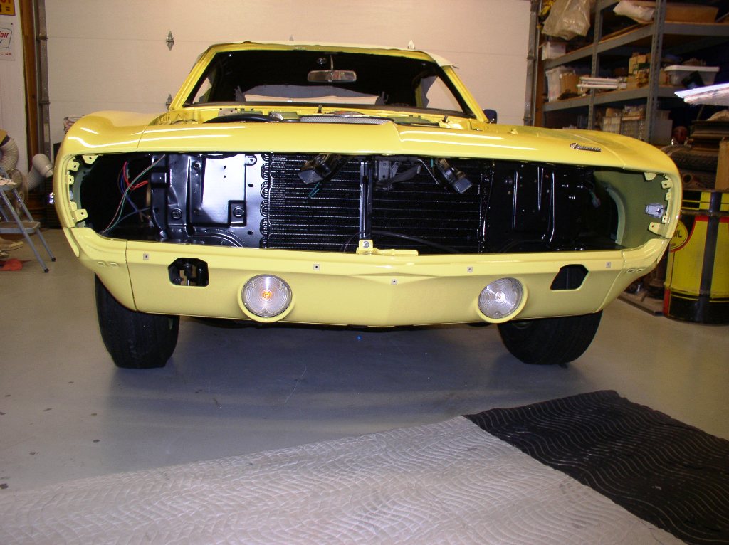

This piece most of you will never need but it's the baffle that was used on 396 a/c Camaros in 1969. My frame had all the holes but since the car was wrecked when it had only 16k miles, the replacement core support needed to have 3 holes drilled & tapped
