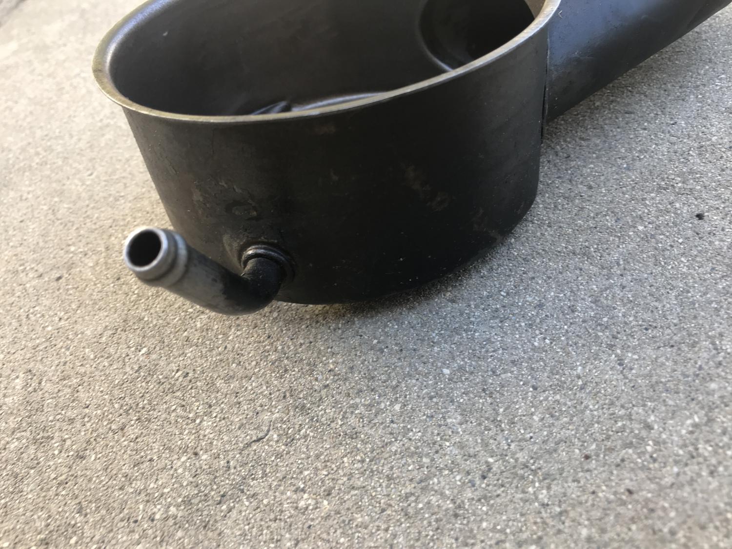

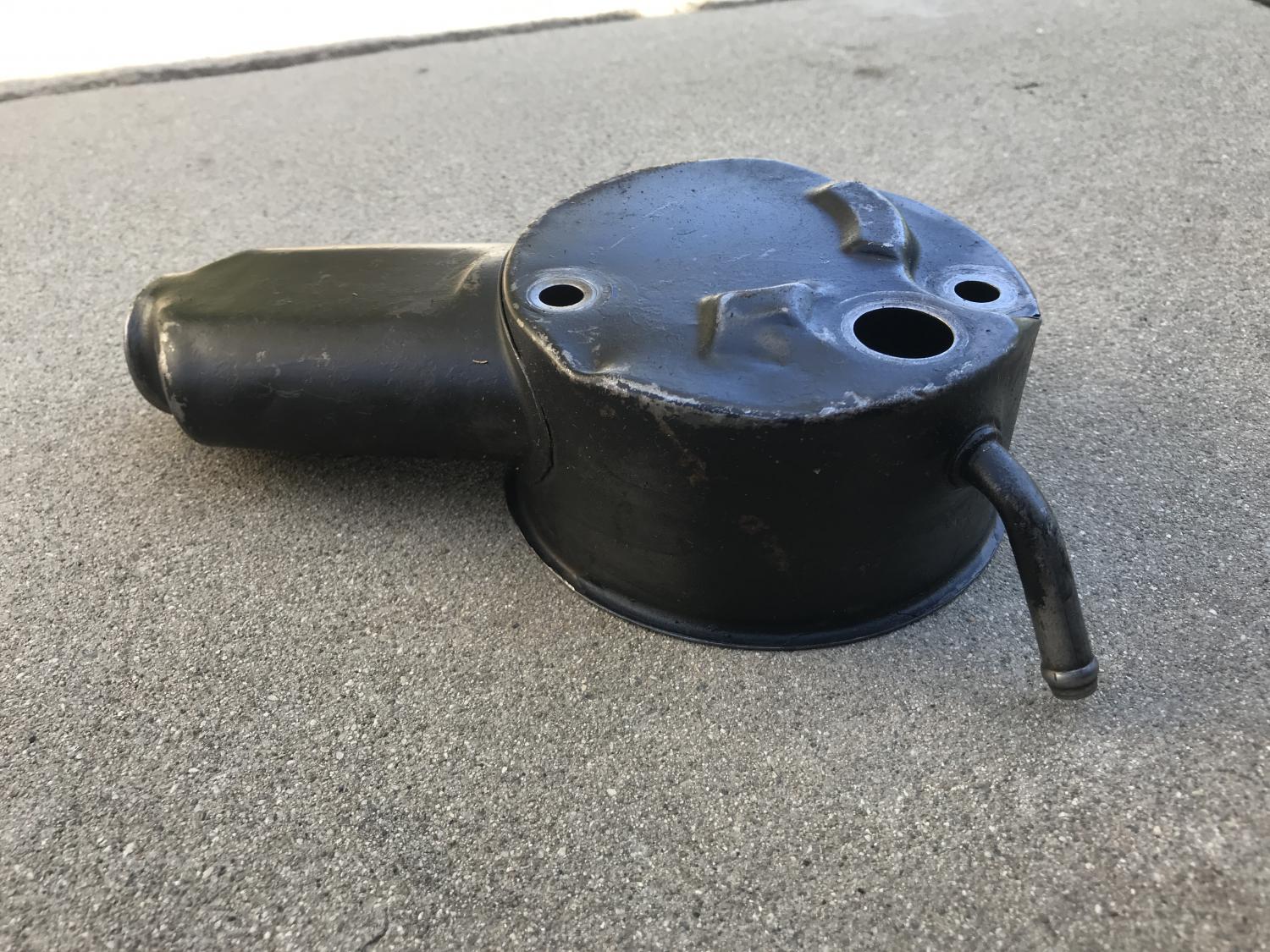

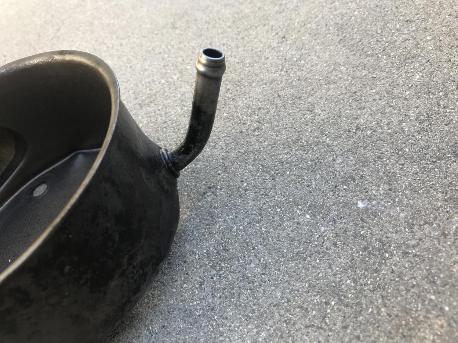

Originally Posted by Kurt S View Post
The power steering pump off a Cadillac looks a lot like the BB pump, but the inlet faces forward, fwiw.
Thanks Warren (and Bill)!
Like this I believe.
and yes, thanks Warren & Bill, very helpful.

Similar reservoir, taller tower. Caddy pumps I have seen in the past faced aft, as did the Chevy line-up. I might be missing something though.

OK, was just going by the above... I have no idea what it originally came off of but it fit nicely on my square body BB - the taller tower was helpful in that application, and yes, that is noticeable... it's listed for sale here too FYI everyone.
Cheers, and always nice to share information!
