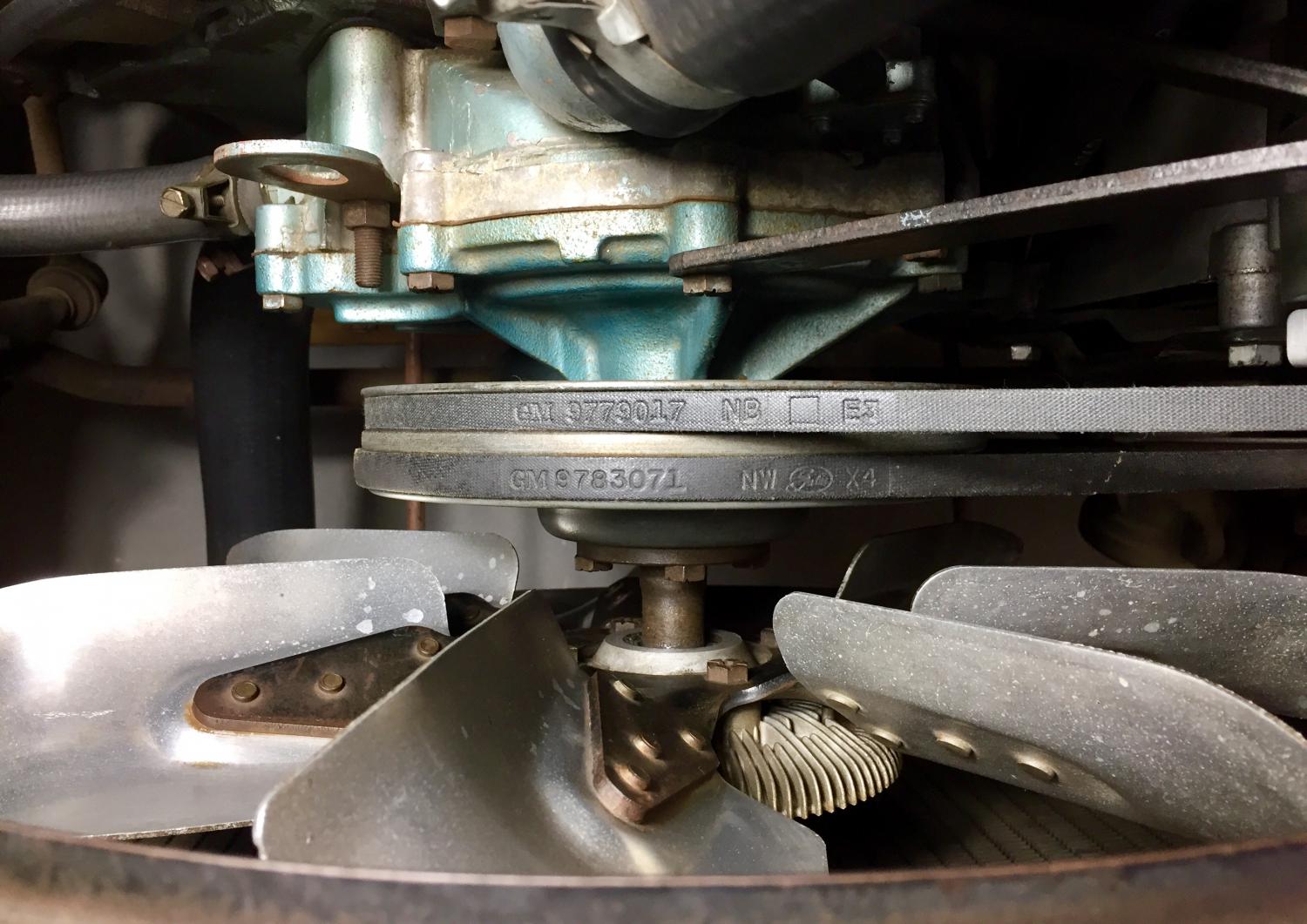

Not much to choose from in the way of correct fan belts, unless you get lucky finding an NOS belt.
Quanta is who I’ve used on my Survivors (anything rubber needs attention on the old cars), BUT, they are flippers / rollers.
Whenever I opened all 6 barrels on my ‘66 GTO the Quanta belts would take off.
The photo below shows the 9017 flipper and an NOS 3071 that stays put.
Show and cruiser use only with the repros.
