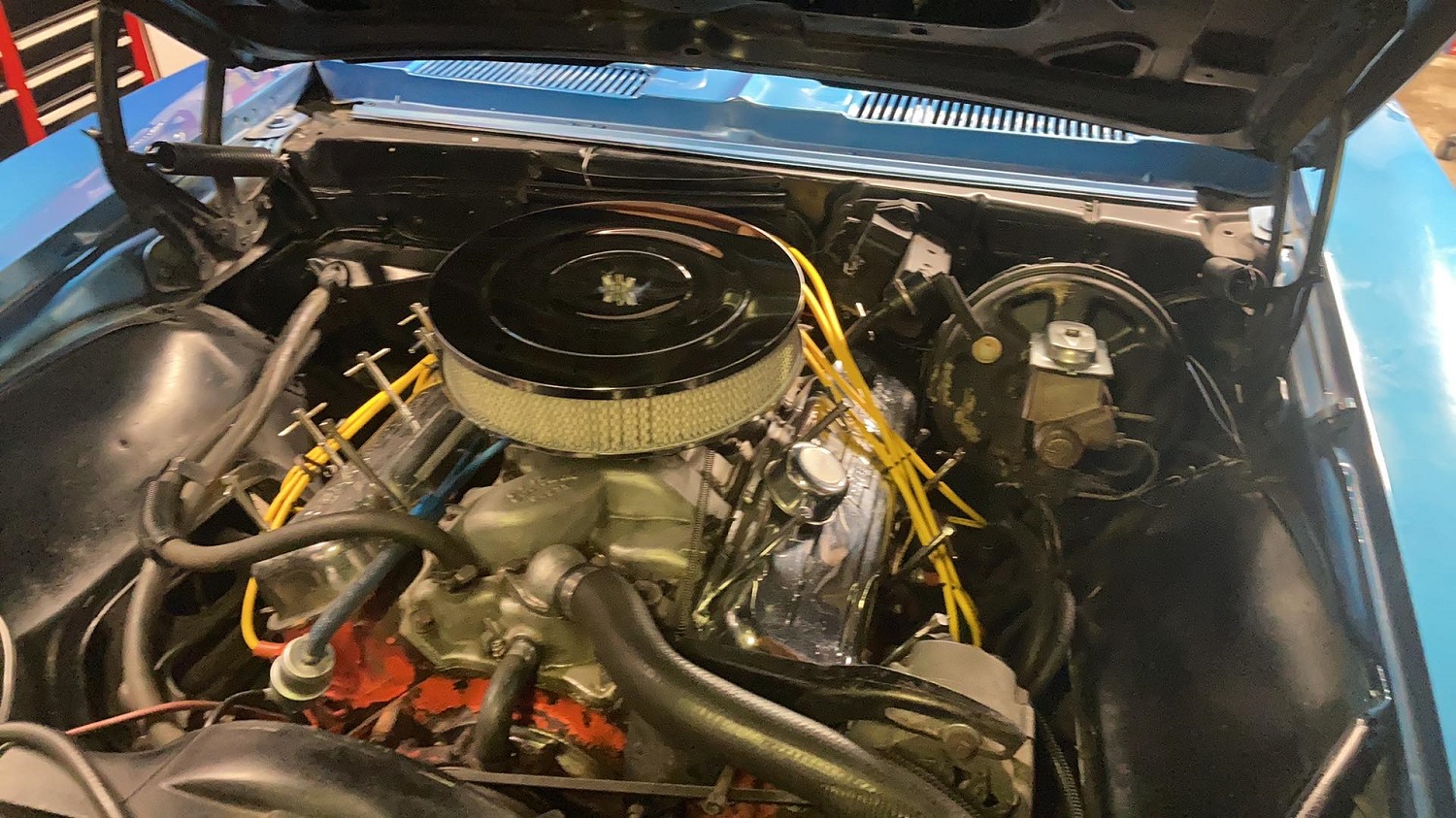

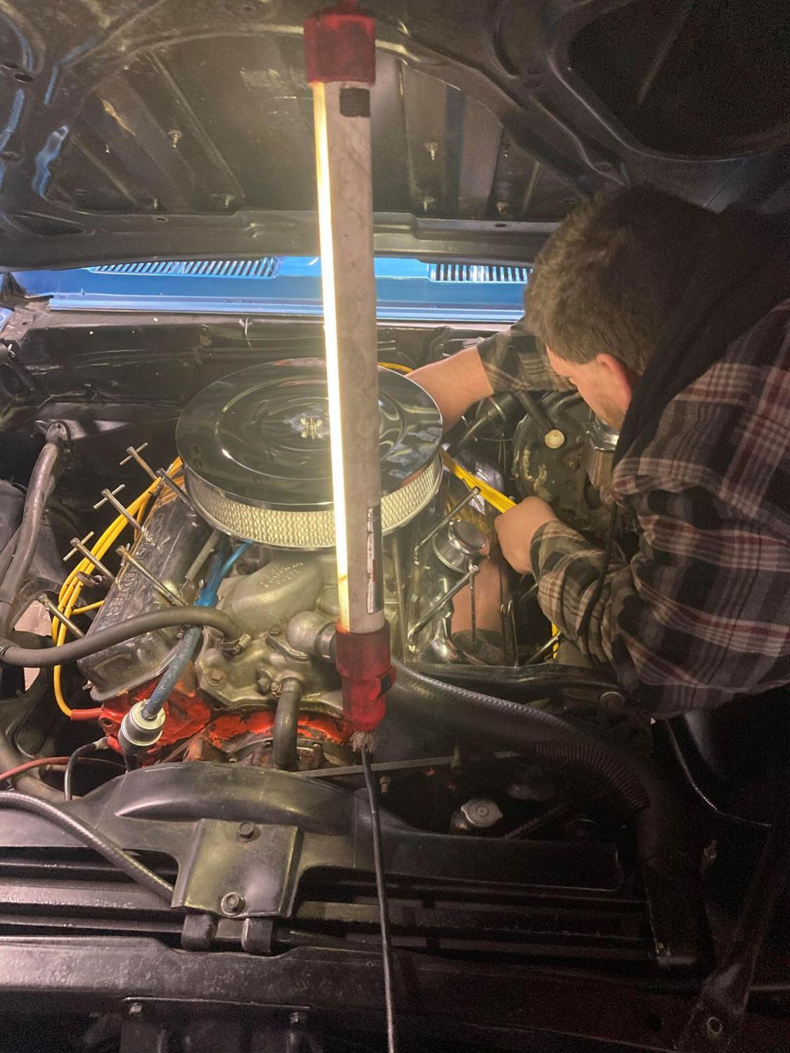

Who says the youth don't do anything these days? Got a set of Accel plug wires for Christmas, so today my friend Darren and I put em together and put em on. Tomorrow I'm ordering valve covers for it (M/Ts, baby!) and I'll at least see if any valves are loose even though I'm not qualified to fix them.
Why am I doing all this if it just has to be disassembled again? Simple. Morale.
