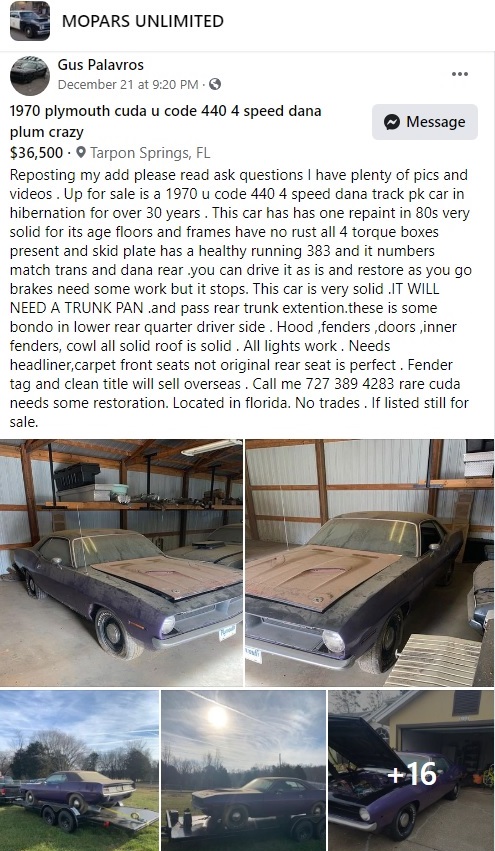

OK, where's Dave? We need to start on Purple Part Deux:
I found this one on facebook (I posted more info in the ebay sales section of this site). https://www.yenko.net/forum/showthre...46#post1528346
A very rare: 334 built - 440 4bbl, 4-speed FC-7 purple cuda down in Florida. Looks like a really neat car and it was built one day before, and 4,000 or so VINs away from my purple cuda.
Somebody buy this!
