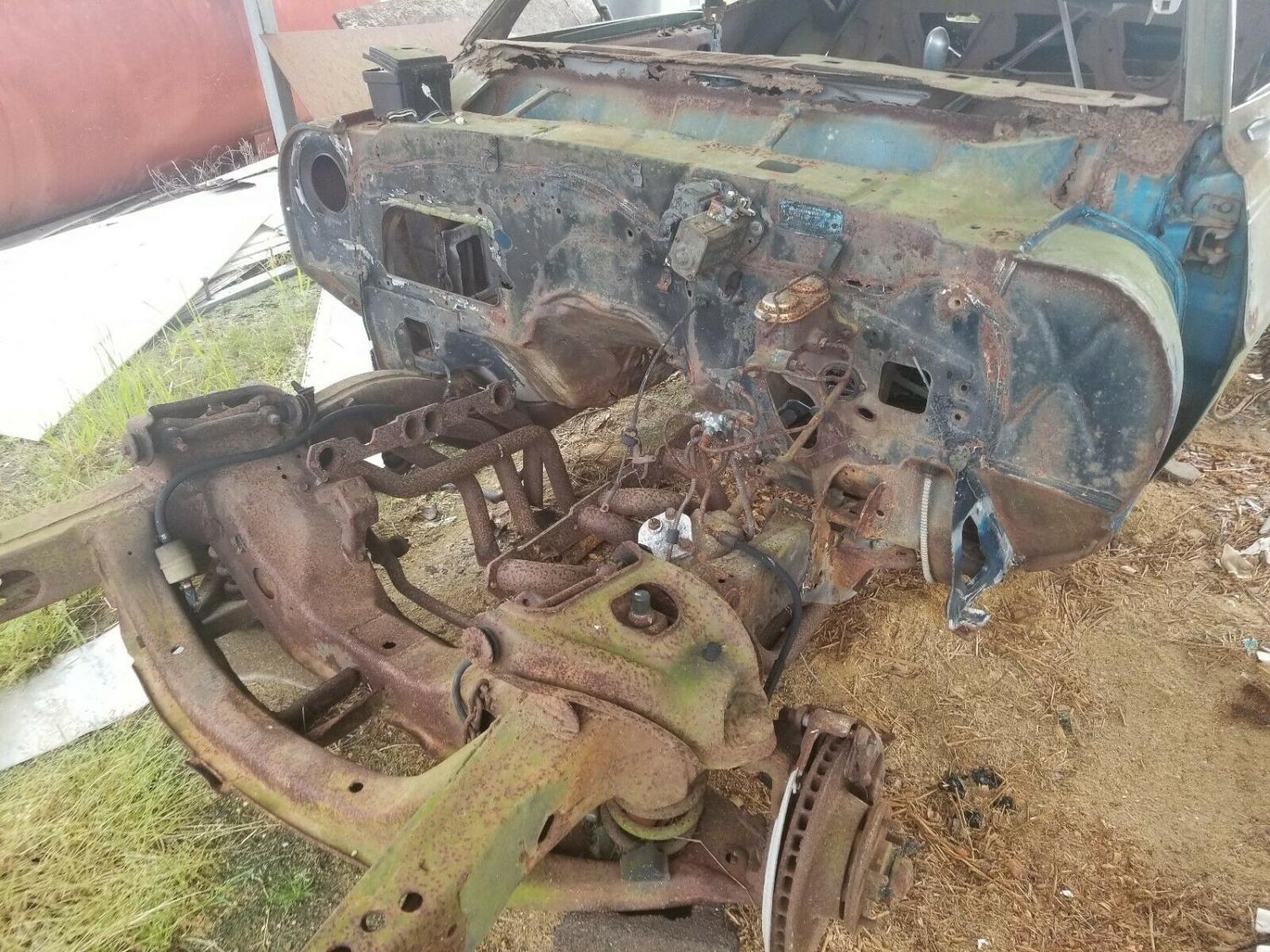

Drum master cylinder. Pluses are possible single fuel line. The rockers look ok so the rails may be ok. Looks like it had a vinyl top at one time. I'd take it if it was a BBC car and not twisted from a wreck. I wish the seller would post the trim tag, frame rail pics etc..

Isnt that a 6cyl throttle cable coming out of the firewall??
