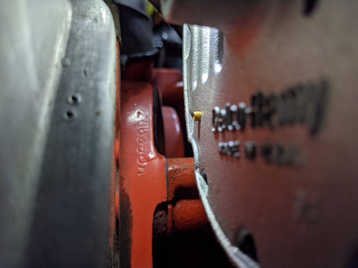

Wrong stripe color [should be black] should have 1st design rear spoiler and early headrests, ducted hood was added, missing Camaro emblem on upper grille panel. Front fenders fit poorly.
Headers, muffler shop exhaust, missing AIR system, aftermarket suspension mods, repro booster, incorrect alternator. Should not have trunk mat. Several painted or incorrect fasteners.
Not convinced that is the original engine. Never seen an early car [Sept ‘68] with the VIN stamp on the side. Pad needs to have paint removed. Like to see a better pic but window sticker looks real.

Window sticker probably is. Protect-O-Plates can be perfectly duplicated so I don't give them much credence these days.

It would confirm that 124379N507016 was configured as a Z/28. How much of it remains needs to be determined.
