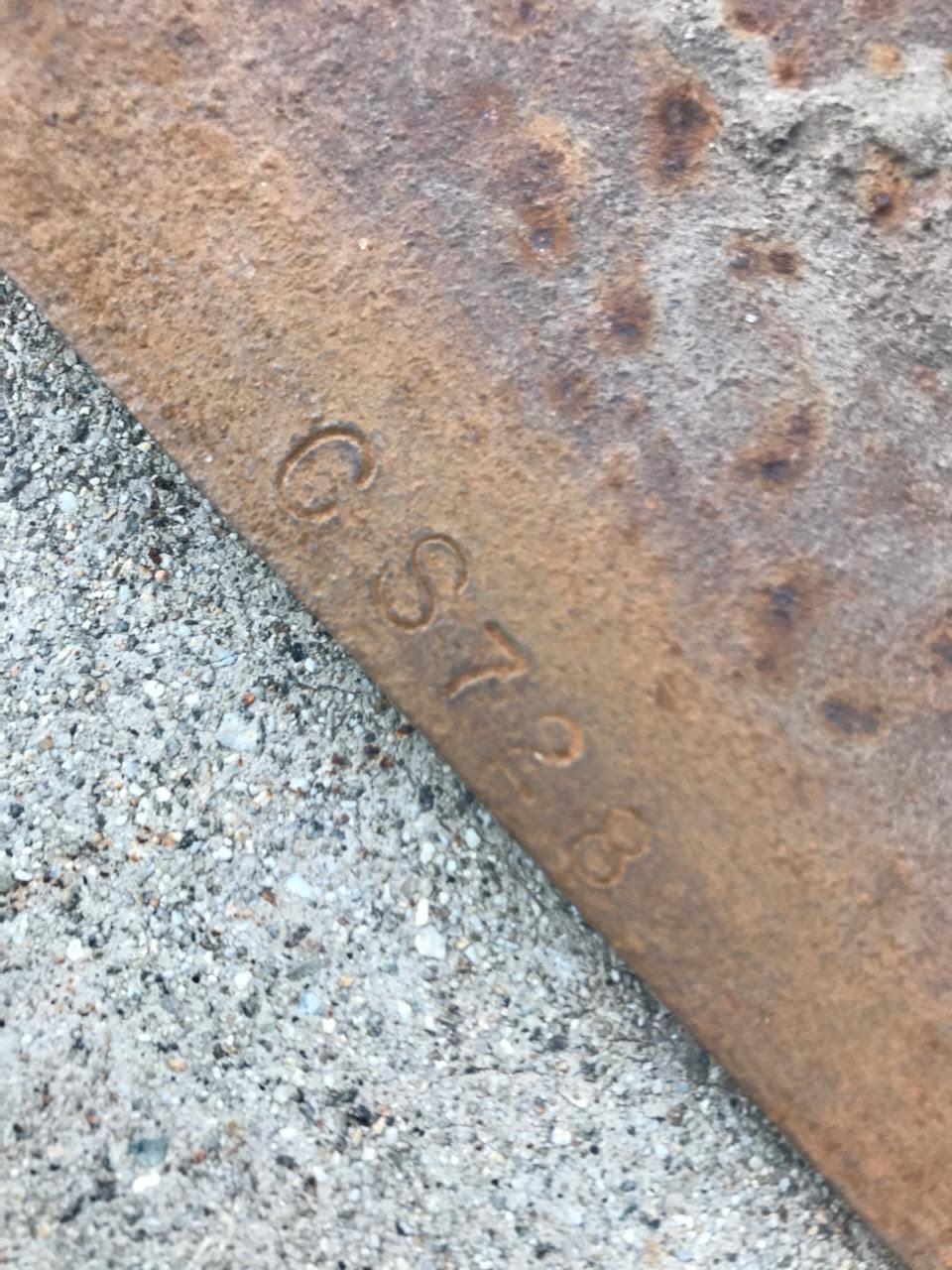

Originally Posted by 1967Z28 View Post
Bill Thomas has Hobrecht roll bars listed in his 1970 catalog. Do you see a part number stamped on this one? The bar you have does not look like one that would fit a Camaro floor pan so it's interesting that you say it came out of a '68 Z.
I believed the person the roll bar came from and he still has the car. I will definitely take a look for numbers on the bar. Do you mind posting the numbers or photo from the catalog? Thanks. If it turns out its not a match I could always let it go.

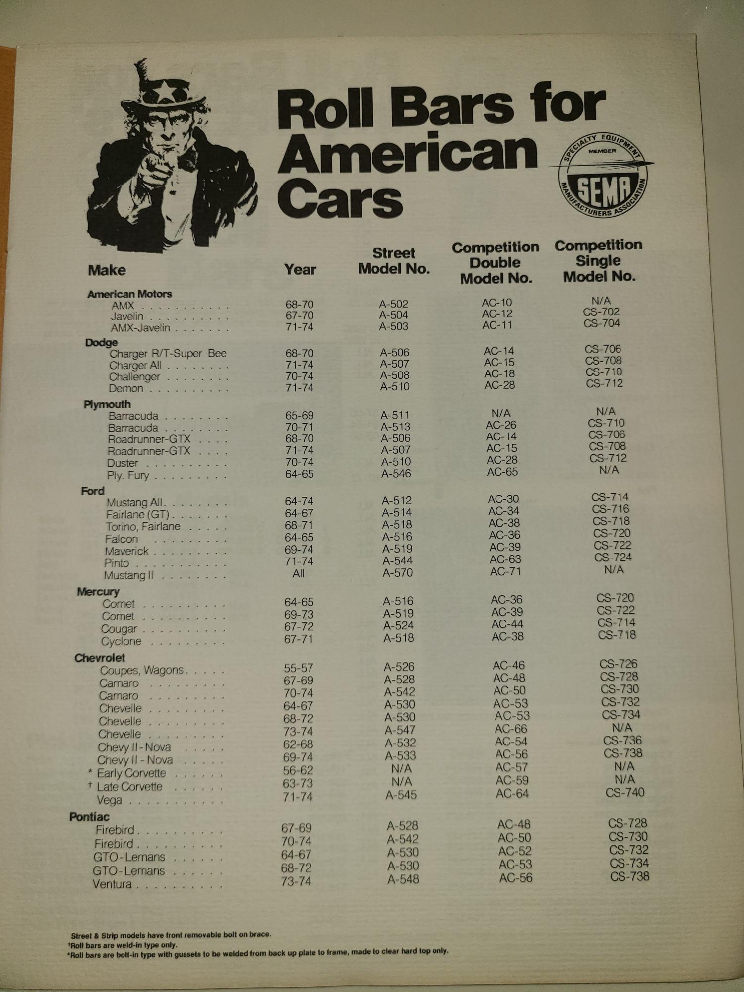

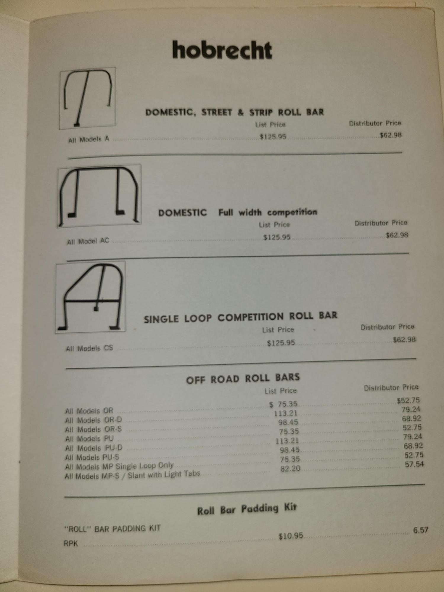

Update: With the help of Russell (mr.4speed) and Anthony (AnthonyS) we were able to determine the roll bar will fit like a glove!
Also, I found a 1974 Hobrecht Catalog that confirms the roll bar is a real deal competition bar for 1967-1969 Camaro part CS728!
Jose Betancourt
67 Camaro L78

That’s great!
And thanks for sharing that whole page of part numbers; that may help a lot of people identify bars.

I have a Hobrecht single loop competition bar, now I may be able to figure out what application it was meant for. Thanks for posting the info!!
Jose, where on the bar did you find the part number?
You are welcome. Should be on one of the baseplates. You will also see a HOBRECHT stamp. I'm going to post the full catalog soon in the Day2/Modified Stuff section.
