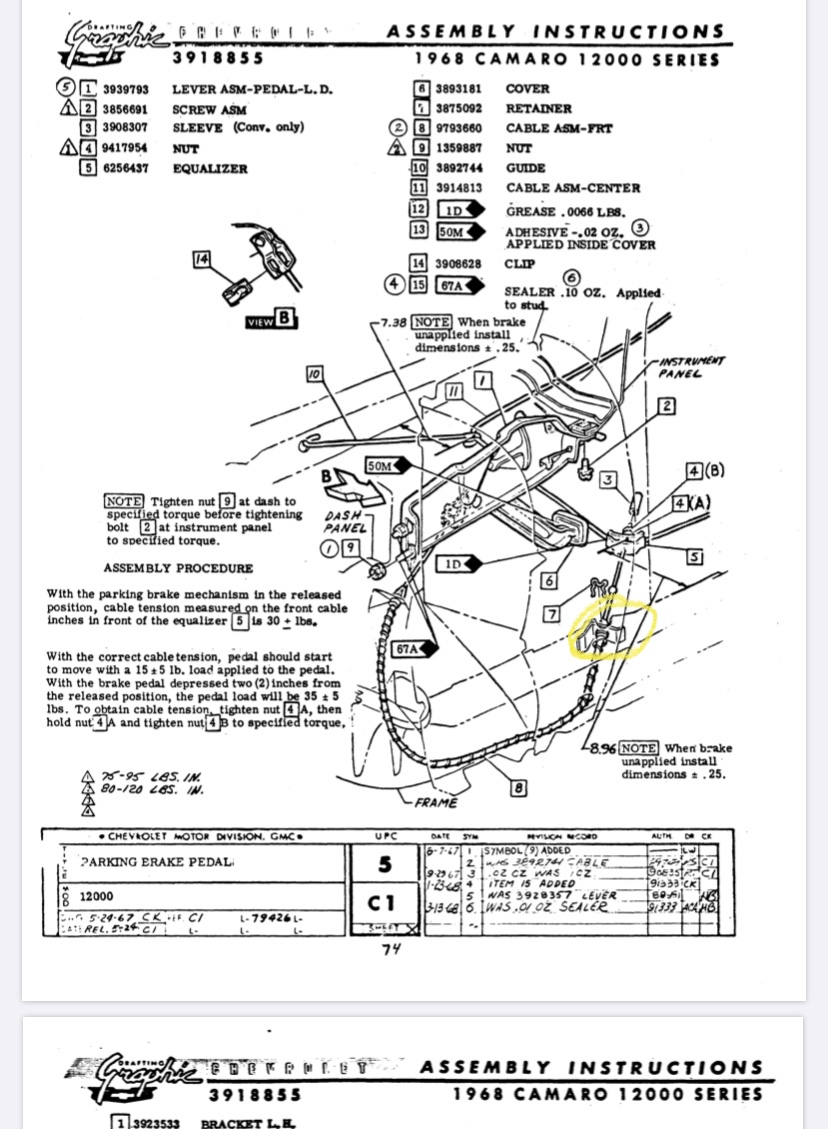

Need this piece for 68 Camaro to secure the e-brake cable. Thanks.

That is welded to the subframe originally. Is it missing?

Yes. The car had subframe connectors and I think it was cut off as part of that modification back in the day.

You could make one out of 3/16- 1/4" strap, unless you need 100% accurate.

SMS. Do you still need one? I have one I could cut off....Joe 520-490-6093

Yes Joe, that would be great.

Thanks Yenko forum and X66 714. Really appreciate the first rate effort on this one. Joe cut up a subframe to help me out.

Thanks Joe for this effort. I didn't have any trouble duplicating the crappy factory weld, kinda came naturally.
