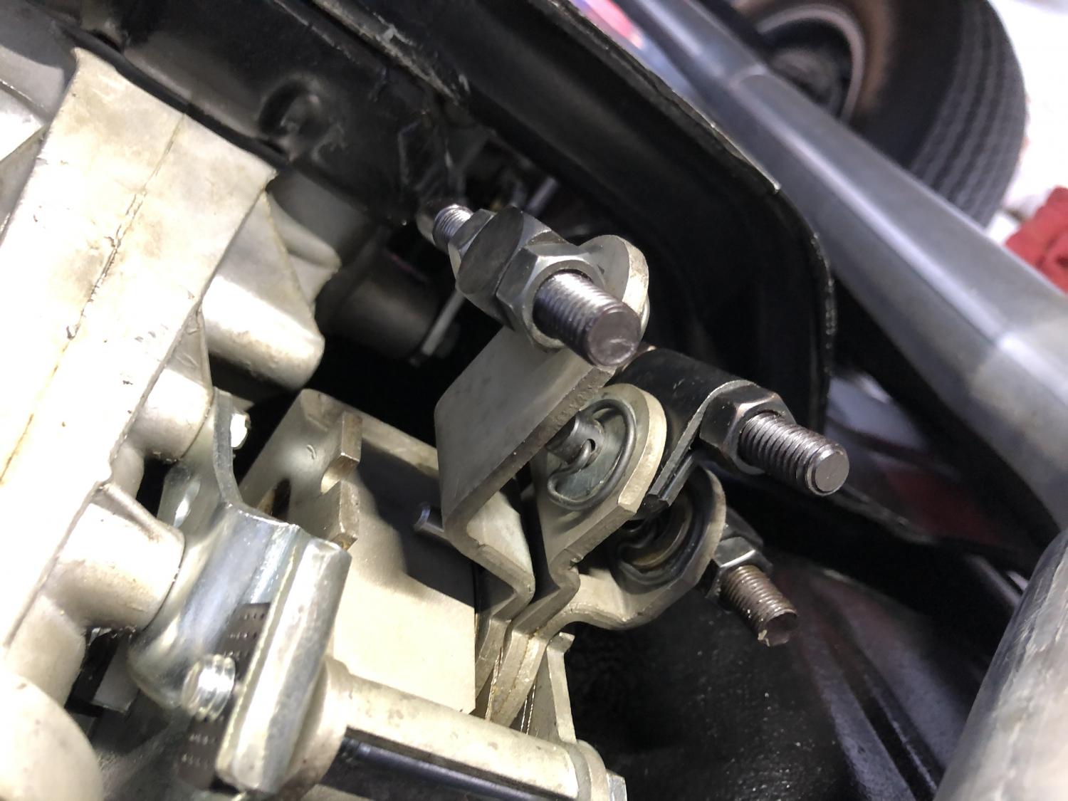

You are probably missing the reverse lock-out rod. If you do not twist it after starting the car your reverse lights will stay on. If you twist it after engine is started reverse light will go off, but you will not be able to remove ignition key until you twist it back to the reverse position.

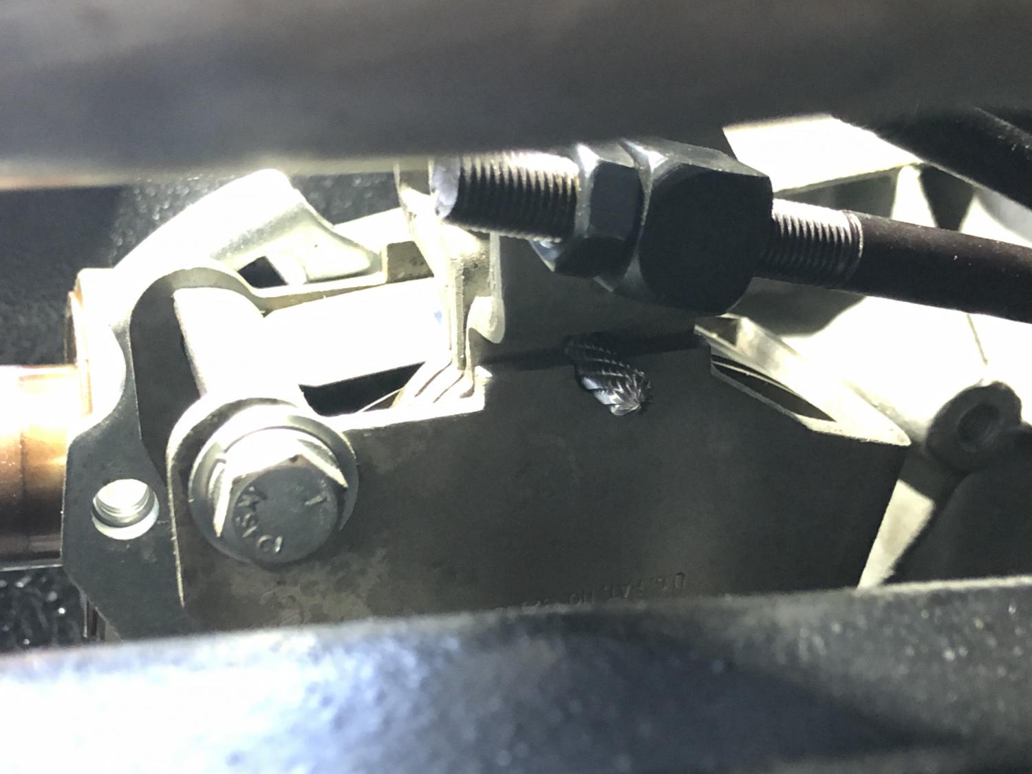

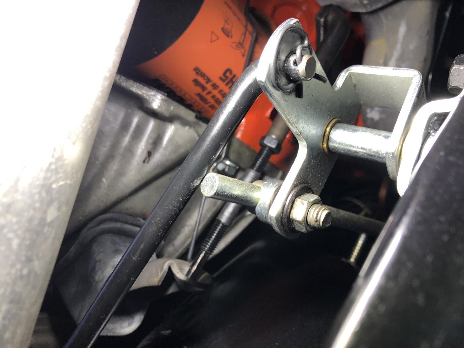

As it turns out, the reverse rod was two rotations out of adjustment. Got the car up on jack stands and used a carbide bit as a 1/4” pin to get the Hurst linkages adjusted. Now it shifts like new
Did not know until now that it’s adjusted that the steering column jacket is supposed to rotate when you shift into reverse. Today I learned...
