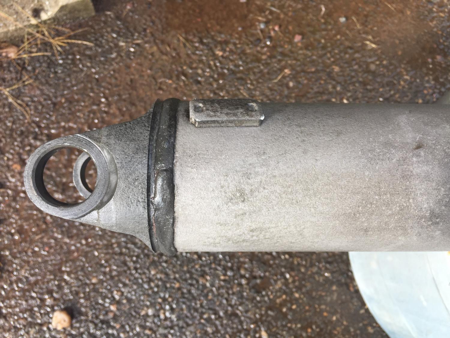

Seeing Steve mention soaking a driveshaft in a PVC tube of Evaporust made me wonder what other tips you folks have used to derust your projects. I'm in the process of derusting my Canadian L78 Camaro and some of the larger parts are tough to accommodate without wasting gallons of the stuff. I'd love to see any inventive ways you've developed...thanks!

I'm getting ready to do my hood hinges. I would probably get a blanket storage container at Target. I purchase a 5 gallon on e-bay. Cheaper & free delivery. It stays better if you can put a lid on it. I did my driveshaft with a 4" pvc & caps on both ends. With new product it was over night & it looked like brand new tubing. It was an Arizona car so that too is different. I have small containers for small items. When the product gets old, I just change it....Joe

Get several sizes of pvc tubing for things from drive shafts to ebrake cables. Also, when using pvc for this process, stand it up in a 5-gallon bucket, just in case you didn't get a full glue seal on your cap - I learned the hard way and had to wipe up $20 worth of evaporust off my garage floor. I've also used heavy 6 mil industrial trash bags as evaporust containers. You can tie them tight to the part to reduce volume of Evaporust needed to do the job. Same as pvc/bucket trick, place it in a large plastic tub before walking away in case your part pokes a hole in the trash bag.

I've used about 20 gallons of it in the past couple years and I'm ready for a new 5 gallon pail real soon. I buy it from Fastenal and have all kinds of different containers that I use it in. Get your hands on a long shallow goat feeding trough or window planters for those long items you want to soak. As above, you can get creative with 3" or 4" tubing with end caps glued on.
