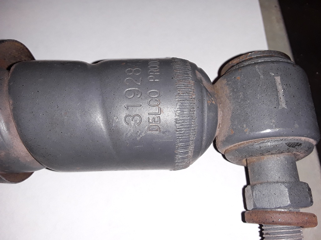

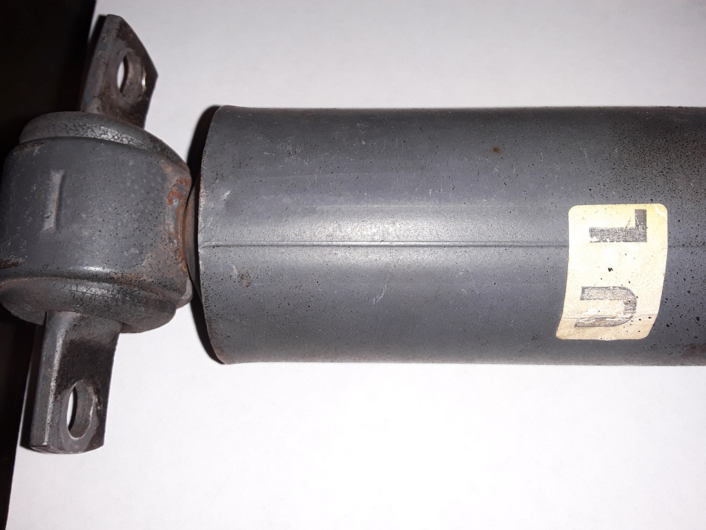

Shock paint color. I assume the black specks are undercoating overspray. Good luck !

From my experience, although jack bases and shocks are both technically Dove Gray, I've found survivor shocks to be slightly darker than dove gray. From the photos provided by Wayne and Don, that seems to be the case with their examples, too.
Maybe someone here on the board has a custom Dove Gray formula they'd share for shocks?
The difference in color to my eyes could have something to do with shocks typically being exposed to the elements? Has anyone else experienced Dove Gray looking different on jack bases and shocks with survivor cars?

The shocks are a darker shade of gray, not Dove Gray. They do sell the correct shade of gray in a can for the shocks. Dove Gray for the jack base and hook could be a little harder to find. Krylon sold Dove Gray a while back, may still find some at the Home Stores or Hardware stores.
