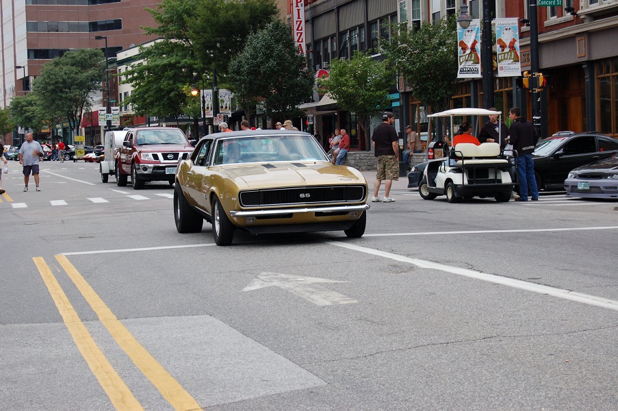

28 x 13,50 x 15 ET streets on 8" 4.5 backspacing. Comp engineering crossmember that move shocks inboard and rear of axle. And a liiiiittle massaging on inner wheel wells.

Sweet Camaro. Nice slope to the car too.

I'm not really a "Camaro guy", but that one just has 'THAT LOOK"!!!!!!!!!!!!
Congrads
How do you like the 28 x 13.5's? I have 28 x 12.5's on my Chevy II and can go 14.

Had them on 2 cars, no need for slicks at the track anymore.
