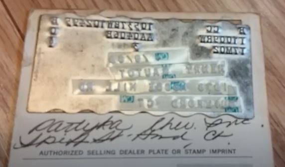

But the issue of a mismatched POP to a warranty card is really not that rare.
In this example video from 2018 we have a card with a clear mistake just like OP's but from an all together different assembly plant.
Here we have the critical screen shots showing the VIN on the POP and the VIN on the warranty book having the same kind of error as OP is inquiring about.

Short answer for OP:
Simple Human Error.
