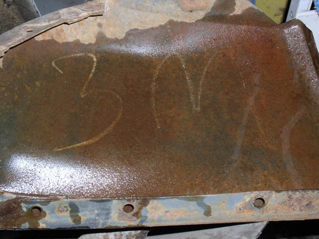

Box 104 on the BBC is for the fender emblem.
Very limited data indicates C for 307, E for 396, F for 350, G for Z/28, H for 327. Wonder why COPOs had 427 written there as they would have the same piercing and no engine ID emblem as the base 230" six cylinder.
Also, COPOs and Z/28s [non RS] have the same YA piercing code. Non HP cars are XA.
The scribbling on the extension may be tribal knowledge.
