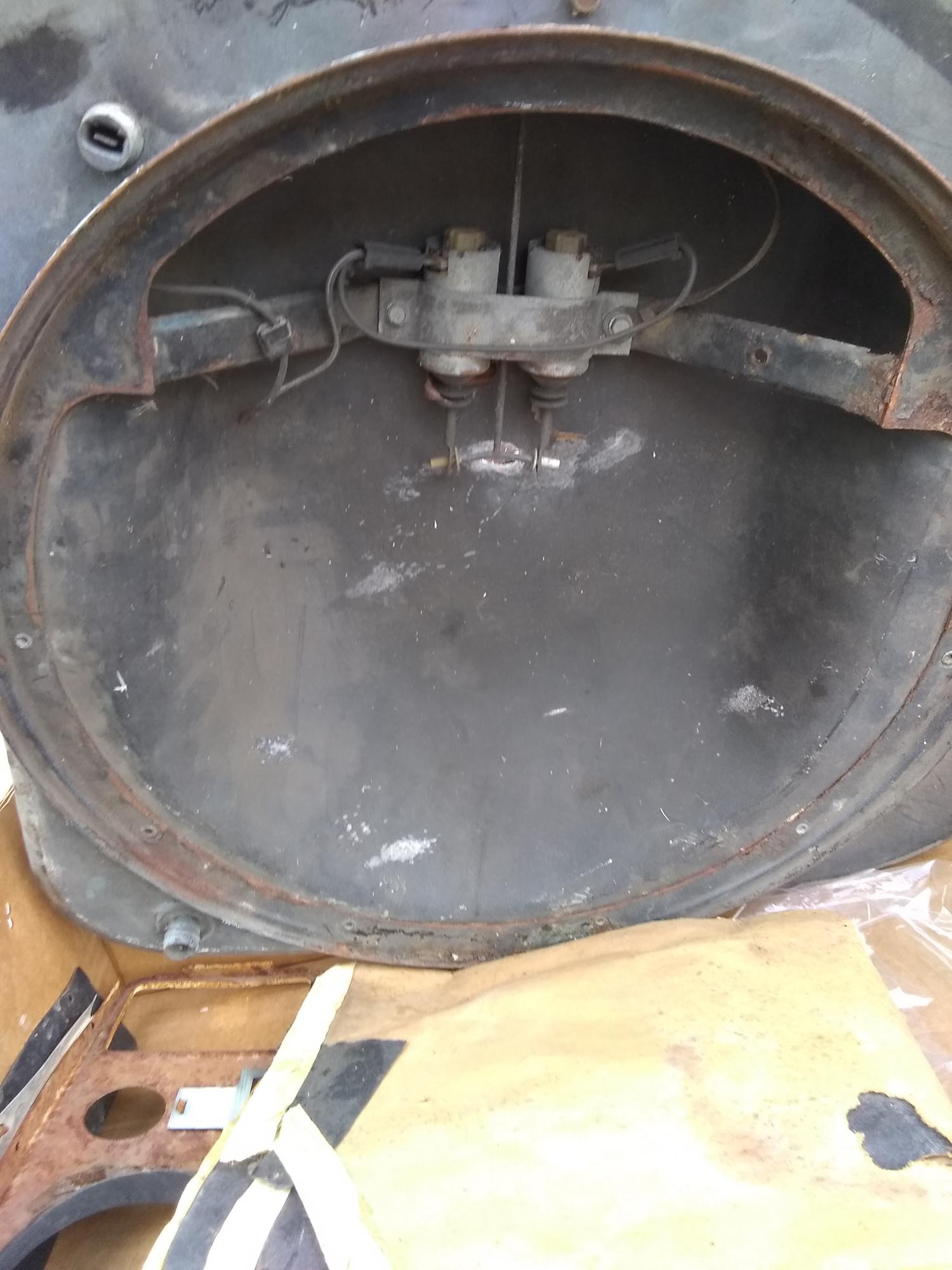

After cleaning up everything that was in the interior and stuffed in the trunk it was time to clean her off and put some of that sheet metal back where it belongs.
The whole underside of the car has been restored and sealed in red oxide primer. The original COZ 12 bolt rear end still resides in the original place. Here is a picture of the roll bar pads, still in place after all these years. |

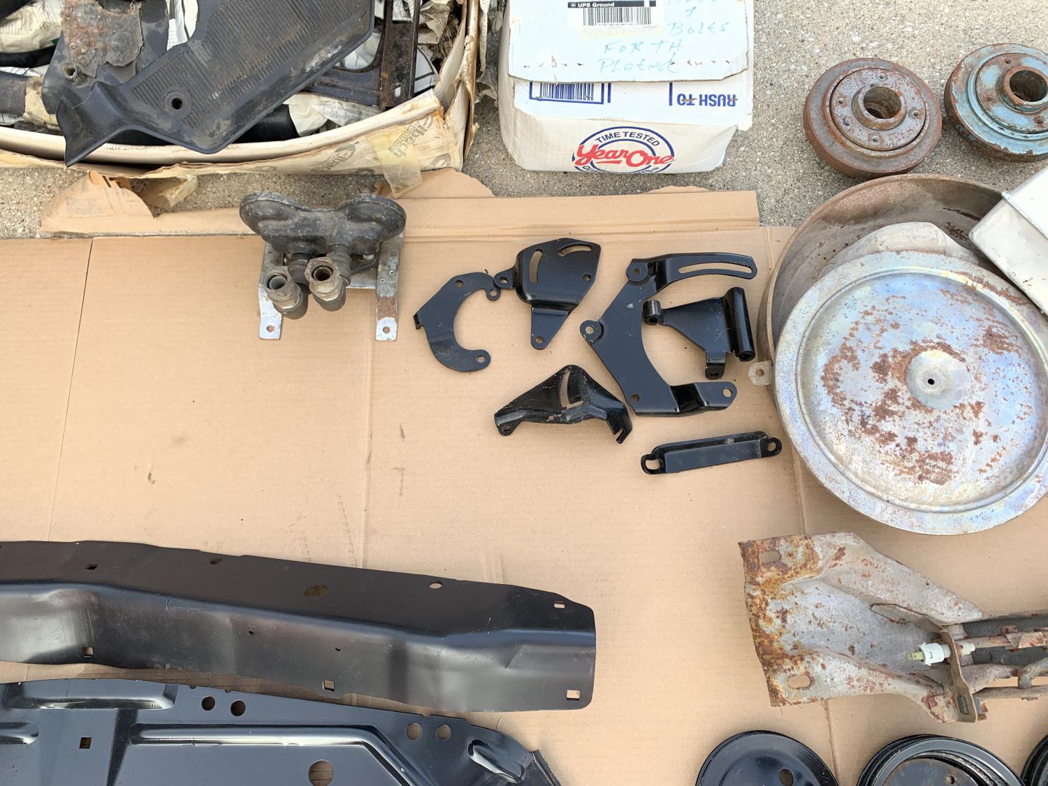

Here are a couple of shots of some of the original race car parts that were fabricated back in the day along with some of the aftermarket parts added to again either enhance the performance/reliability or dress the vehicle up during the time period.
Almost looks like two old aluminum bread pans welded together to create a fuel filter or fuel line cooling tank. The front SS braided brake lines. The M/T valve covers and unknown brand cast 12 bolt Chevy rear end cover. Probably one of the most important pieces in the upper right corner of the parts picture is the dual oil filter housing with very large feed and return lines. Looks like what appears to be a fabricated battery tray. Similar bar stock also holds the dual oil filter housing unit. |

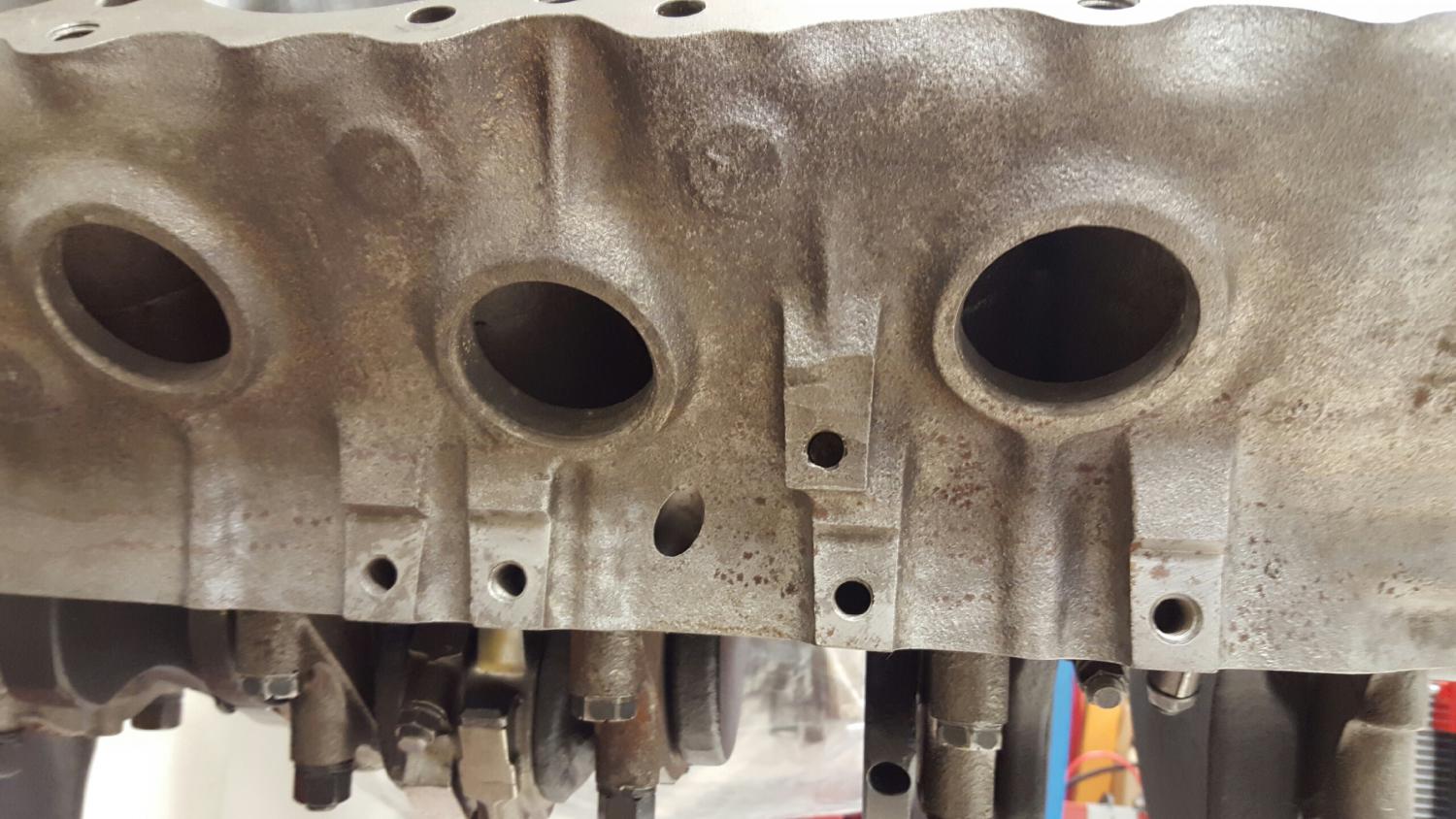

Here are the pictures of the 1112011 9G9 1970 Ram Air IV distributor with the Ram Air V distributor sleeve.
After talking with a bunch of great Pontiac historian's, racers and avid collectors it would seem that the reason behind this setup is for the following reasons. The Ram Air V program utilized the heavy duty 80 psi oil pump, to drive that oil pump the GM engineers discovered that they needed a larger diameter distributor gear to stabilize the timing and longevity of the cam gear. To do this they had to enlarge the distributor housing hole in the block. Since this engine does not have any tell tale signs of Ram Air V cylinder bore "chamfers" it would make more sense that the block and distributor combination were used to insure good oil pressure during acceleration, deceleration and wide open throttle runs with the Ram Air IV cylinder heads. If I may digress I have had the opportunity to drive both a 1970 GTO Judge Ram Air IV four speed with 4.33 rear gears as well as a couple of Ram Air V equipped vehicles. I can't imagine the power that a larger 455 cubic inch motor with the ram air IV heads would have produced back in 1970. I bet it has to be similar to a 455 with E-heads making north of 500 Hp. |

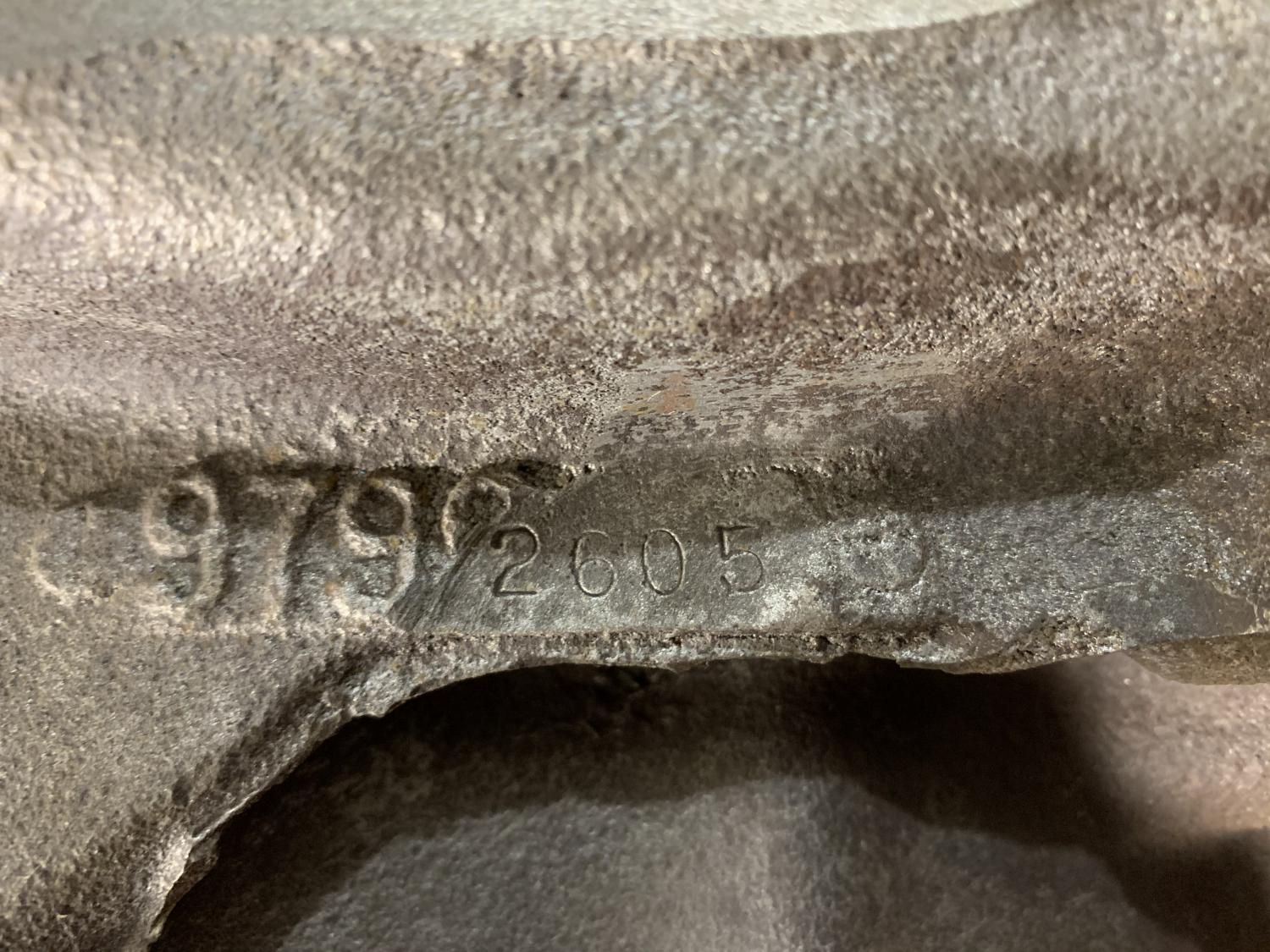

This is a very interesting part of the car and the history of what may have gone down back in the good ole days of parts and racing.
This is a 1969 400 block code WH Ram Air IV W/ manual transmission The EUN is 847453 The date code appears to be I 04 9 so September 4th of 1969 |
