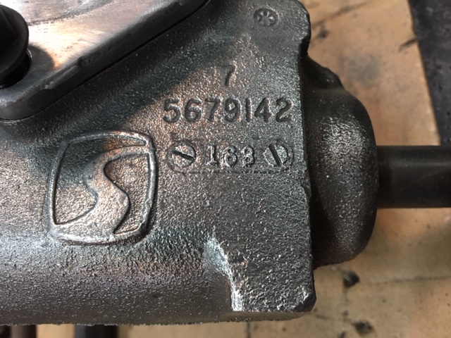

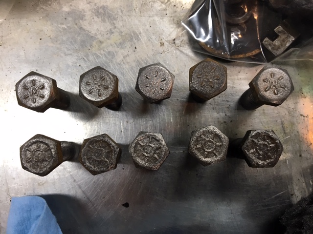

Got the manual steering box mostly cleaned up today - dated June 12. Also found what I believe to be an interesting assembly line thing. The bolts that hold the two-piece rotor together were different from one side of the car to the other.

Ref#189
Found my pic of the finished dustshields,,disreguard my steering box bolt markings,,old habit.

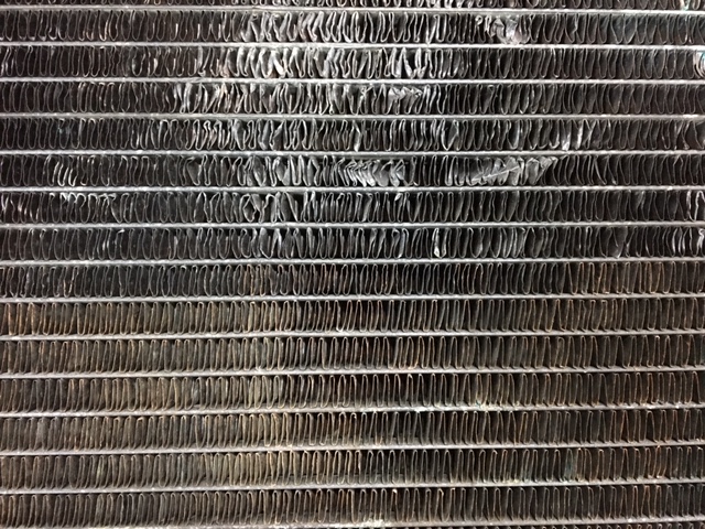

Default This one took a while.......
Finally wrapped up my radiator fin project. I think my needle nose hit every one of the 18,000+ fins on this critter Original core just had a few pin holes that needed repaired. It was a good project to pick away at while I waited for the compressor to cool down or some paint to dry. Here's some before/after pics....

Looks great.

Wow! Nice job��
Straightened mine using toothpicks, was a little leary of the needle nose. Only leaks,after pressure testing were a few pinholes around the solder joint, top hose.
Looking good.

Great job��
Used toothpicks for mine, was a little leary of needle nose. Gotta laugh, cause yea...tedious. Then you flip it over for the otherside. I lucked out and only found a few pinhole leaks around the solder, top hose.
Never leaked all the years it was in the car, but worth the time pressure checking prior to reassembly . If not,,guess how that turns out.

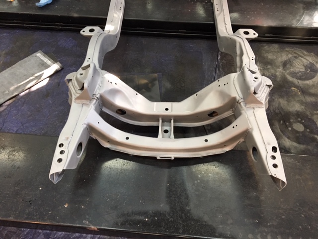

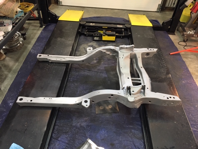

Default Front subframe update...
Got my front subframe back from a "bake" and bead blast session today. Turned out really nice and clean. Frame is in great shape with only minor pitting in a few places. Car should be getting some color on it in a few weeks. Won't be long and I can turn the ratchet the other direction and start putting this thing back together!

  #199
Old 02-08-2020, 12:21 PM
NorCam's Avatar
NorCam NorCam is offline
Join Date: Feb 2015
Location: Alberta, Canada
Posts: 4,239
Thanks: 2,771
It's looking really good. I always love the look of a freshly restored subframe when it's all going back together. Painting or powder coating the subframe? Body is looking close to having color.
