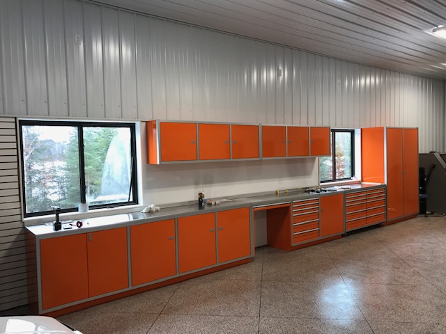

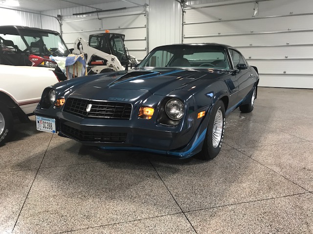

Heres some pics. I havent had an issue with the newer stuff as far as tires making marks or peeling. It was afresh concrete floor and they came in and bead blasted it with a machine. I have oil, trans fluid gas spilled and never an issue.
They did also put some sand in it to make it less slippery. If you go straight epoxy, you will end up on your back!!

Originally Posted by Jonesy View Post
Sikafloor was the brand. Same as Jakes.
Cost installed for me was around $4/sq ft. I also have a 60x72 garage. The grout lines also added to the cost.
Can't even buy the material in my area for $4/SF - that is a deal!
