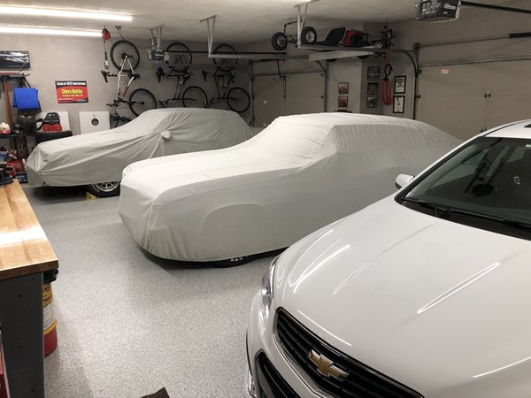

I work in the commercial construction business and chose to use a SikaFloor system based on recommendations from a vendor that I had 25 years of good experience with. It is a 3 step, seeded system. First day they come and grind the floor and install the base color and chips, second day an initial clear coat and more chips, 3rd day a final gloss clear coat.
Not inexpensive for sure, but very happy with the results and performance. I did not want to mess with the home store do it yourself kits that start to fail after 10 years or so. Very impact resistant with floor jacks, jackstands, dropped impact sockets (just used them last night), highly resistant to everything I have put on it so far (melting salt water from cars, oil, grease, gasoline, mineral spirits, etc.)

I did the same thing in my garage as Jake did above with the color flakes and epoxy.
Its industrial use flooring. I had this in my old garage I built in 2006. Never any issues.
They can run it up the wall 6 inches which acts as a base.
Sikafloor was the brand. Same as Jakes.
Cost installed for me was around $4/sq ft. I also have a 60x72 garage. The grout lines also added to the cost.

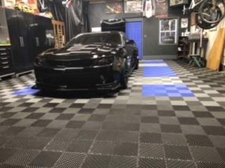

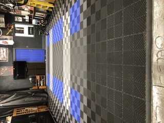

In my older barn As mentioned I use race deck. Put down some black felt to keep the noise down and just snap that stuff in place awesome I’ll attach a picture
