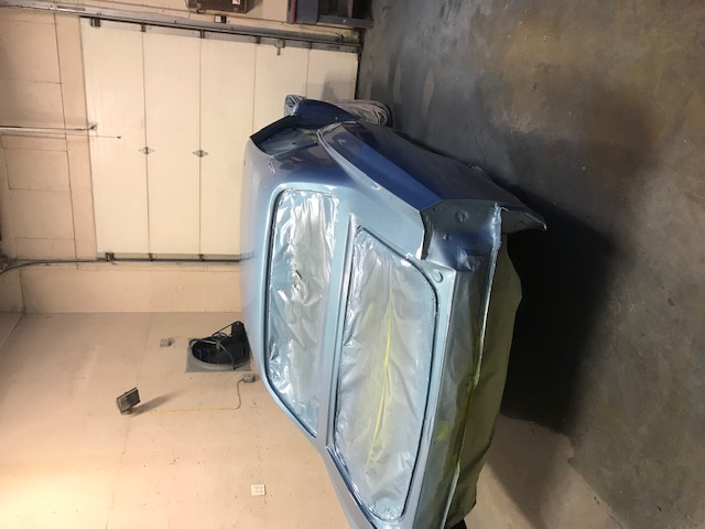

The painting process has started! ASTRO BLUE!

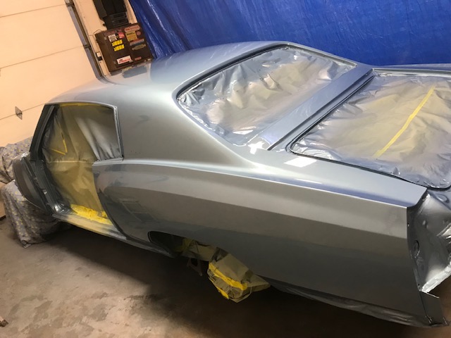

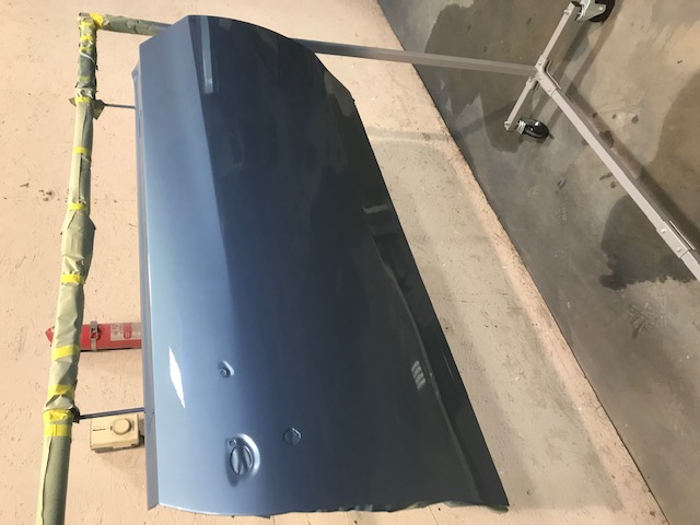

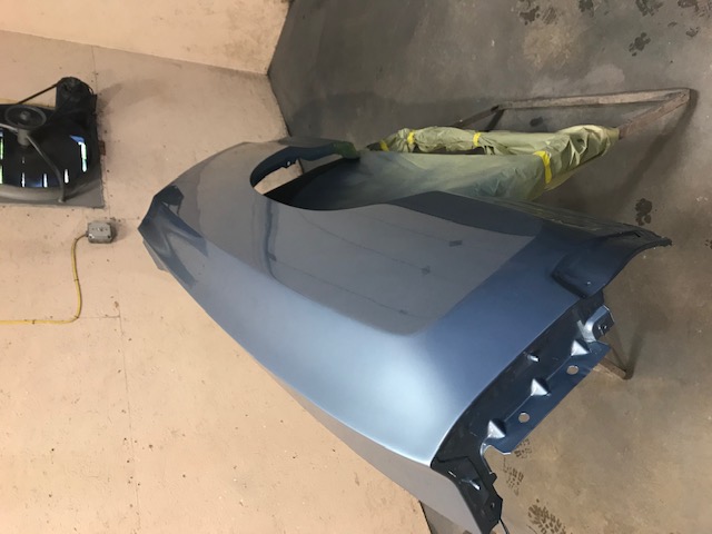

Body painted! I stretched my arms 2" to reach the center of the roof. Some big panels on this car. Used just about 1 1/2 gallons of base color and a little over a gallon of clear to cover all the panels.

What happened? It was hunting season LOL. I really don't work on my side work from October to Mid December. I actually just finished up wet sanding and buffing the body today. The motor is at the machine shop. The bumpers were delivered to the chrome shop. Time to start reassembling the door class and quarter glass power regulators. Waiting on the motor and six speed before I install the front sheet metal.
