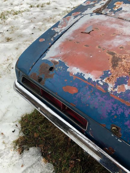

Photo 1: Gutter
Photo 2: The holes for a wing. This car is an X44, so it shouldn't have a wing, but the HH is pictured as having one, so the holes don't disprove it being the HH. Also in this pic, rumor has it that after its racing days were over, it was painted blue. As seen, that is the color of this vehicle even though the cowl clearly states it was a 10/10.
Photo 3: From what we've gathered, the HH was an automatic. This is clearly an automatic slapstick.

There are a series of photo's floating on the innerweb that show the creation of the HH, that might help - I just can't find them!
Holes for a wing, don't mean a thing! Goodness, half the Camaro's out there have holes for a wing, neither does an a/t in a 4 hitter car, or blue paint. This is not a 'process of elimination' exercise when Frankie had the original title and VIN, which I don't think matches yours....

The pictures of HH clearly show it had style trim. Frankie's car was X11 and had style trim.
Yours is X44 - no trim from the factory and no trim now. Not an easy detail to add AND then remove.
Can't see how your car could be HH.
Especially when the original owner of HH provides the VIN and it's 9N616462.

Yea, I'd probably shift focus away from trying to determine if your car is the HH, and put all your energy on determining if its a COPO.....
The HH story is better left with the current seller in NY.
