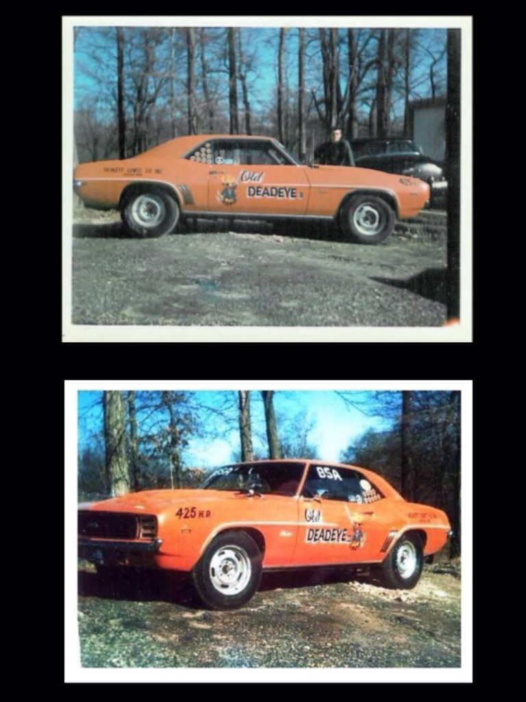

Is your car 9N665177 originally raced as Old Deadeye?

Yes it was Old Dead Eye I am restoring it to factory the car is very solid I had to replace quarter panels due to them cutting them for rear tires I am replacing with Factory whole quarters only 1 rust spot on car were the battery asid eat though a corner of front fender.

When located in 2003, N665177 did not have its original engine.

Such a nice car in it's racing trim. Too bad you're "restoring" it. Your car, your choice of course.

I believe Mike Kaiser had that car for sale some time ago. When he sold it, I seem to recall it was going back to a previous owner. Is that you?
Luv that car!! I’ll second Dave about leaving it unrestored, but hey... we all had a chance to buy it and do that.
