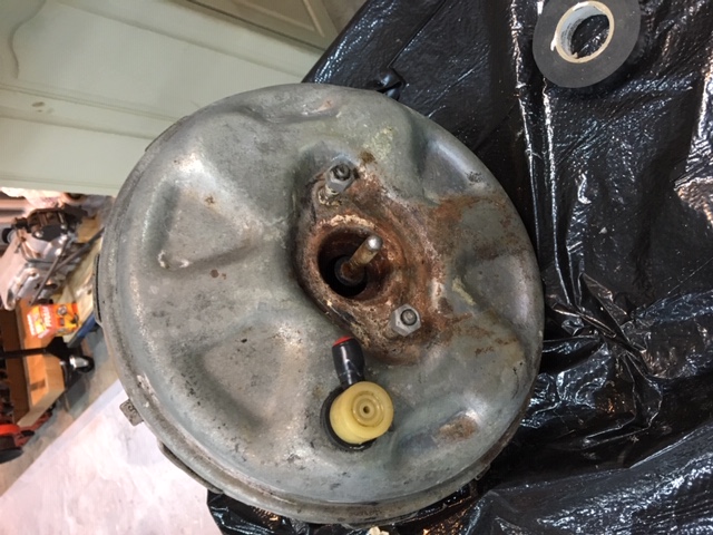

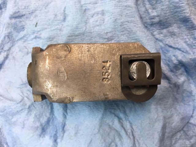

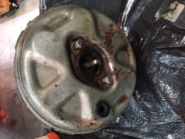

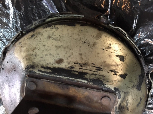

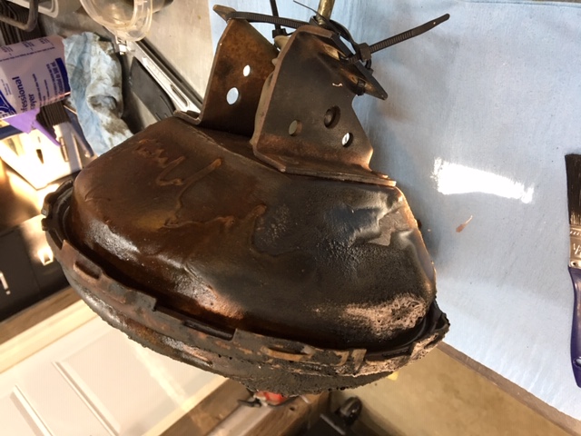

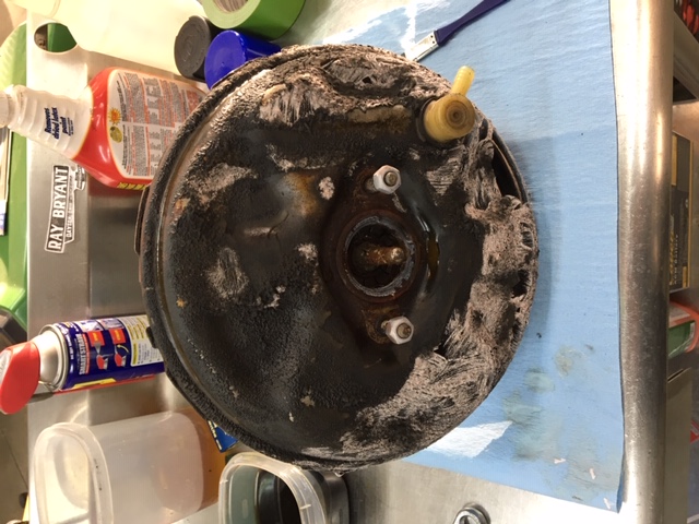

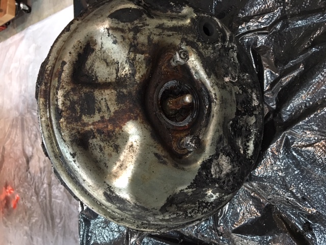

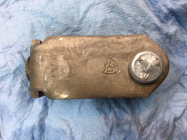

Worked on my original 9204 brake booster this week. Goal was to get it ready to ship out for re-plating. Of course it had a large amount of the gloss black paint on it so I went to town on it with some citrus stripper. It took 3 or 4 cycles of stripper and scraping with a plastic putty knife but it all came off exposing the original plating. Included a pic of the pedal connector and RBW pin as it also looks to be the original unit.

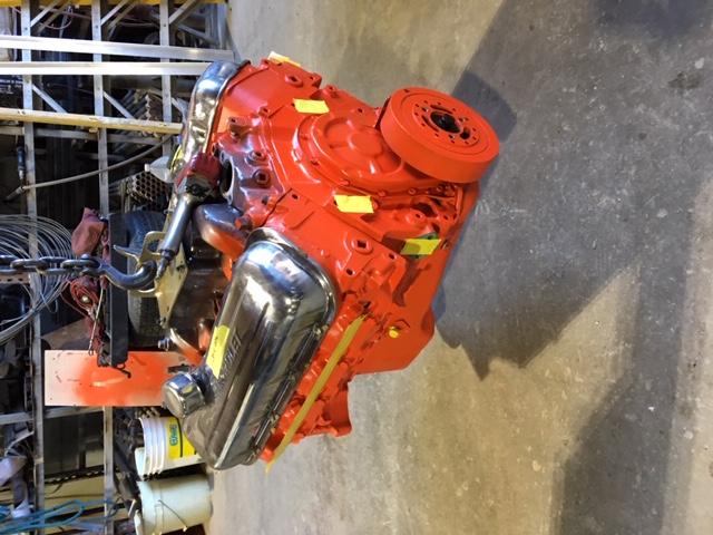

I found a correctly dated 512 4 bolt main block and a matching set of 291 casting heads. Block is dated Sept. 8, 1969 and the heads are Sept. 11, 1969 so about 2 weeks before the build date of the car. The long block is built to stock spec.s with all the correct internals and was broke in on a stand. It will be a while before it lands in the subframe.

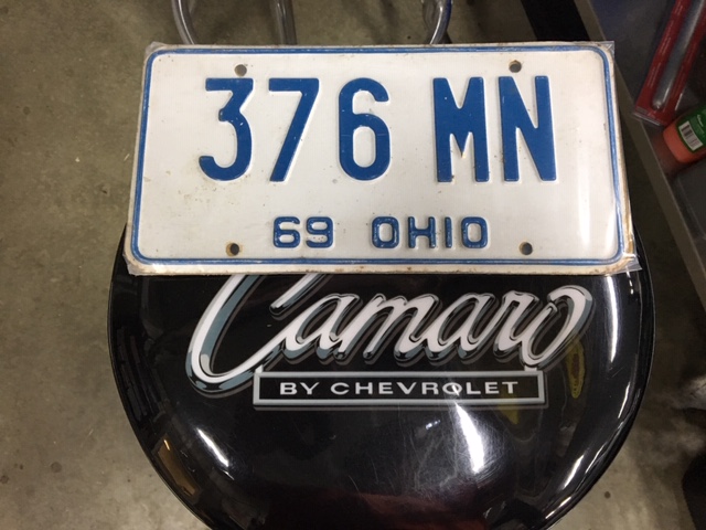

Picked up a set of 1969 license plates at the swap meet, thought the MN suffix was appropriate

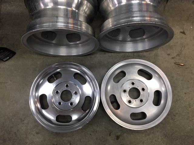

Spent some time today working on my 3.5" Fenton Gyros that will end up on the car. They're in pretty good shape with just a couple of nicks on wheel. I have more polishing to do, but am pleased with how it's coming out
