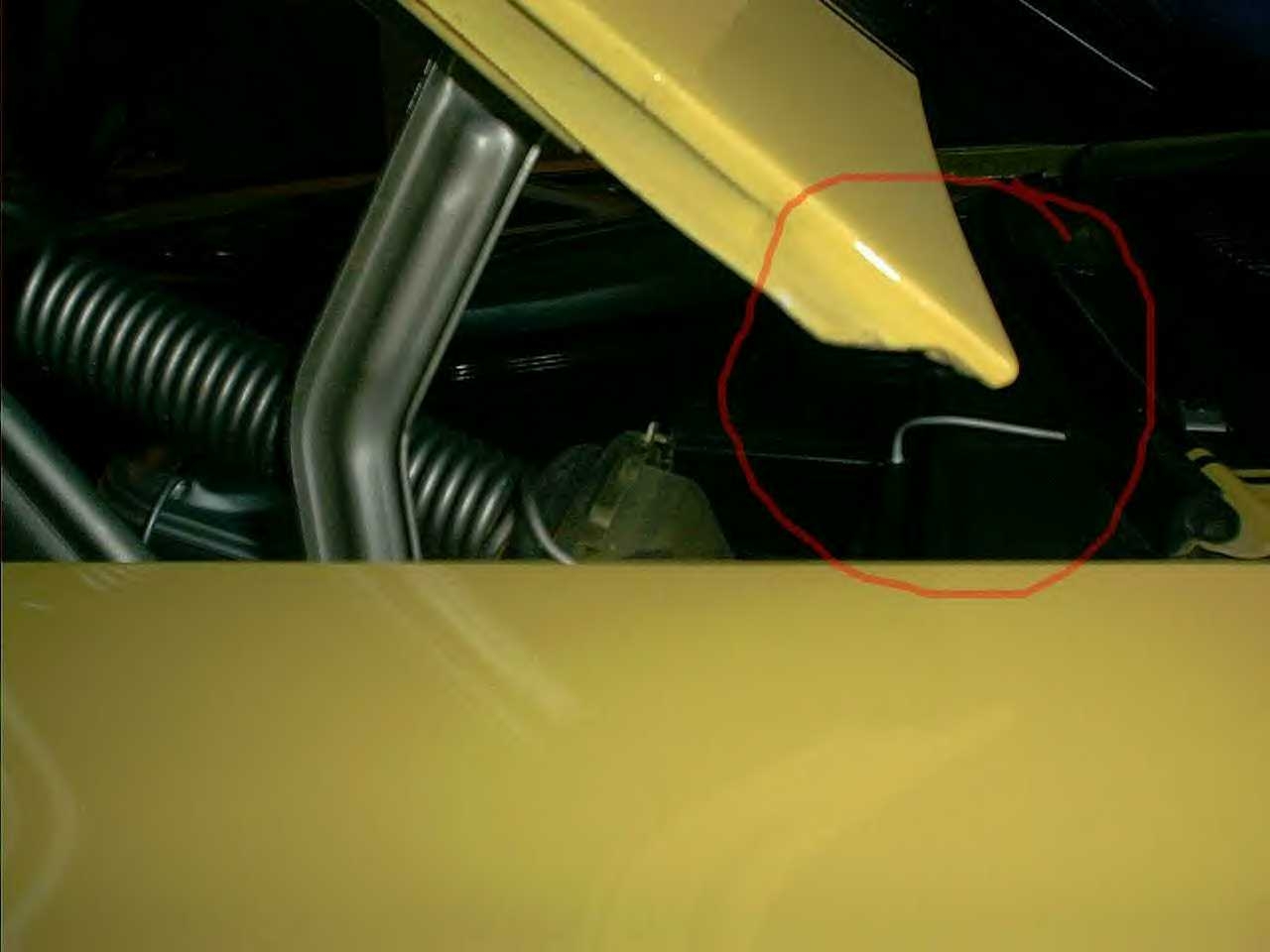

I've got a '69 Camaro hood in my shop that may or may not be a GM hood. I did a search, but the pictures are gone in the old threads. How can I tell the difference between a GM and a reproduction cowl induction hood?

Easiest way to tell is look at the side edge at rear of hood , repo hoods end in a small approximately 45 degree angle. GM hoods have a small notch out of the 45 degree angle. Production line installed hoods also have a week production code stamped in the drivers side at the rear by notch. Hope that helps somewhat

Default Hood
Hood GM.
"Knowledge is good" Emil Fabor

Default Hood repop
Hood Repop

Now I understand. Thanks for the pictures.

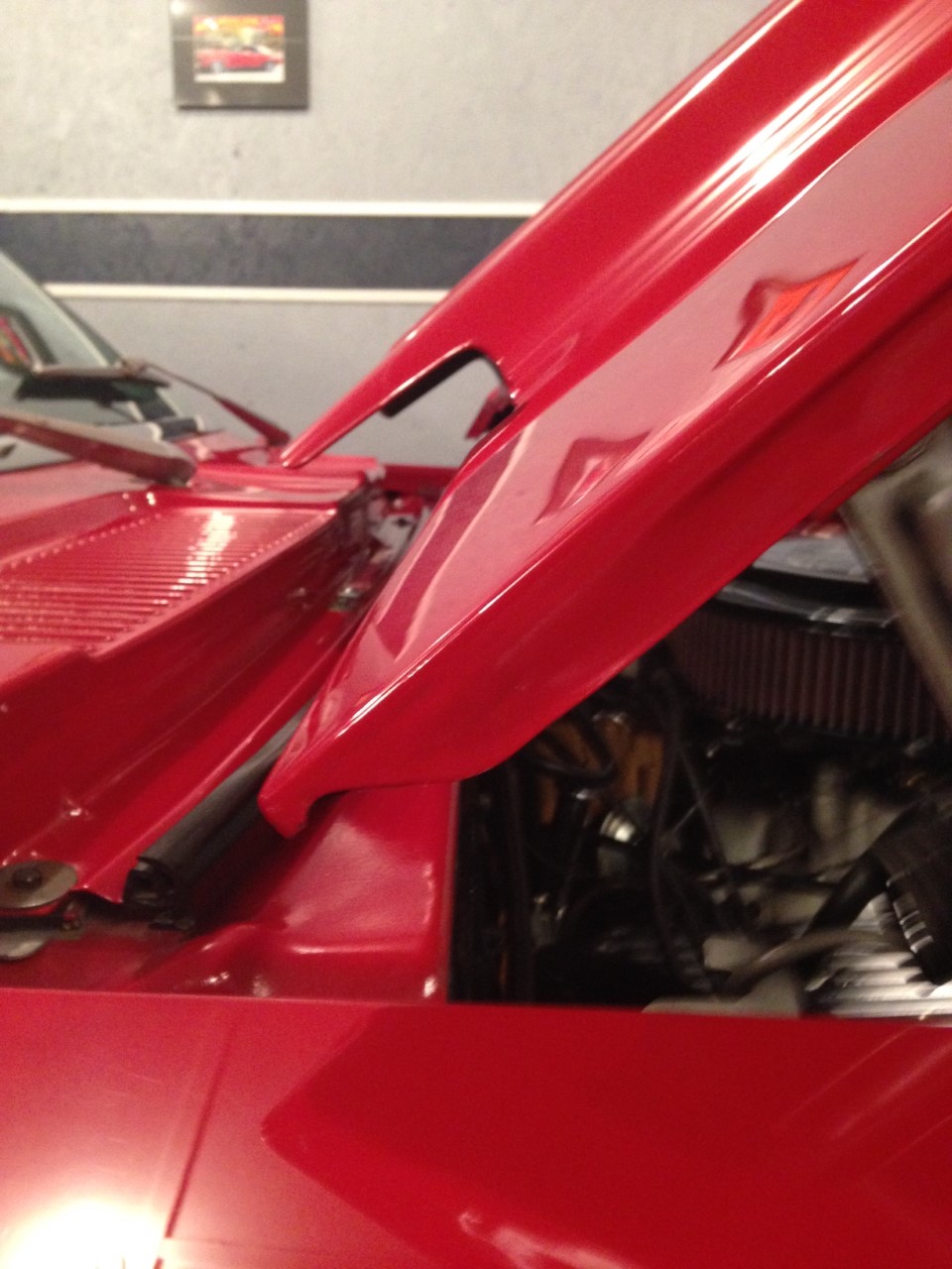

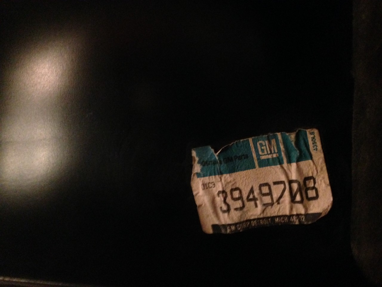

A couple pics of my 69 hood with the GM sticker intact.
